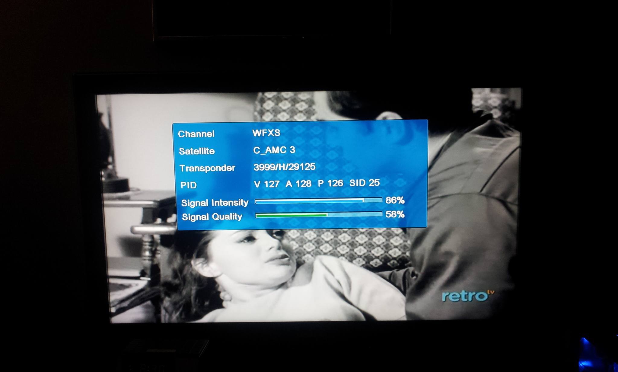

Lately i have been watching RTV on 87w cband freq 4000 with my 6 footer.The problem is on that mux i get around a 3rd of the channels and the rest no sig showing scrambled.I know that those channels are not scrambled from other reports here and my solomend sometimes will show a channel scrambled when its not.My question here is why dont all the channels come in when the Q and sig strength is the same on all the channels.:confused:

Why some show as $ is a good "Q". Got no clue. Guess says weak signal, but only some streams in the mux makes no sense:confused:
I know my S9 blind scan will now and then say 'no channels found' when I know they are there. Scanning the TP will usually get them. (thinking while I type) Have you done a Transponder scan?
Thanks FAT:) I just did a rescan of the TP and now im getting all the channels. Its abit weird on getting this tp!many times when i first turn on the receiver theres a 10% Q then i move the dish a few clicks right or left then boom the sig comes in fine. Heres a pic 20130506_202943.jpg
