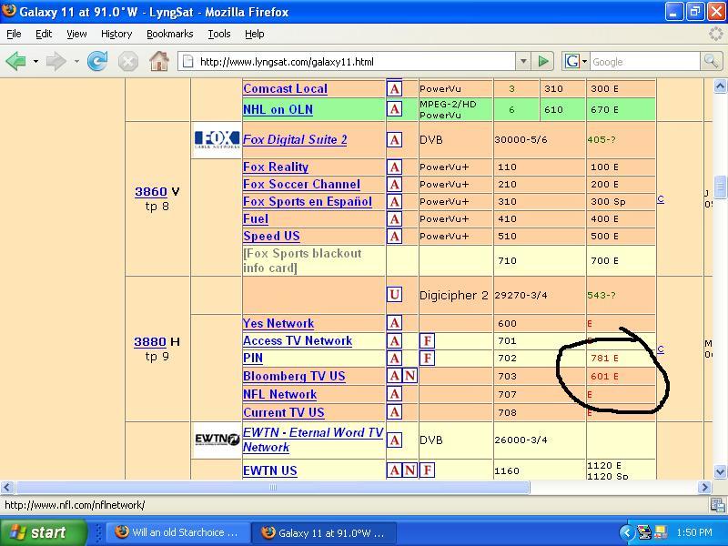

On Lyngsat if there is a 4DTV channel available, it will be in red by the audio pid.
If you can see 91W try there. There are 2 channel free on one of the TP's...Bloomberg & Access TV Network
3880
H
29270
so that would be 5150-3880=1270 IF frequency
(see attached screenshot for what I mean with the channel number)
