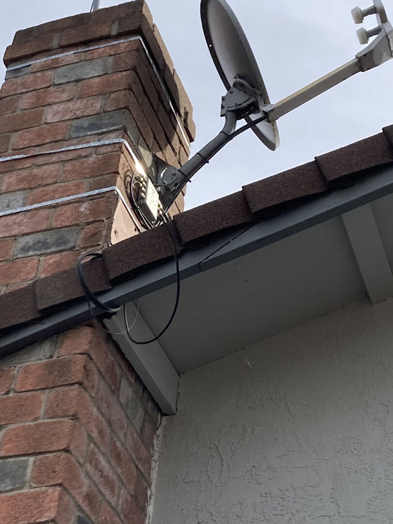

Roof being replaced and would prefer to do a under eave mount on my brick wall instead of punching holes in a new roof.
Considered a ground pole mount but decided it was too complicated to move dish where that would need to be done.
So, would this work, even though it's for DirecTV or does DishTV sell something equivalent?
That looks just like the mount my Direct TV guy installed on my home.

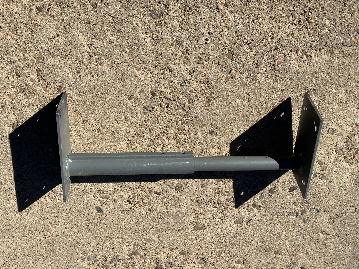

Dish uses 1 5/8" and directv is 2". You can technically stretch out the back of the dish and make it fit. I don't care for that method though. Dish does have a mount that has a telescoping end but not sure if they still make them. I have on my on my truck that I got from another house and other than that I've only ever seen two other ones in 11 years of being a tech. I did a super quick Google search and didn't find any but I'll take a picture in a little bit.
Here's what it looks like.
