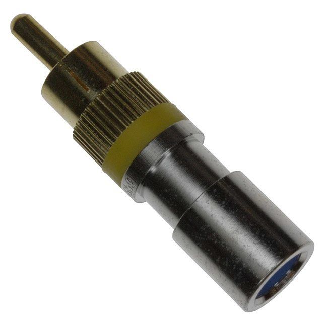

Running component to remote TVs isn't hard you just need a lot of coax and 10 RCA stile coax fittings.
