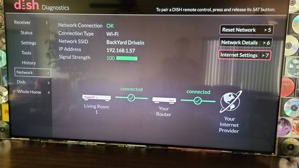

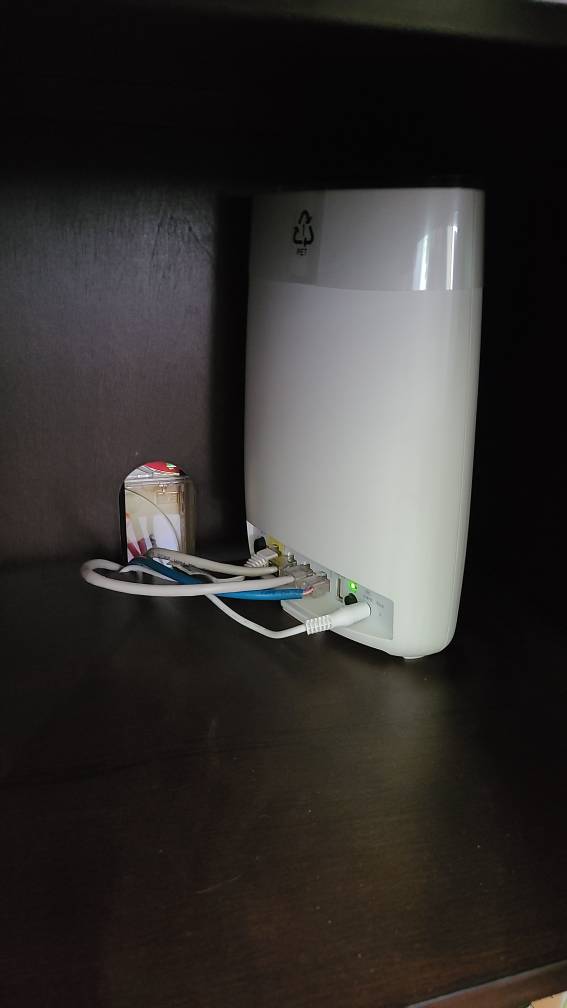

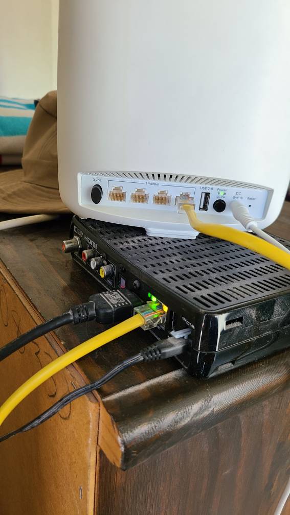

A) H3 connected cat5 to orbi main
B) J2 connected cat5 to orbi sat, no MoCA (rg6)
C) 2nd trial, H3 WIFI to orbi main, no cat5
