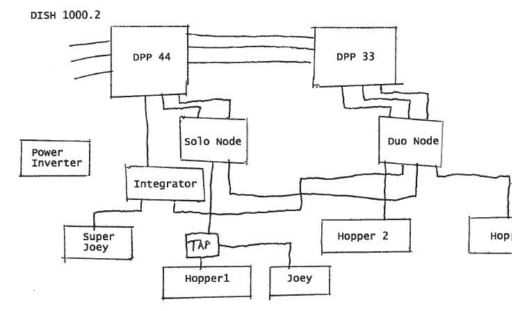

Any reason why something like this wouldn't work?
Yes because Dish doesn't allow Super Joeys in systems with more than one Hopper. No ifs ands or buts.
I get that. But supposing (hypothetically) that I self install and the additional hopper is on a different account. Anyone see any issue with the wiring? Would it theoretically work?
The super Joey marries its two tuners to the only hopper in a supported system. There is no logic for choosing which hopper to integrate with so it is unsupported. Doubtful it will work.

Exactly. I had 2 Hoppers (2 accounts) and a SJ on one dish/node system and the SJ was very confused. :)
