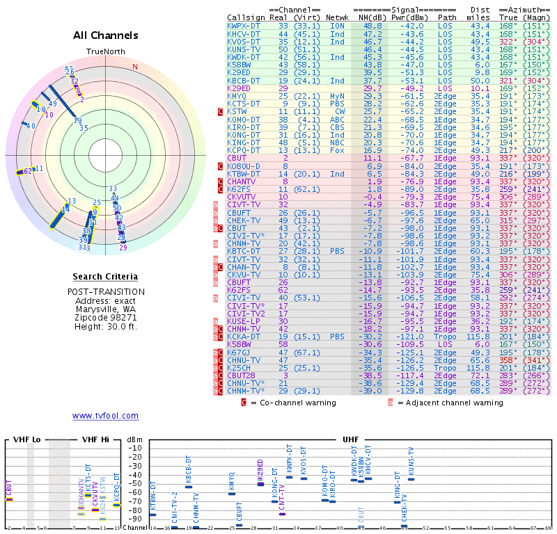

Attached is my TVFool Information on Distance and Direction.

Check out channel master 3671 antenna and a channel master 7777 pre amp. Use the best RG-6 cable you can find and get the best compression type connectors you can get also. I would never use "twist-on" type. This antenna and amp would work well for all potential channels 2-51.

Have you tried the existing setup? Seattle is in the range of 40 mi. south of you well within the Radio Shack range. Yes their antennas are over rated but you may already have all that you need.

I agree with Jim. If trapping FM doesn't help; I would try a better pre-amp like the CM 7777. The VU-190 should provide adequate performance with most everything down into the red zone of your TV FOOL report.
