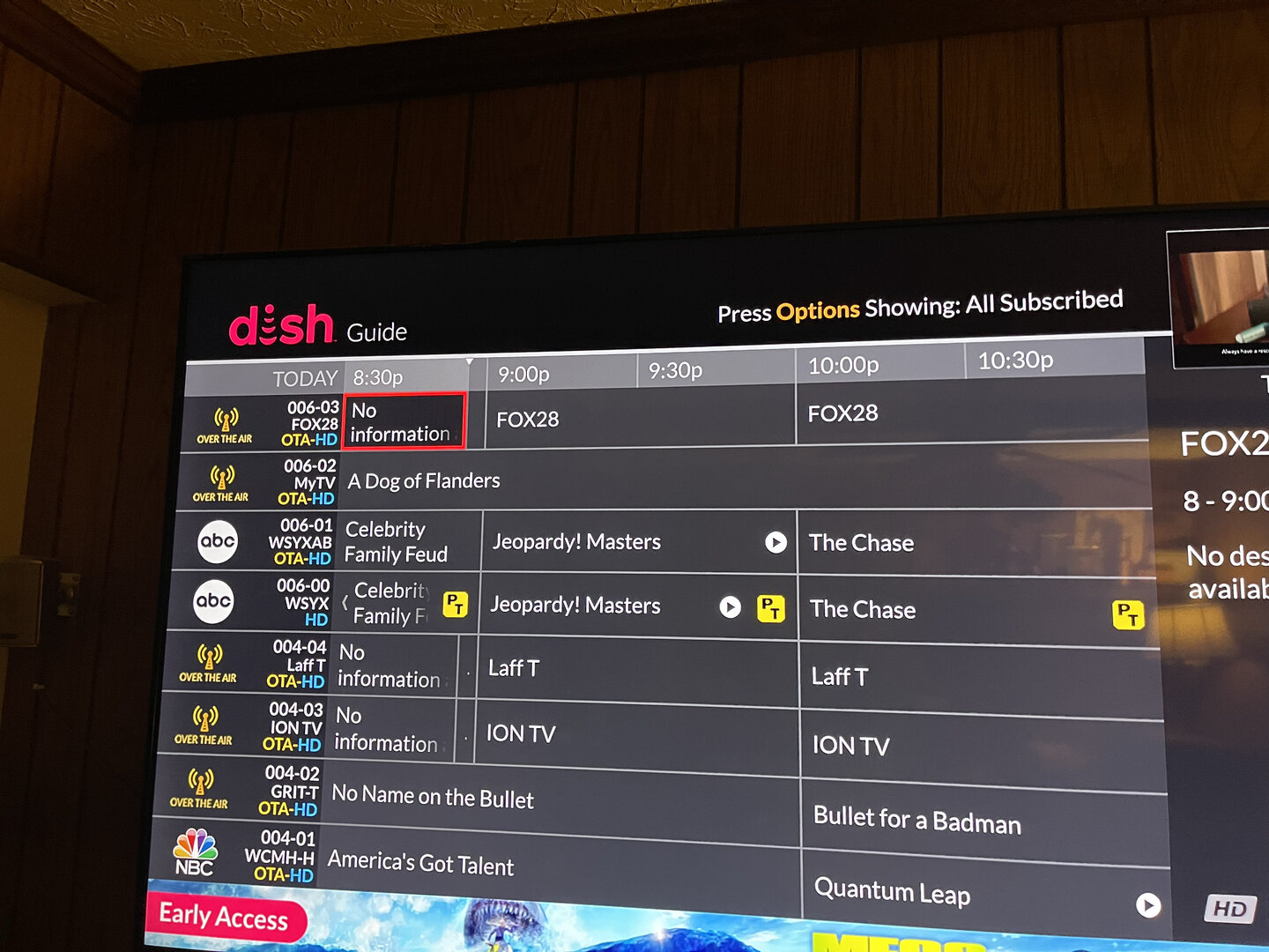

Josh,
I have 2 Hopper3 receivers and a Joey3 client.
Family Room Hopper3
Living Room Hopper3
In January 2021 FOX broadcast channel changed from 28.1 to 6.3 due to the ATSC 3.0 broadcast change in Columbus, Ohio.
So channel 6.3 now carries Fox 28 and channel 28.1 is not Fox but TMD.
