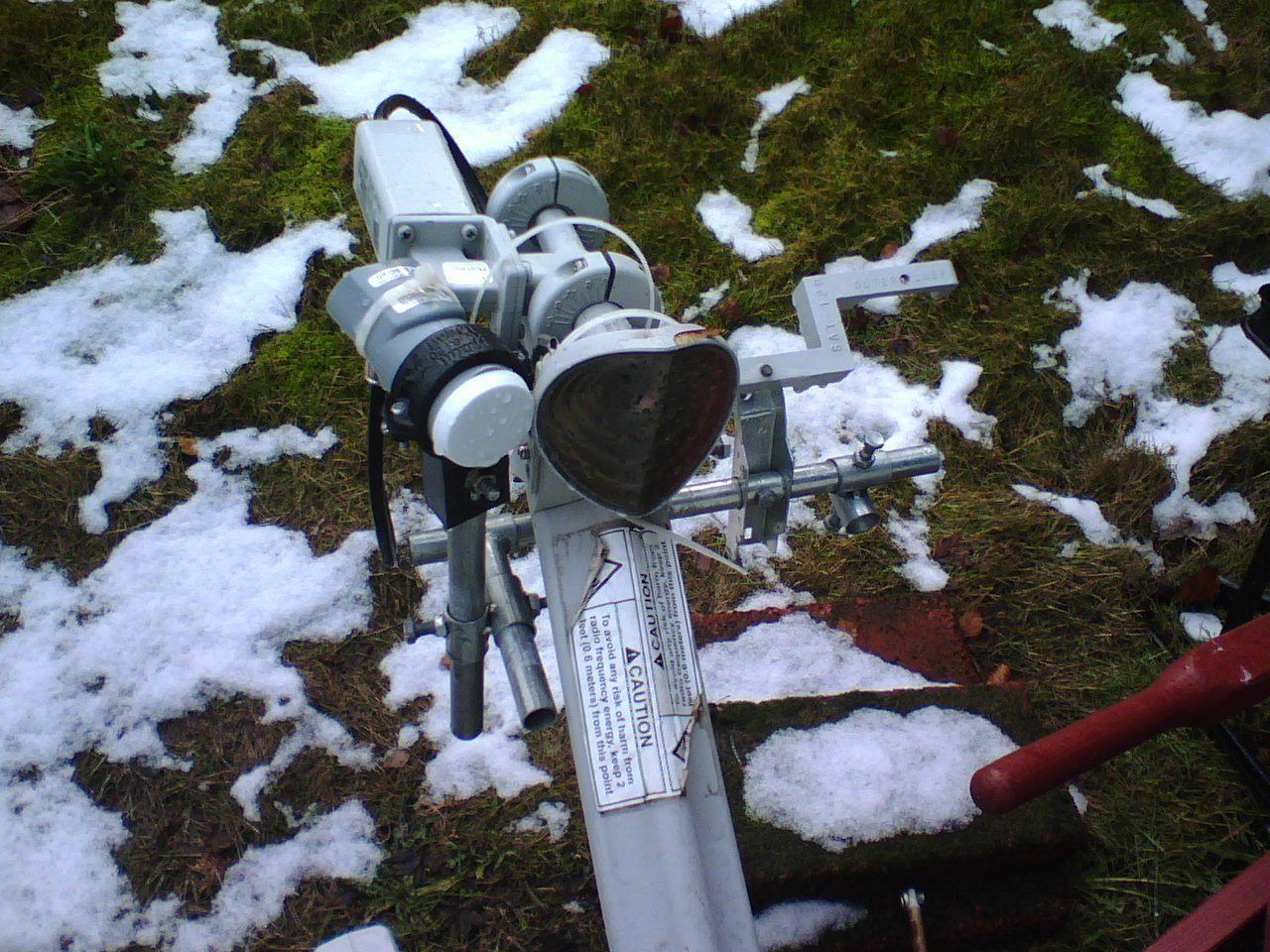

I could get 119/123/129 using a Geosatpro bullet LNBF.
However 119 suffered as it usually was out of focus.
In the picture attached, 119 is missing but it was on the right of the large feed horn jammed tightly.
I can't seem to find any pictures of my 129/123/119 setup.
