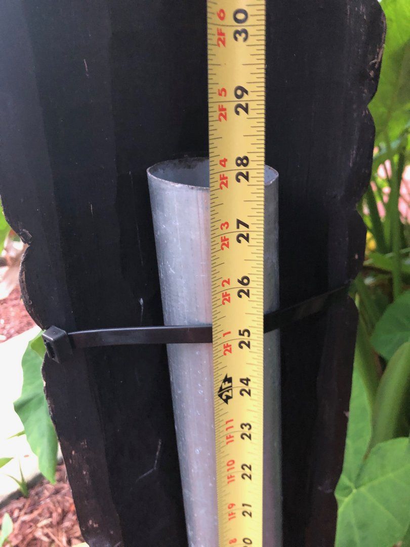

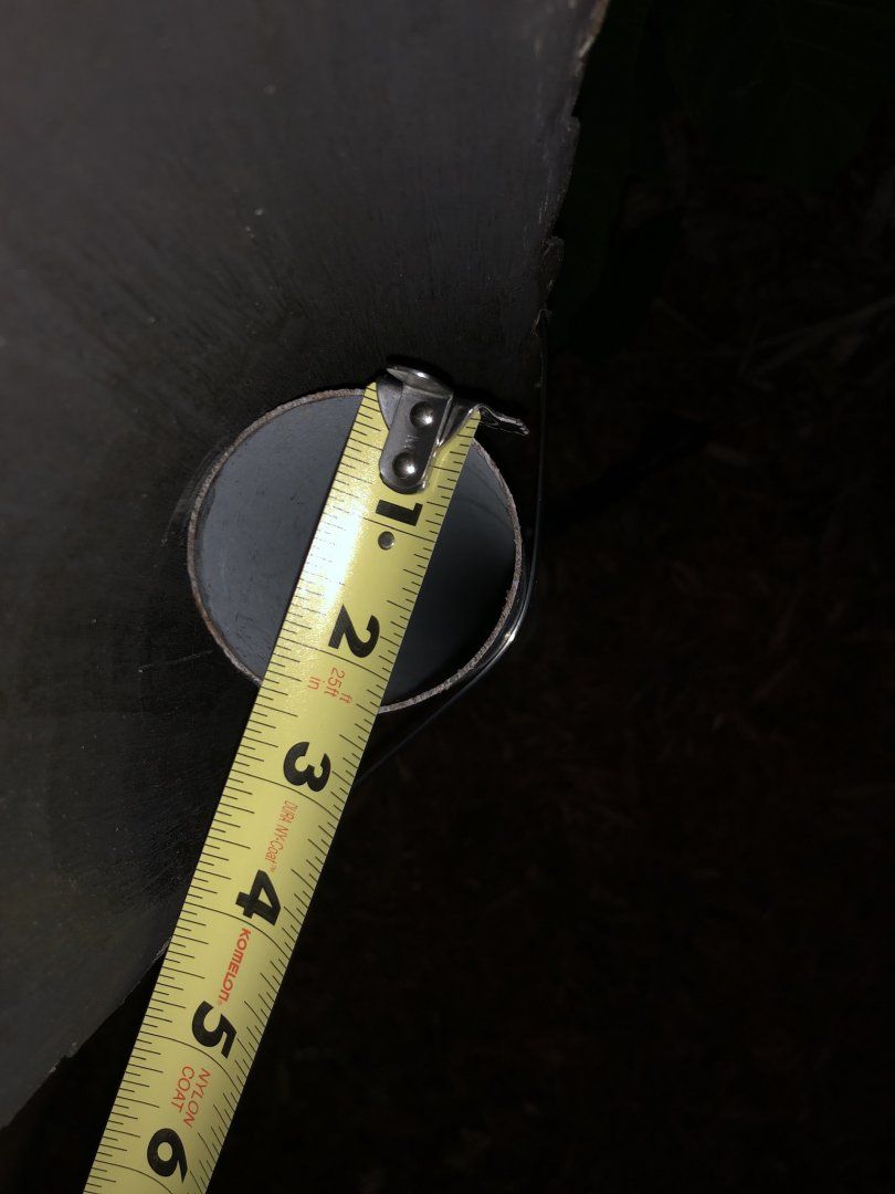

I have a pole in the yard already that a superdish used to reside on. Will the 1.2 fit on this pole? See attached...

I believe it's a 2" schedule 40 type pipe you want. It's bigger than the size 100cm and smaller use (1 7/8?). Think the OD is 2 3/8". According to your picture you should be good to go.

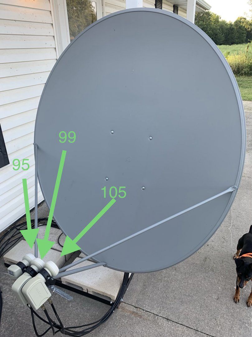

Agreed; love my GeoSat 1.2m. Big enough for offset LNB's, too. My dish is focused on 99 with offsets on 95 and 103. Signal levels on the offset 103 are higher than on a dedicated 90cm!

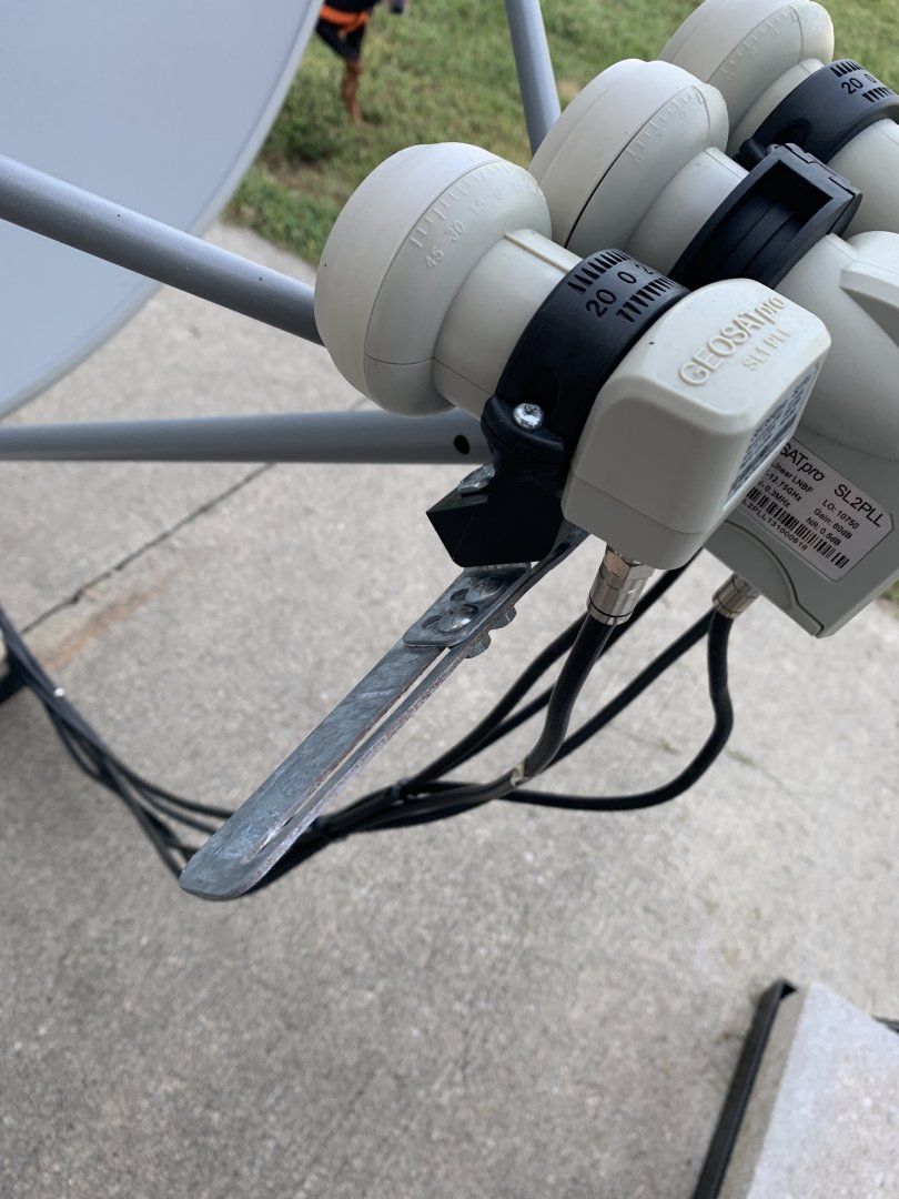

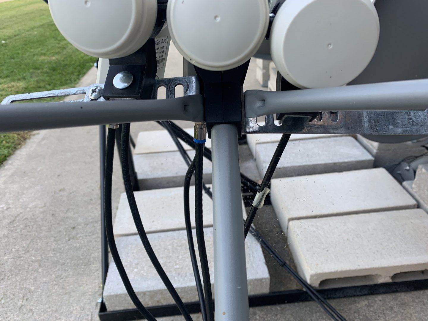

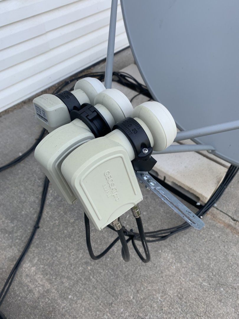

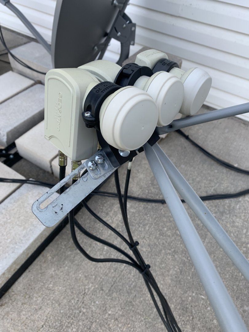

Hey man, some time when you have a chance I'd like to see a photo with closer detail of how you did your multi-lnb setup please.
There's a kit you can buy from Hypermegasat on Ebay that works with the GeoSat dishes and allows easy offset of LNB's.

Thanks for the info. Ive done this a few times. I just didn't want to do this because the pole was already there and it previously was home to a superdish. I cut it down a while back to mount a charcoal grill there but ended up buying a full size gas grill. Im going to give it a go and if its unmanageably low I'll replace the pole in a better location.
