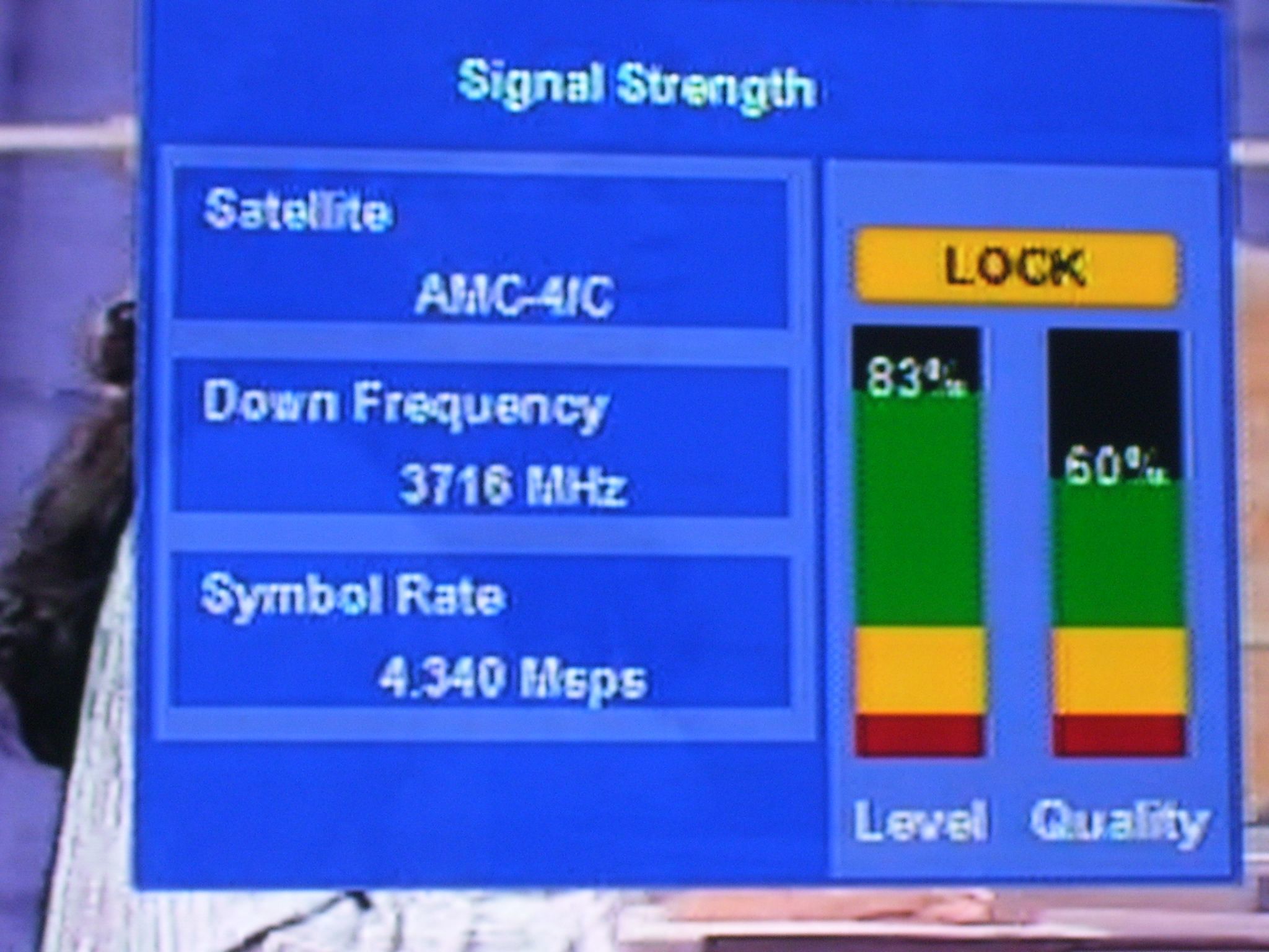

The only channel on 101 C-Band that I know of is Golden Eagles Broadcasting
That transponder is very strong so a 1.2m should be fine.
edit: found the signal screen shot when I locked on GEB with a 1.2m dish
