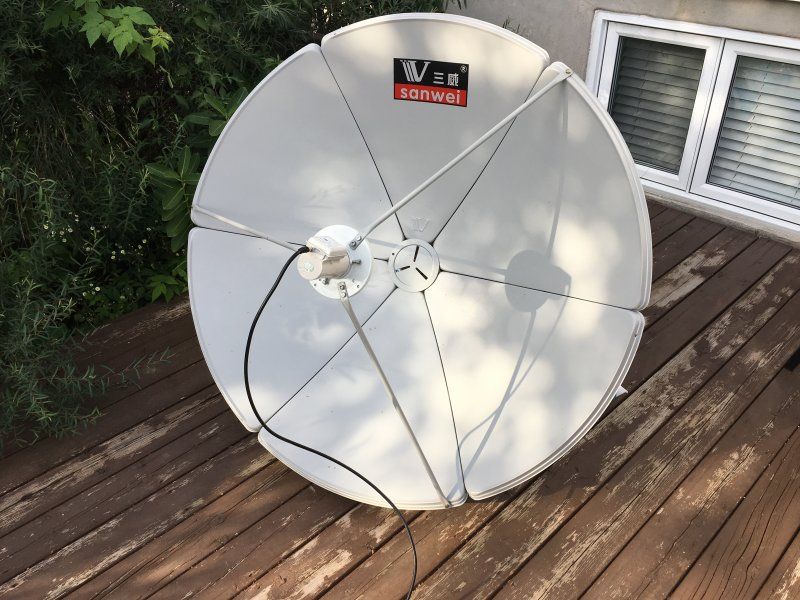

Well i gave it a try and it's not so bad! I got a few c band channels but not much. It performed just like my 4ft geosatpro with a conical scalar ring. Except this one you have to use a flat scalar. 91w byu is definately the strongest signal i could pick up. Haven't tried it on ku yet. I wish i got a 6 footer but they are expensive. This was 140$ cad shipped from hong kong and it arrived in 4 days! 30$ for customs, but that's not bad.

Don't even bother with the 6ft dish. Minimum you should even consider is a 7.5 or 8 footer. With DVB-S2 and higher, you need all the help you can get. Plus, the larger the dish the tighter the beam so it doesn't get interference from another sat next to the one you are aimed at.
All that said, try 99w on this 4ft dish. Maybe even a Titanium PLL LNBF.

Well after playing with this dish for a few weeks now, the most interesting channel i picked up is byu on 91w. It has the strongest signal and most stable too. Sometimes i get cw but i need more then 50% on my sathero to be able to watch it. I was also able to get the lesea mux on 99w but it was barely stable at 38-39%. 97w i got the azteca mux, amg, the walk, latv. 101 i could get decades. 107w i got the weather network. 125w tbn. Any other sats i should try?

you might be able to get some channels on 58W and 55.5W, Also maybe HipTV on 37W. And the Saskatchewan mux on 111W
also if you insert a dielectric plate you might be able to get some stuff on 47.5W and 40.5W
I was able to pick up nhk on 58w, barely at 37-38% but the picture was stable.
couldn't get the mux on 111w.
What frequency should i try on 121?

etlam34, could you please take more pictures of the dish. I'm thinking of buying one of eBay for Ku. Did you test Ku on this dish yet?

The Lesea mux on 99w booms in here with a 97/94 signal level. If you're only getting a 38/39 on it, you'll be lucky to get anything else on that satellite. It's surprising that you got Decades. I have it coming in on a 7.5 foot dish, along with MeTV, Movies and a few others, and they're not burning the world up as far as signal. Did the Grit MUX scan in on 97W? On 2 of my receivers, I had to add the transponder and scan it in to get it.
You may want to try it. Those have a pretty good signal level on them. :) Those are definitely worth the effort.

Couldn't the grit mux on 97w either.
Anyone has a strong frequency i could try on 121w?
Looking at the footprint it seems to be pretty strong!
No results for 121w. I managed to get 20% on ewtn dvbs2 , but only 10% on dvbs tp. So no lock (no luck either) for 133w. I've taken out the titanium lnb and parked the 4 footer back on 91w for cw and byu.
