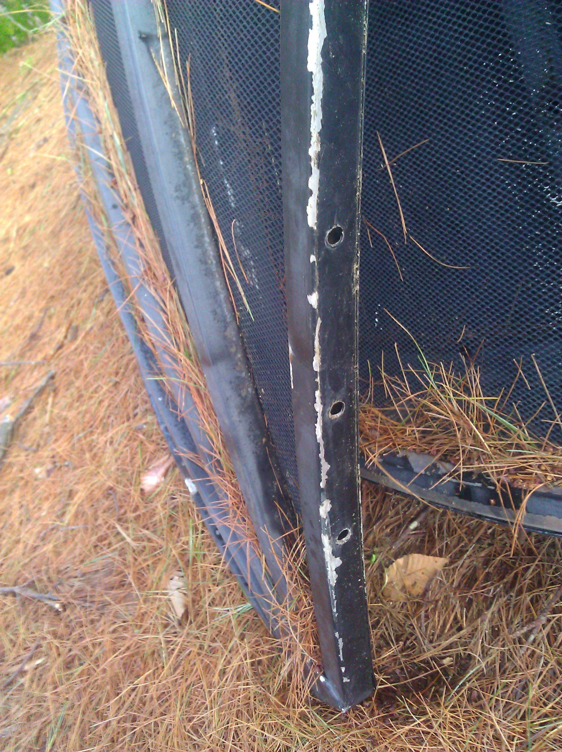

If it's Unimesh, it'll have a label saying so on the back of at least one of the sections. Yes, it is possible to adapt a polar mount from another dish. Or, even to make a fixed mount using angle-iron if you are a little handy.
Its hard to say without seeing it but You may be able to use a mount from a smaller dish. Many of those mesh dishes used a 24" diameter polar mount mount for ten foot and smaller. MY unimesh has the 24" mount with four small channels welded to the ring. The ribs of the dish (where the sections bolt together) fit in the channels and are bolted through.

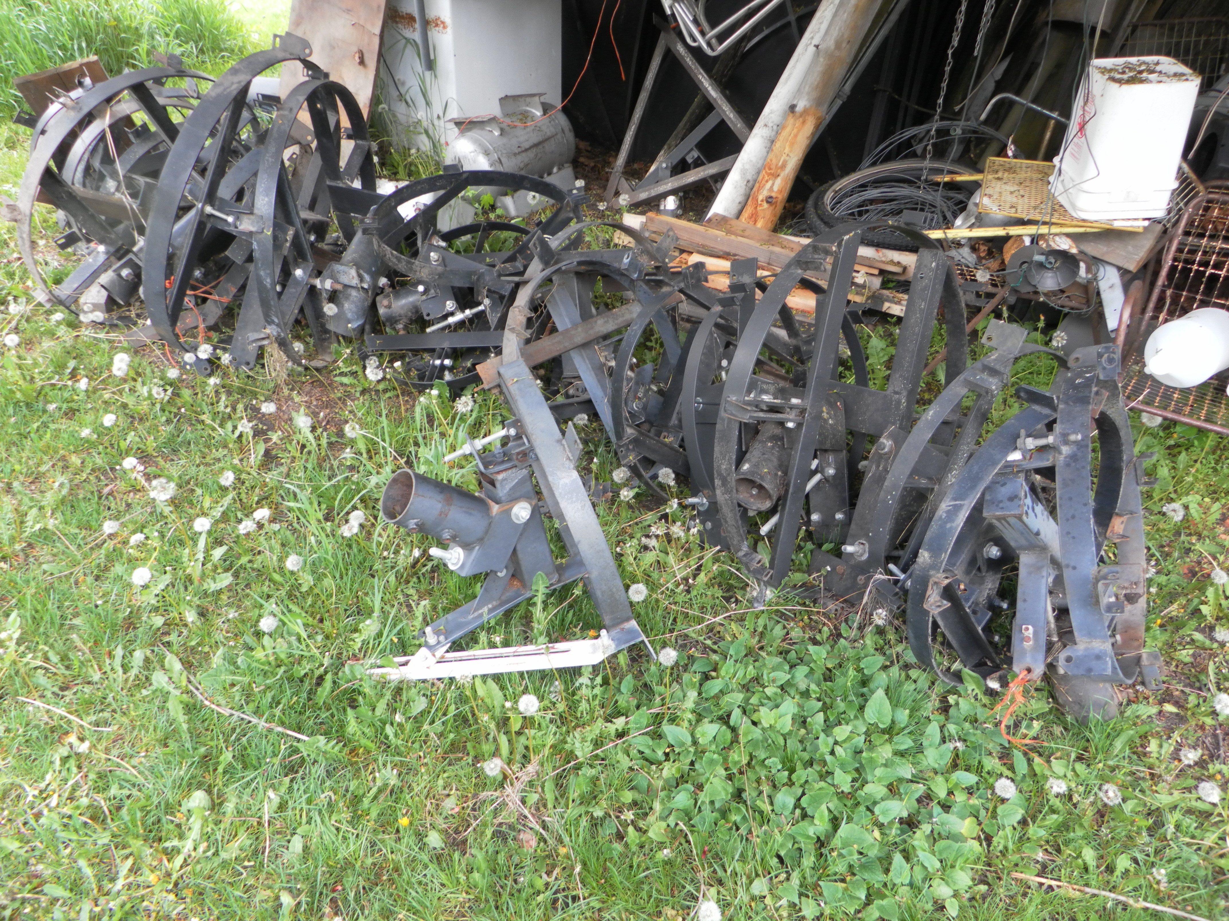

I took some pictures of the sections so hopefully someone can identify it by comparing it to their's. I compared it to my SAMI and Unimesh and it doesn't look related. Note the welded rectangles over the end of the mesh in one picture.

That looks like a "Perfect 10" dish. I have one just like it that I am taking down. Too bad you're not near Atlanta I would give you the mount you need - free.
And if you were in the NorthWest I would set you up with a mount.

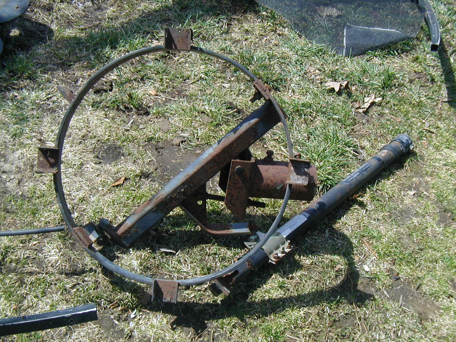

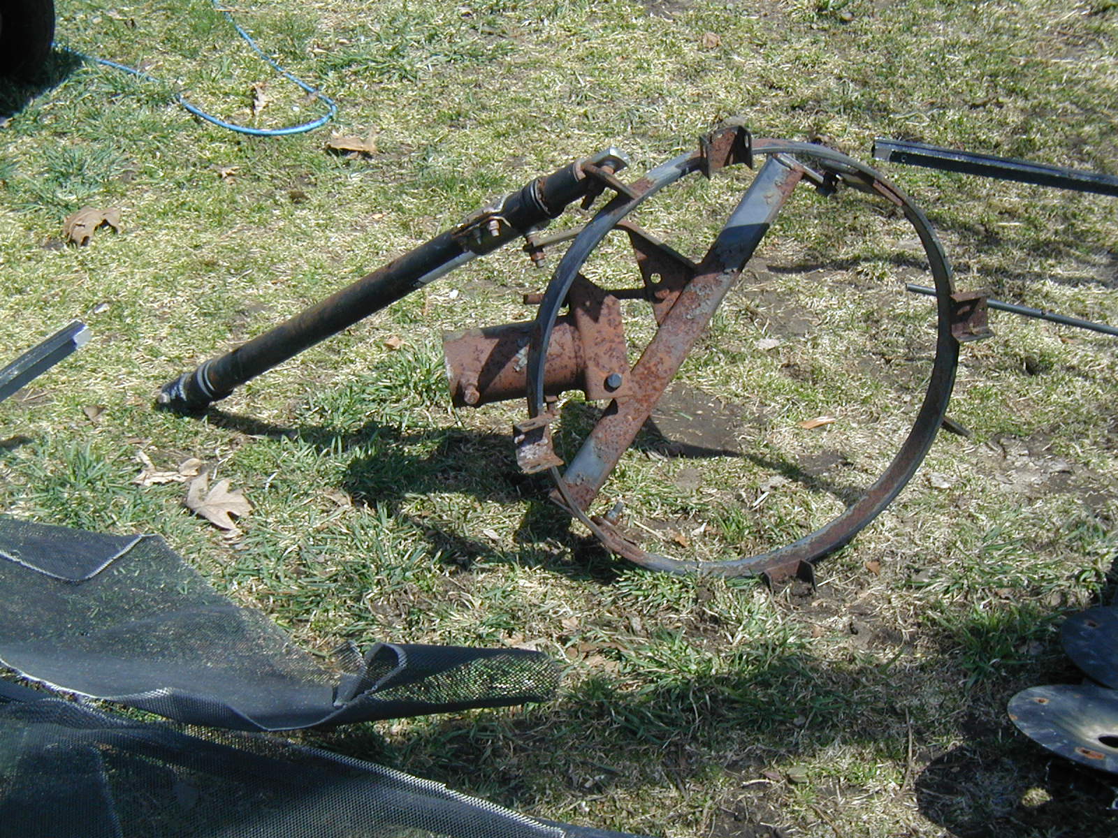

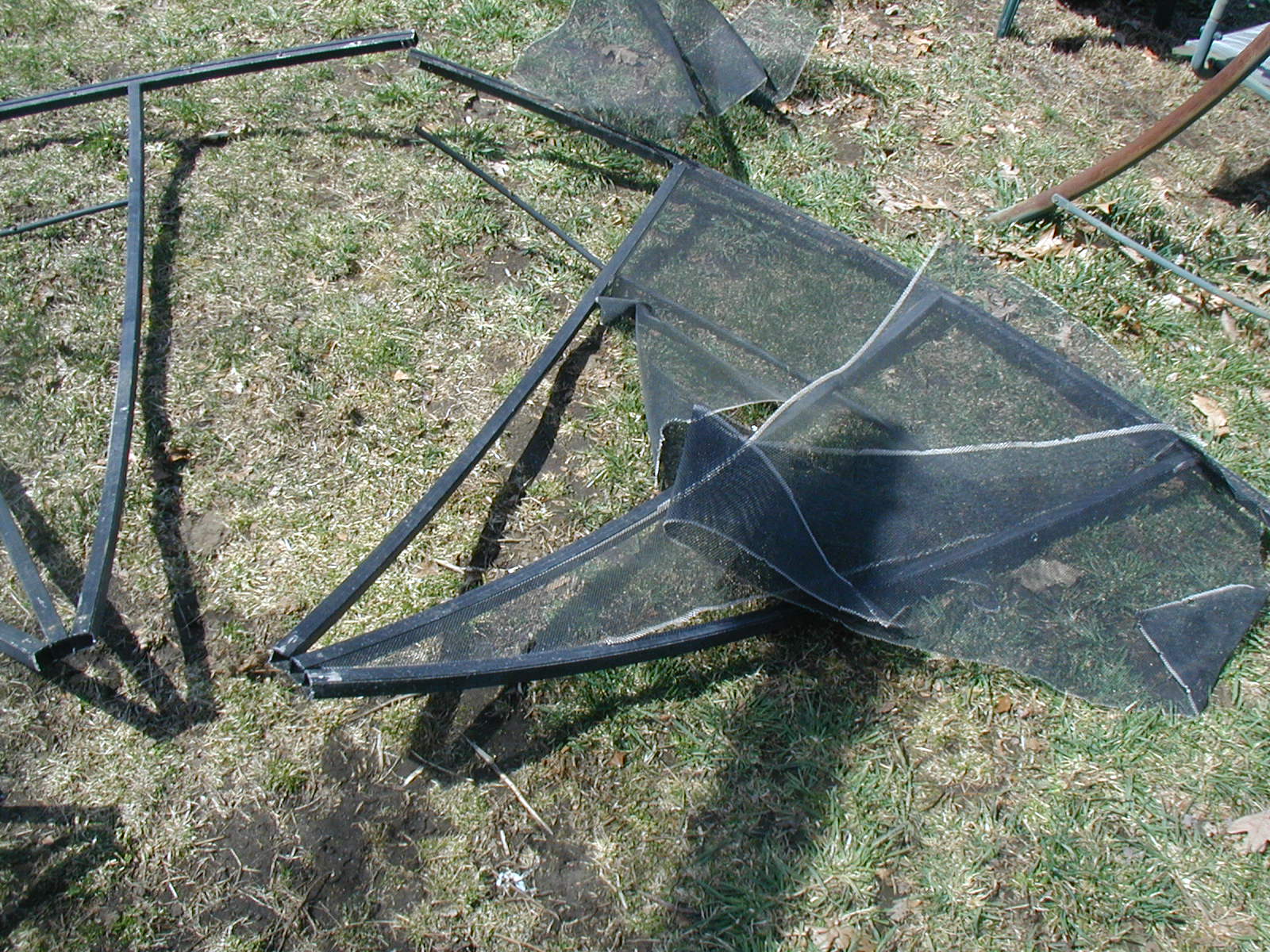

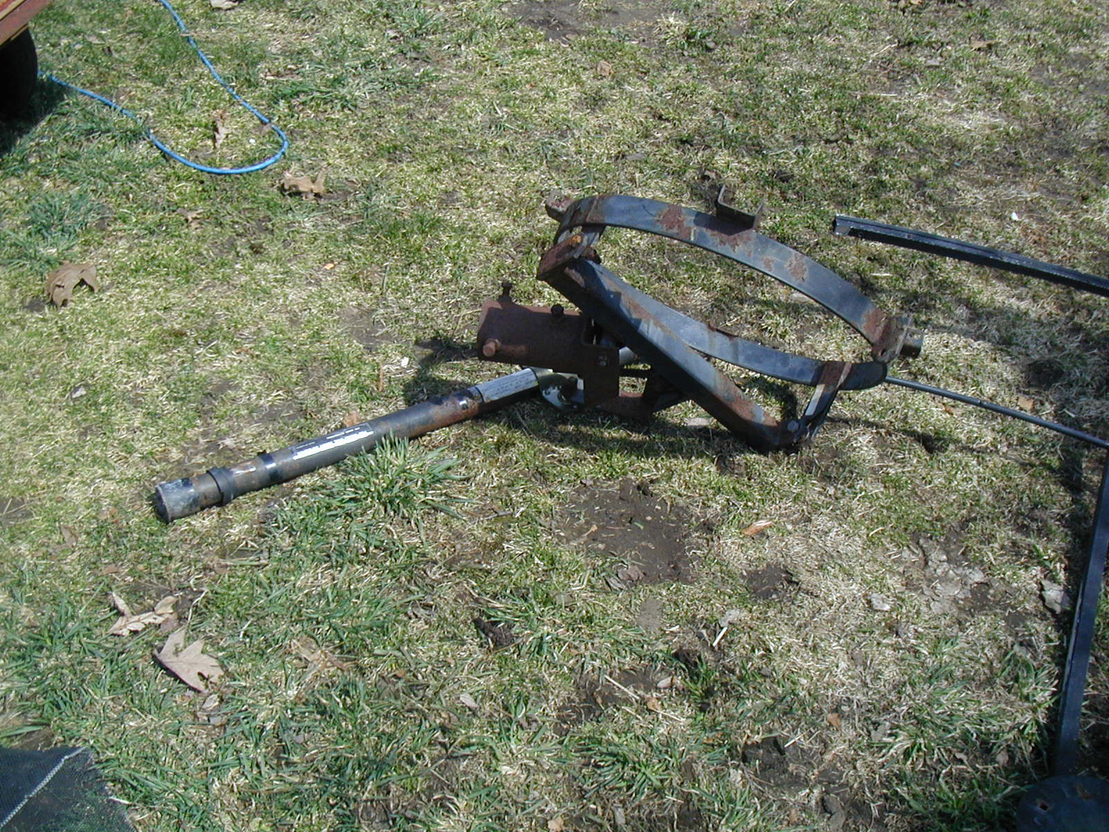

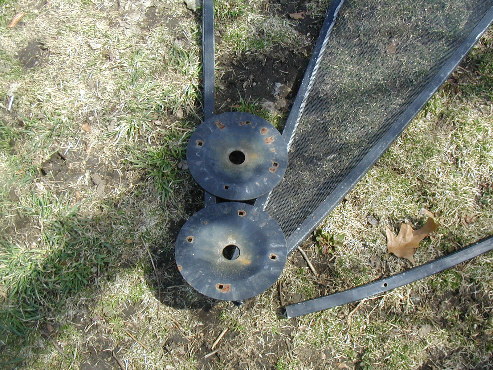

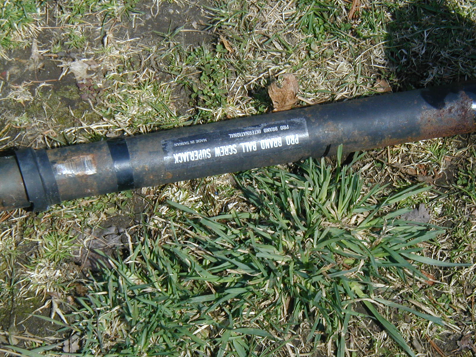

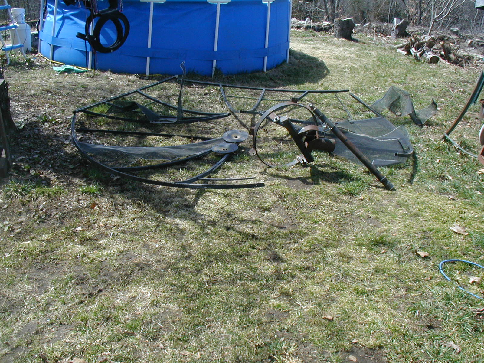

I may have a mount for that dish, I'll try to post some pictures of it. It's in rough shape but could be brought back. The dish it was with flew off the back of a scrapper's truck and smashed and they never came back to pick it up, but the mount seems still ok. I'll try to post some pictures tomorrow or the next day, if it's what you need, you can have it.
Mount pictures
Rrob311, here's the pictures.
