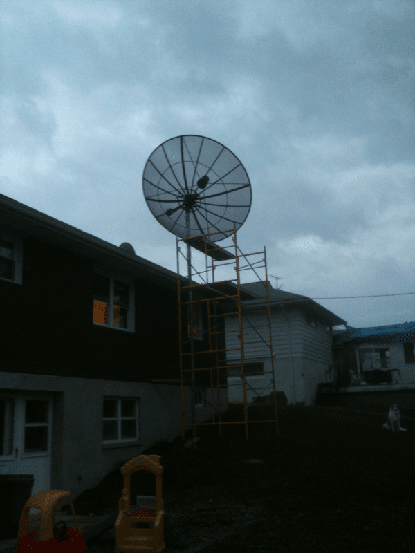

I am trying to complete setup of my 10' mesh. I was given it from a nice lady about 5 miles from my house. Am I correct in assuming that I should not need to adjust the Inc/dec settings? I am concerning myself with finding the ARC and making sure the new LNB is at the correct FD. My KU true south is 74. Should I use 72 for C? I am assuming that I should retract the actuator all the way and guess at my western limit and then make sure that the actuator can extend to hit my Eastern limits? Then I should peak it at 72w? All help is welcome. Thanks. I have my pic attached.

Wow, (just noticed the picture) I hope you don't have to go up there in the midst of winter to adjust/fix anything. (I'd put some xmas lites on it)
The scaffolding is rented and needs to be return in 2 days. I am hoping to get most of the tweaking done now with the LNB and ARC. Is that realistic? Can you recommend how I can tweak it without scaffolding? I was thinking of wearing a climber harness and attaching myself to the pole. If I position the dish over my roof I might be able to access the LNB - not sure. I am thinking I need to make sure the LNB is set up correctly and then adjust the ARC.
Since the dish was previously in operation, most likely on C band subs, the C band should work fairly well. But most can be readjusted for better performance, especially if it's going to be used on Ku band also. Don't know the brand/model of dish, but there is a sticky on linking to focal lengths, maybe yours is listed, minimizing the experimentation.
I'd be very careful on the roof. Looks as though you'll need a ladder,( ladders+roofs=extreme danger) even with it moved all the way east with the jack. Might have to spin it around on the pole to work on it safely. Then re-acquire the sat it was on before the "spin". No matter, it's a two person job, for safety.
