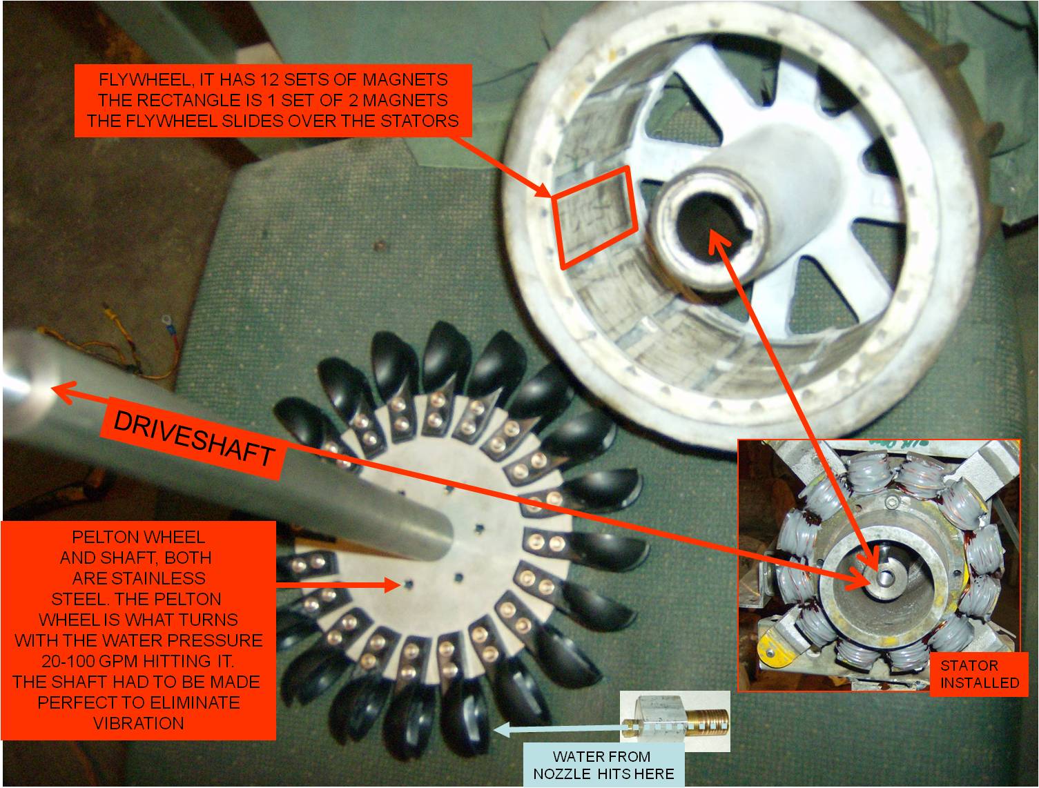

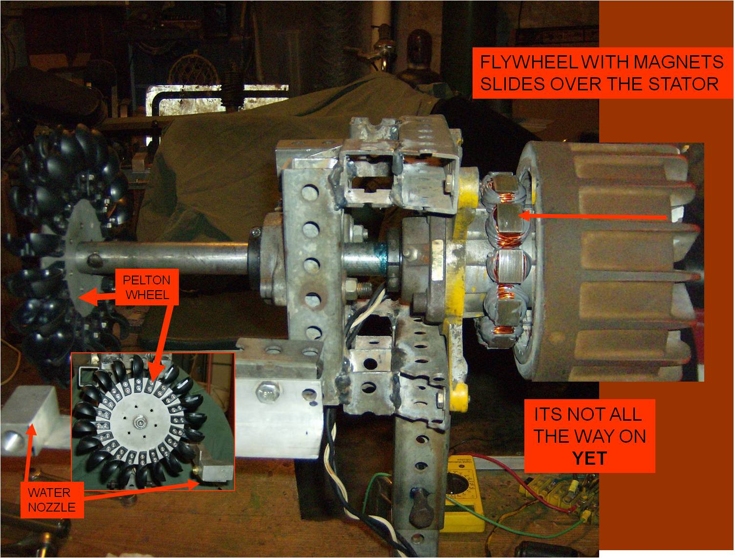

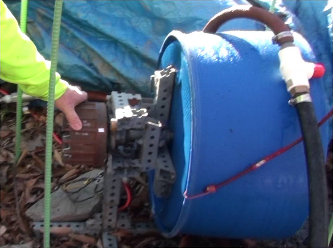

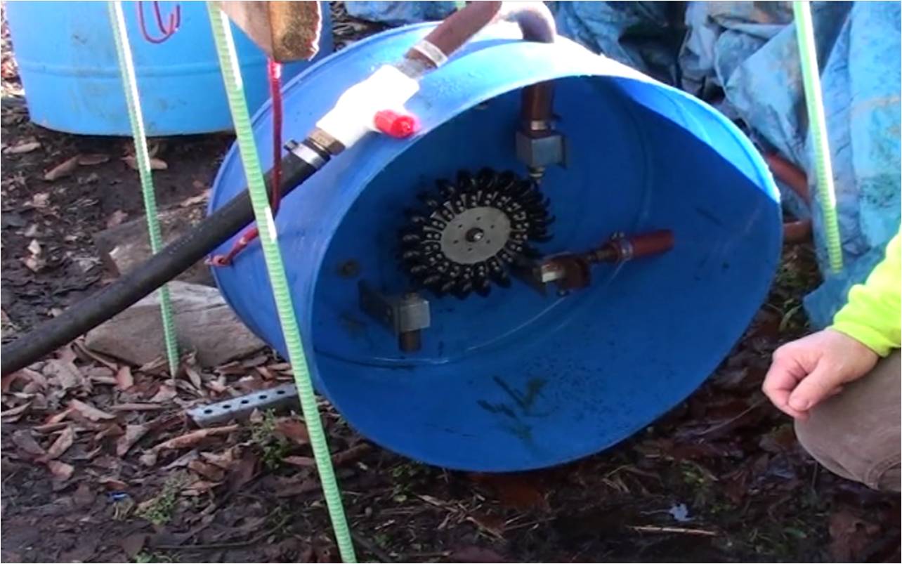

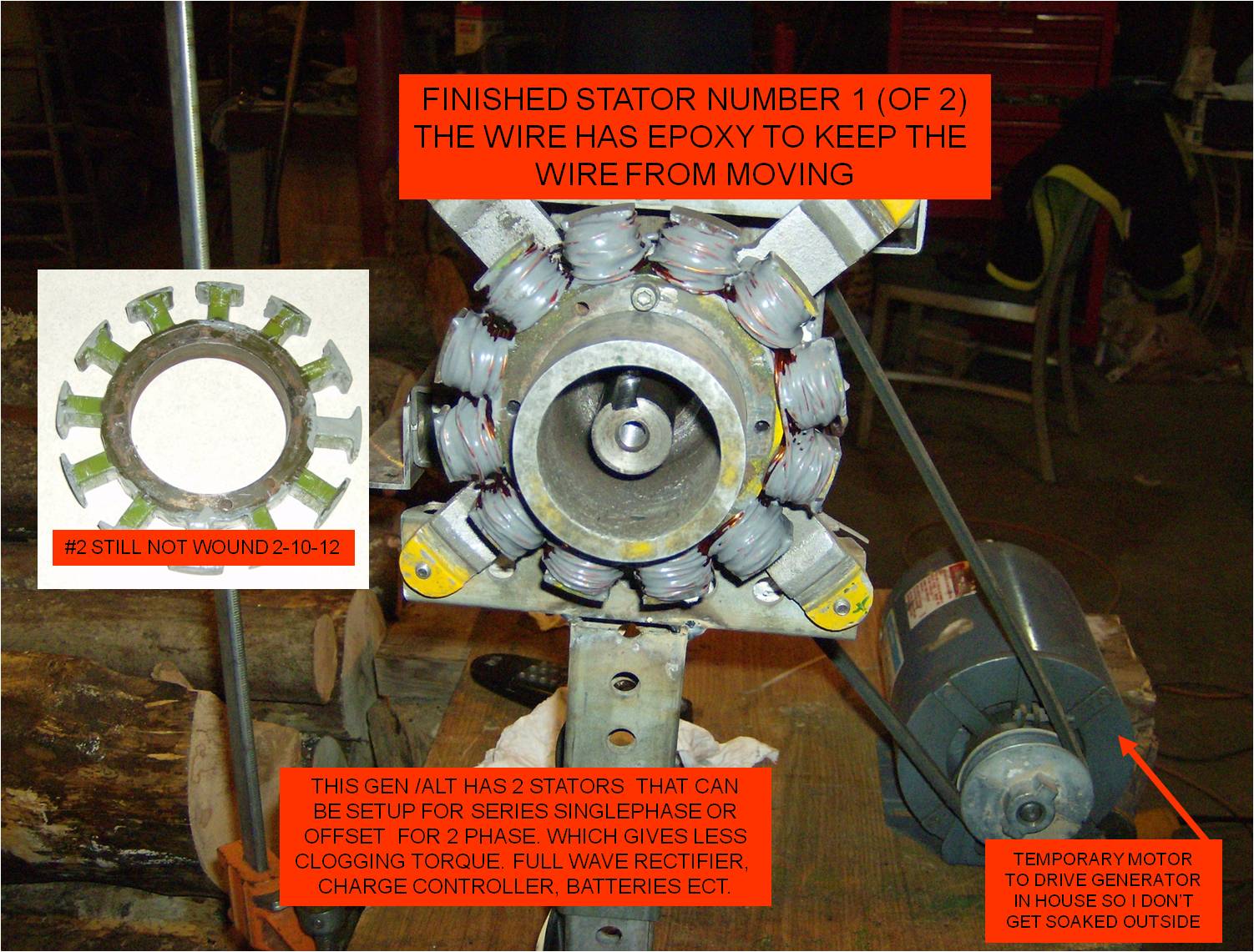

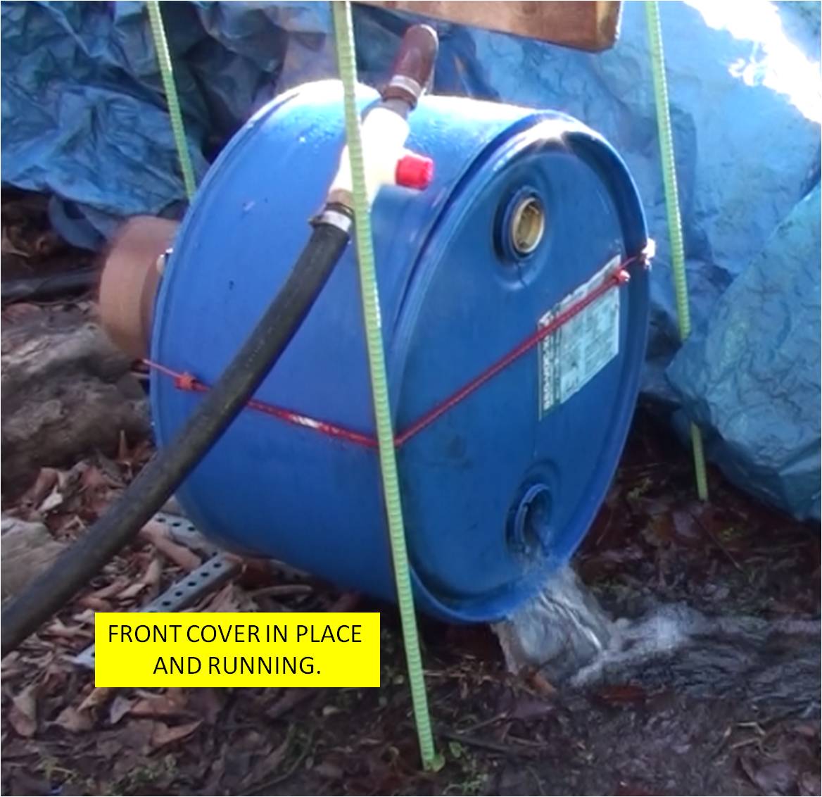

Well, its a long way from right, but here are some pics..
to be right, it needs rectifier (i have) charge controller, inverter. 4 inch buried supply line 600ft long.
and a better valve system as i have a large reservoir of water up the hill that can be used as needed.

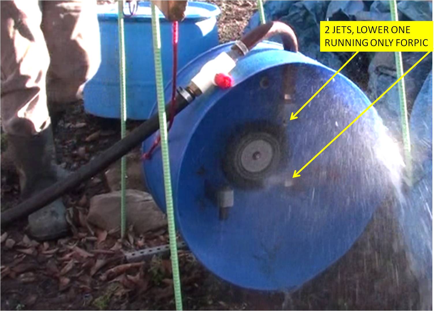

it is a continuous 50 gal/min in the winter. currently i can utilize about 16 gal/min. but i could run 120 gal/min with a 4 inch line
i have a 110ft head. Still a long ways from off grid. The micro hydro is made up of a bunch of reject parts refurbished.
I did have to buy the copper wire. i used 16 gauge, but i wonder if 18 would have been better. My max wattage will be 1k when done.
i cover it over with a tarp to keep it above freezing in that area only.

How much water pressure do you have at the nozzles?
Don't have any topography around here to get enough water pressure to make this work, but nice to see it being done where it can be.
I am planning to build a wind turbine, I have a flywheel and stator from an old boat engine that should produce maybe 150w if I can get it to spin fast enough. Need a heated shop to work on this sort of thing in the winter...

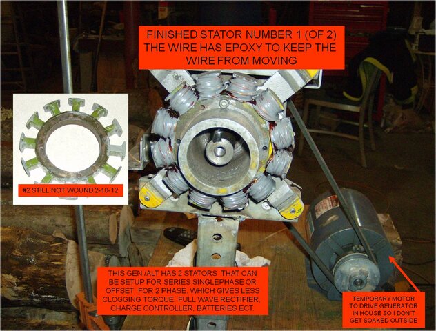

The stator is wound with 16, i will eventually be using 10 gauge to come into the house. i already have the wire. Stator is fan cooled.
47psi static water pressure, i can get another 20 foot drop later. no more pipe at this time.
i am not sure what i want for an end voltage or appliances yet, fridge and freezer need to run, water, then i dunno. 12 volt stuff is an option. someday when i have work and money.
this is just a toy for now, but it is hard to sleep with all these lights on all the time.....
3 phase windings are likely the most efficient, especially at higher voltages like 240 to 308vac, phase converters can change it to 240 single phase closer to your house (load) so the cables between the generator and house don't have to be so heavy, 10ga would supply 8-10kw depending on voltage.
It starts getting really complex when you want to add your power to combine with the mains and feed power back into the grid for a refund. Phases must be matched and devices that are approved to do this are rather expensive. Then they pay you 5% of the rate they charge you for power... figure that one out! Best to use your own power and cut your electrical bill, at least down to the basic charge. You'll always want it available for backup!
3 phase is better, but in this case with the junk parts i made this with, the stators all align with the magnets so that true 3 phase is not an option, only 2 phase is possible and will be done in the future when i have a charge controller ect ect. Currently the 2 separate stators connected in series to max voltage to run house components directly. this gives a lot of clogging torque but there is little wattage loss from the single step up transformer . this transformer is so big, i cannot lift it without help.
