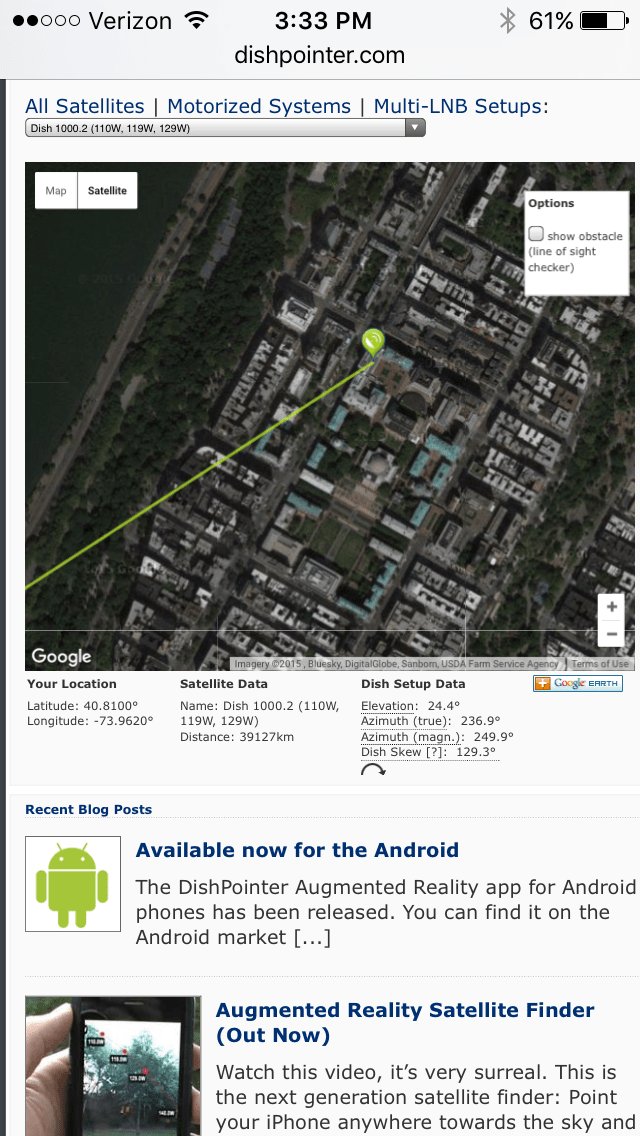

These are the angles you want per zip code
