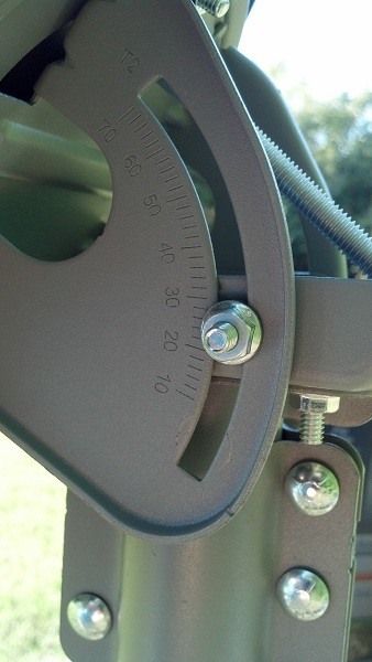

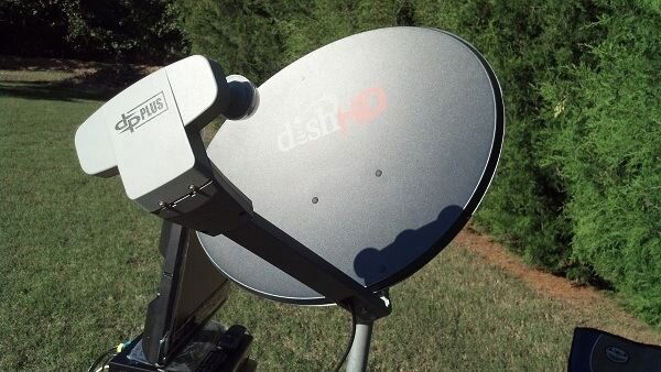

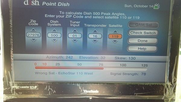

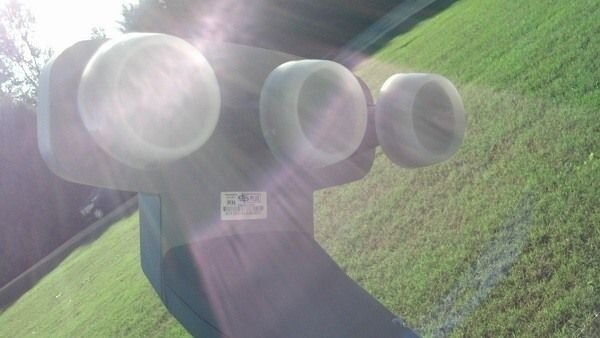

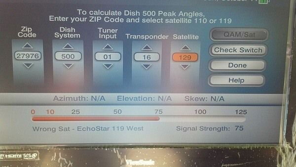

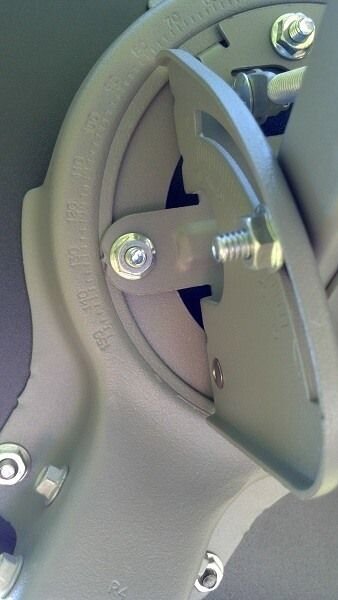

Been at it since noon and it's the same story. When I'm on satellite 119 it says it's 110. That's with the new numbers from dishpointer.com and the old numbers from the receiver and everything in between and even outside of those numbers. I CAN NOT hit the right satellite for some reason and I have NO IDEA what it is. I took pictures of the screens. I have good signals in the mid to upper 70's they are just the wrong satellites. I can't get any signal on 110 at all, NOTHING. Does anyone see anything wrong in these pictures? Are their different dishes for different areas?? I'm at the end of my rope here. :confused:
Looks like you are actually picking up 110 on the 119 LNB. This means that you need to move the dish to the right by 9 degrees or so and probably lower your elevation a tad.
Have you ran a check switch? If so what is showing up in the matrix? It should be 119/110/129. If you are getting 110/conn/conn then my previous suggestion should do the trick.
Also make sure wherever this dish is located actually has LOS to 119/129 as they are lower in elevation than 110.

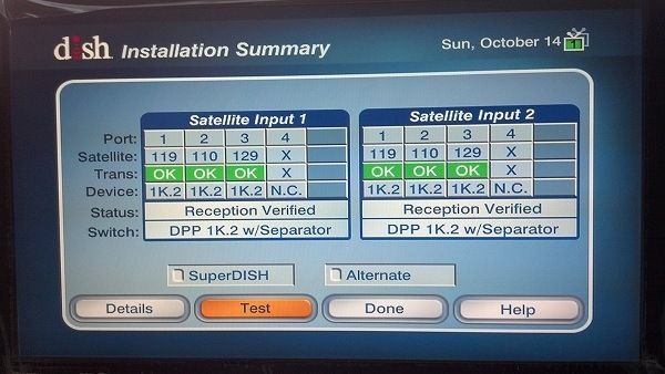

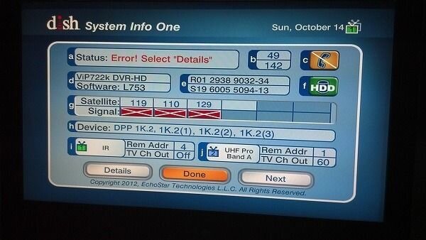

Here is a picture of my check switch screen.
I definitely have a clear LOS. I may have to give up for the day I am running out of day light here.
So you haven't run a check switch? It is still showing the 1000.2 in your lineup. Go ahead and hit "test" and see what it comes up with on the matrix.

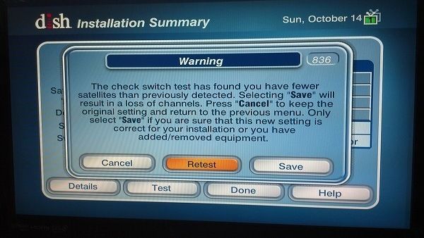

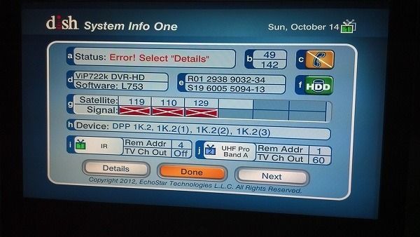

Here are the pictures I got when I ran a couple other test with the 1000.4 dish still hooked up.
Sorry it took me so long to get back to you I had to break the 1000.4 dish down and put the 1000.2 dish back up before it it was completely dark.
Where do you go to look to see if the 1000.2 dish is still the one in the lineup. I searched everywhere.
View attachment 81801View attachment 81802
In the first picture look at line h. 1K2 is a 1000.2
Next time you have the other dish hooked up hit save to see the actual results. Don't worry you can run the test again with the 1000.2 hooked up if all else fails.
