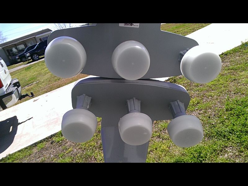

It's pretty simple. A 1000.4 LNB goes on a 1000.4 dish and a 1000.2 LNB goes on a 1000.2 dish. There are EA and WA LNB's for both type dishes. You need to get the one that matches your dish.
The 1000.4 lnb's are larger than the 1000.2 lnb's.
These are WA, but you get the idea.............
