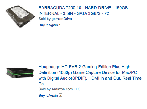

It's dead for all intents and purposes. I replaced it with a 160gb (smallest I could find) and a PVR recorder.
Now I can not stockpile a lot of stuff in the Dish PVR and if it's something I really, really want to keep I can capture it into my Mac with the external PVR.
Actually I can program the Hauppauge to turn on and record anything I want by schedule. I just have to program the Dish tuner to change to that channel ahead of time.
And since the Dish PVR is so small the ~mandatory~ daily disk check only take a few minutes. With the 2tb disk it would take TWO HOURS to go through the disk check.
