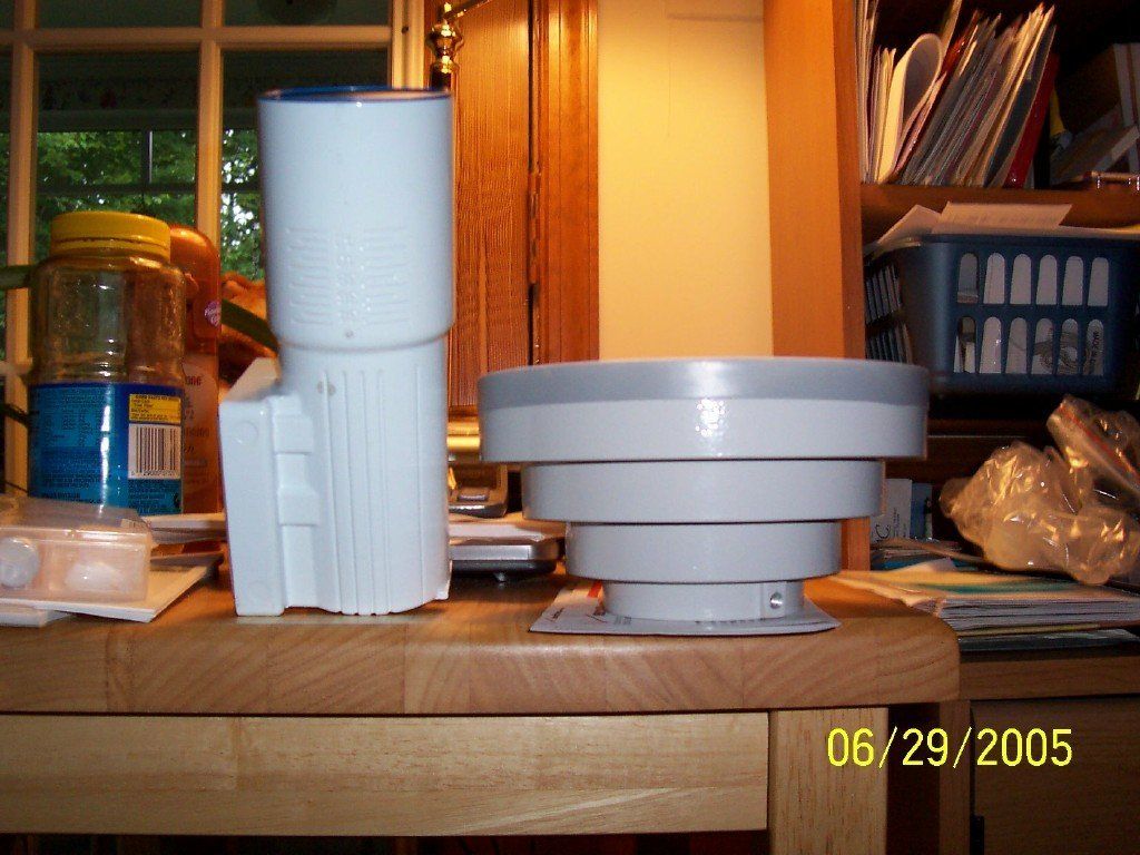

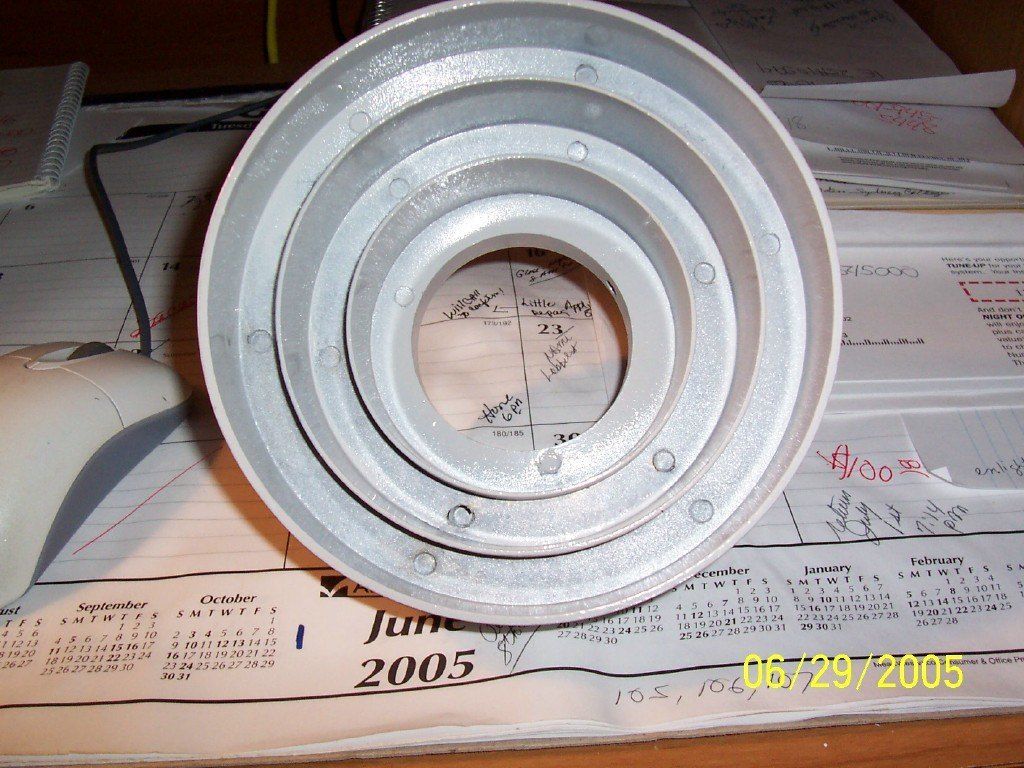

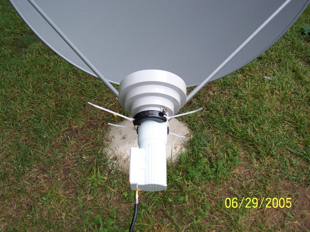

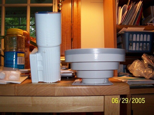

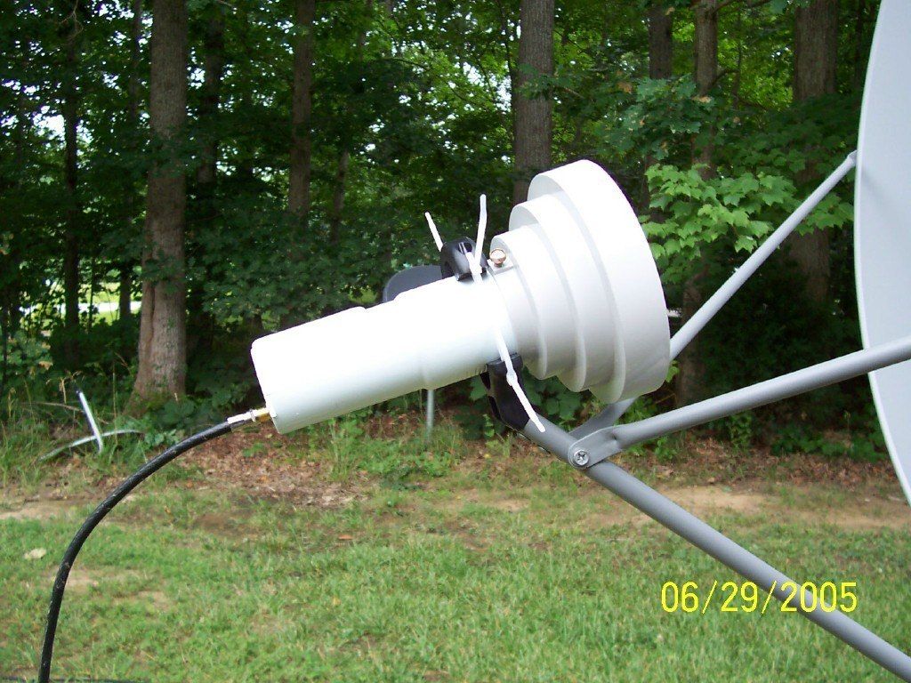

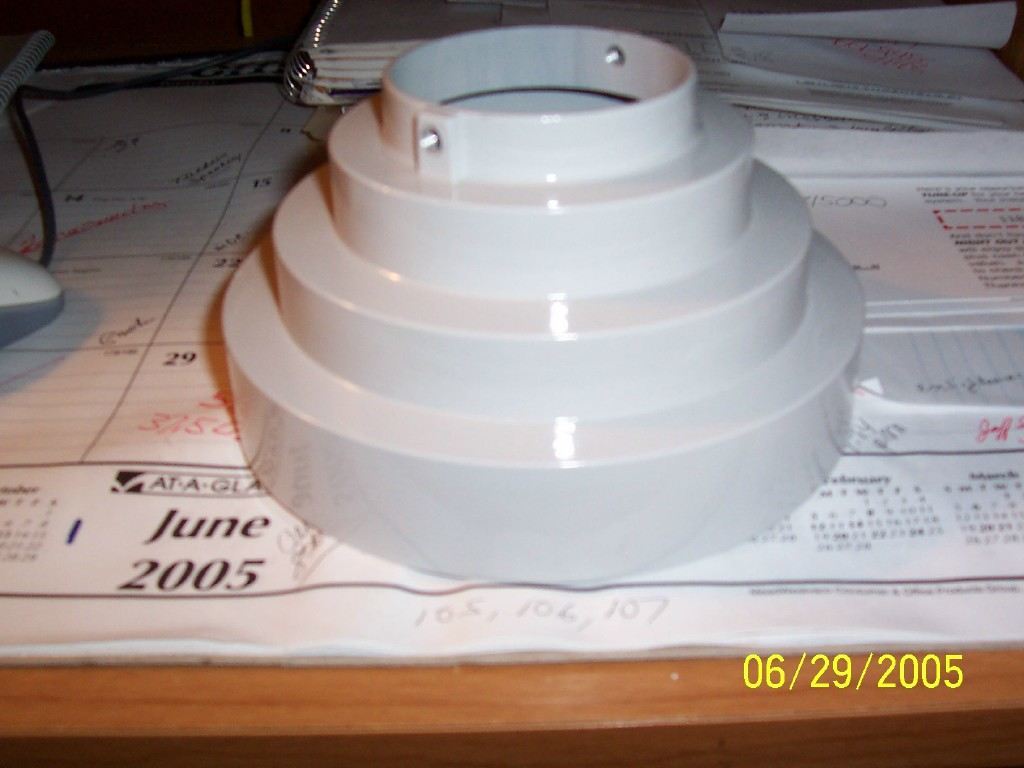

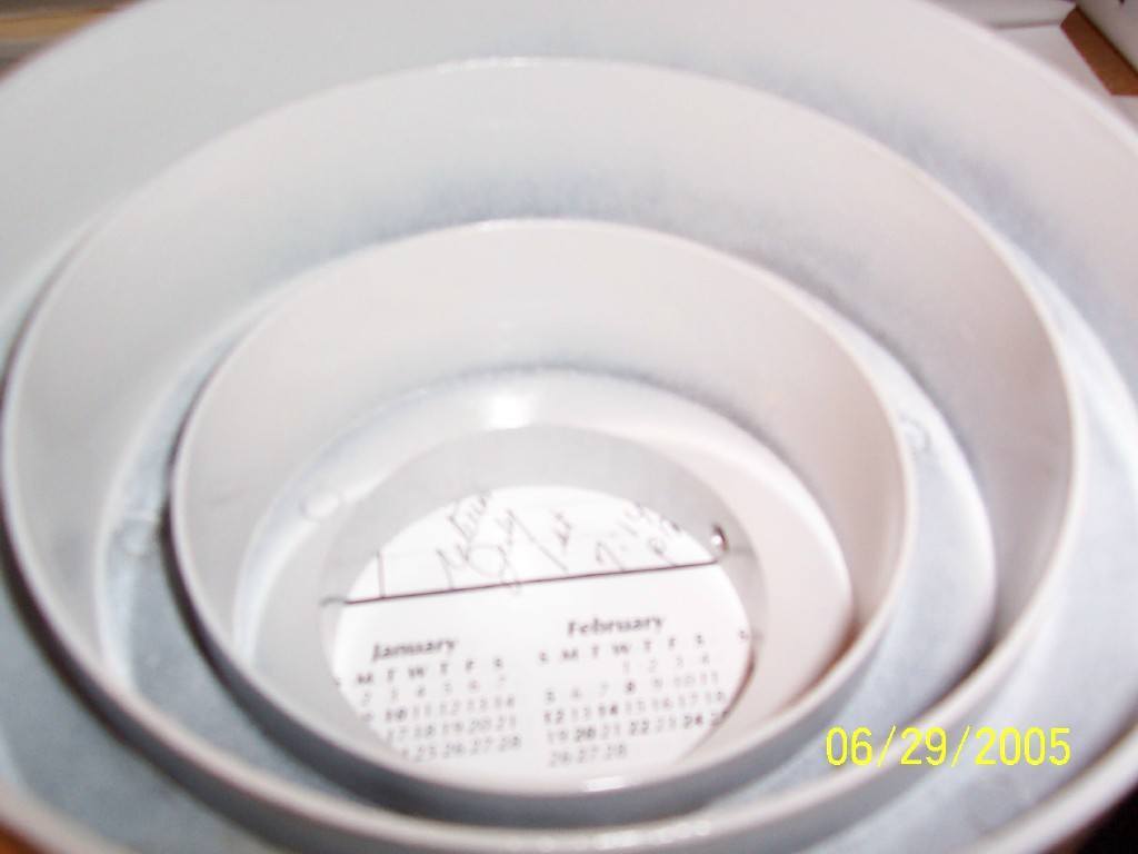

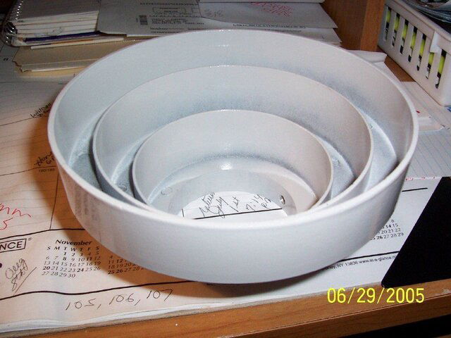

Just received my offset C-Band LNBF and it has the cone shape ring - this is the real deal guy's. It comes with a nice heavy duty mounting bracket that fits the throat that will attach to your LNB arm. I have yet to attach it to the mounting bracket because I will need to change support arms and I wanted to get it on the dish asap. I have it tye wrapped and found it likes to be as far towards the dish as possible with the scalar set at the .42 mark. I am still on Anik F1 and have noticed perhaps a couple of % difference in Quality on some channels. One H-pol channel which I could not get before, I can now even though the quality is lower that the majority of the other xponders at 68-69%. Even though the ad on the EITS website said that there was a dielectric slab inside, mine did not have this. The picture shown on the website of course did not show the cone ring either.
The brand is Astrotel and it case you're curious the model is - PM-9/ C-V/H GOLD.
