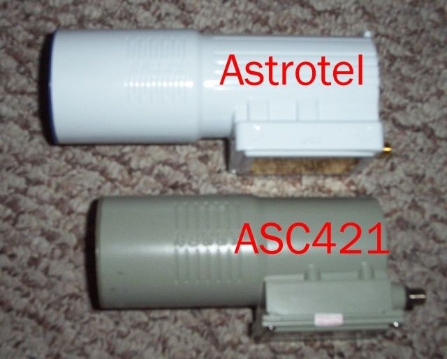

Just got my nice new offset LNBF with cone Devo-hat scalar from EITS!
Thought it would help if I gave some stats on it and the DMS 421; I think they help explain why the above worked better ;)
Astrotel Precision LNBF
Output Freq. 950-1450 MHz
Noise: 20 k
dB Gain: 65
DMS International ASC421 LNBF
Output Freq. 950-1750 MHz
Noise: 13 k
dB Gain: 55

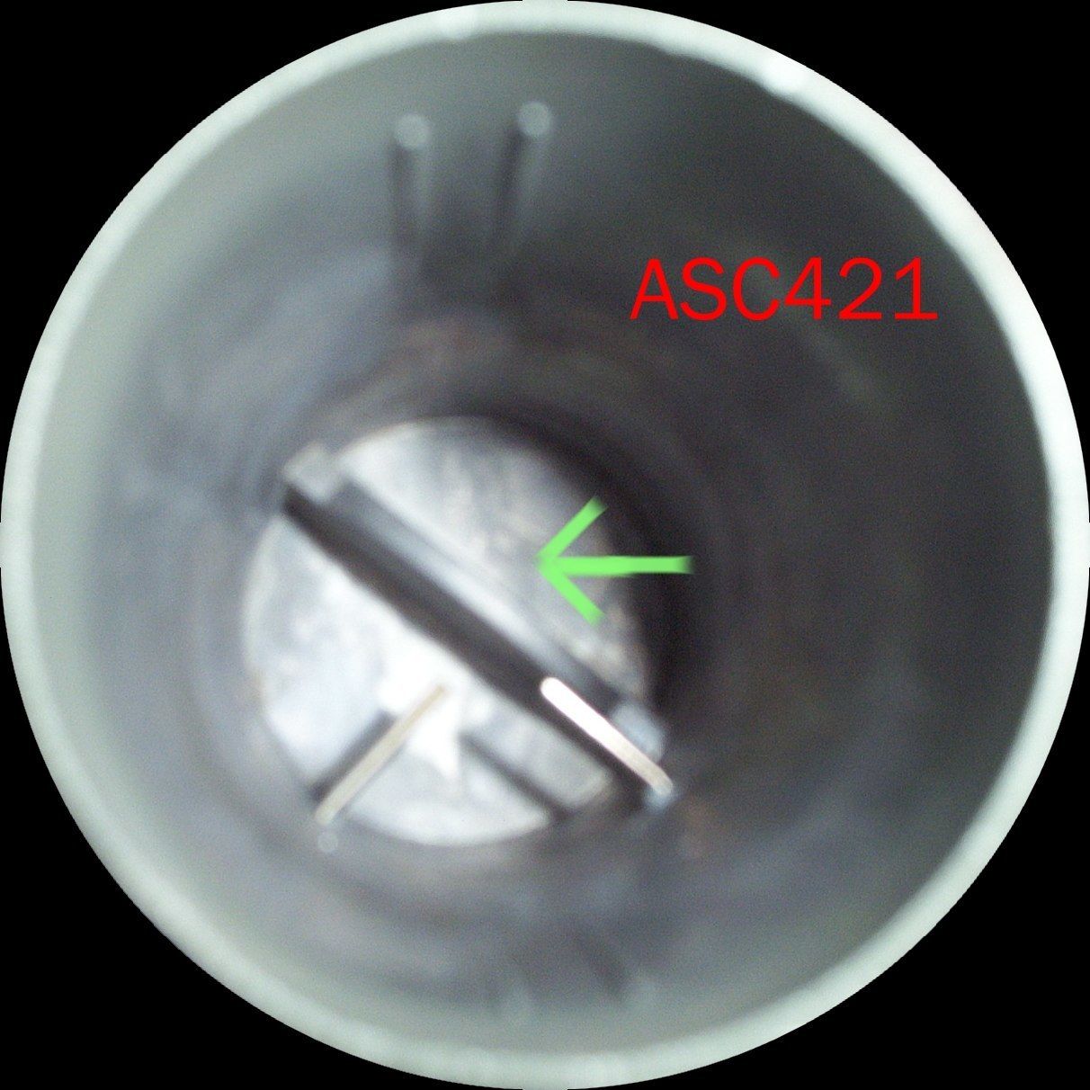

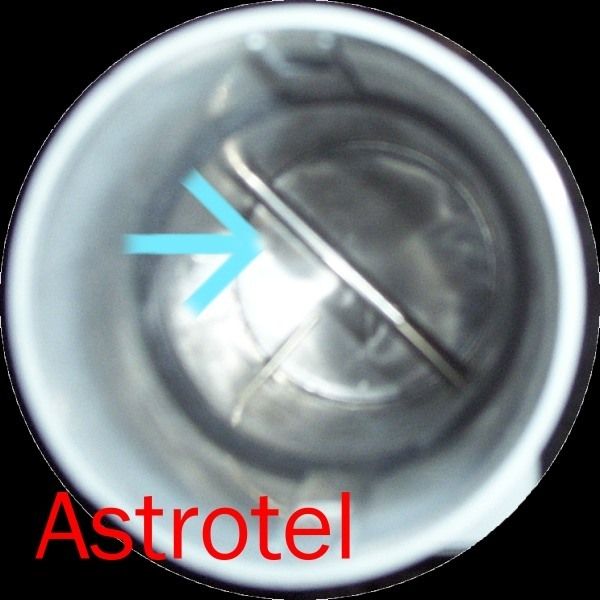

Looking inside these two lnb's, there's a distinct difference in design. I'm thinking that the Astrotel would be a better sacrificial lamb to try the Invacom/C-band LNB combination project (chopping the end off the back of the C and inserting the Ku). Instead of a metal wedge on the rear wall, like the 421, the EITS lnb has a metal rod about 1/4 of the way up the feedhorn, between the H and V elements. (See attached pictures, with colored arrows pointing at the back wedge and metal cylinder.)
Still waiting on the 1.2m Patriot dish to arrive to try these lnb's out. I think I'll need to modify my DPC dish mount or beef up a few old DTV dish mounts, to make my dish light enough so my SG2100 doesn't cry and smoke ;)

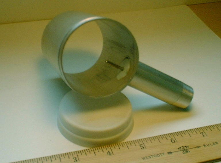

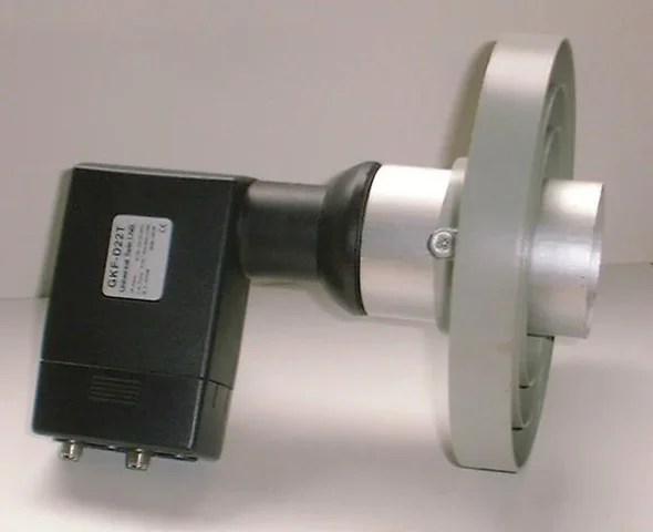

C/Ku combo tests
The first photo shown here was a test relative to concerns of cutting out the back of a C band lnb and attaching Ku. I machined this tube at 2am and my .03 was on the dish so used another Ku. The Ku by itself had a 45% qual on 12114 V 4.444 , G10. The C band test adapter didnt seem to improve or diminish quality, ......so may tend to lend itself to the thought of cutting out the back of a C band lnb. If I can successfuly remove the electronics from one, I may take a shot at it. On page 17 of this thread, I posted a photo of a dual feed. Ive always since wondered if I could do this with C/Ku. The second photo is of the C/Ku adapter. Third photo is of the adapter setup. While the adapter didnt seem to diminish the C band quality , it did nothing for the Ku. Tried adjusting scew on Ku, focal point, various things.....still 0.
