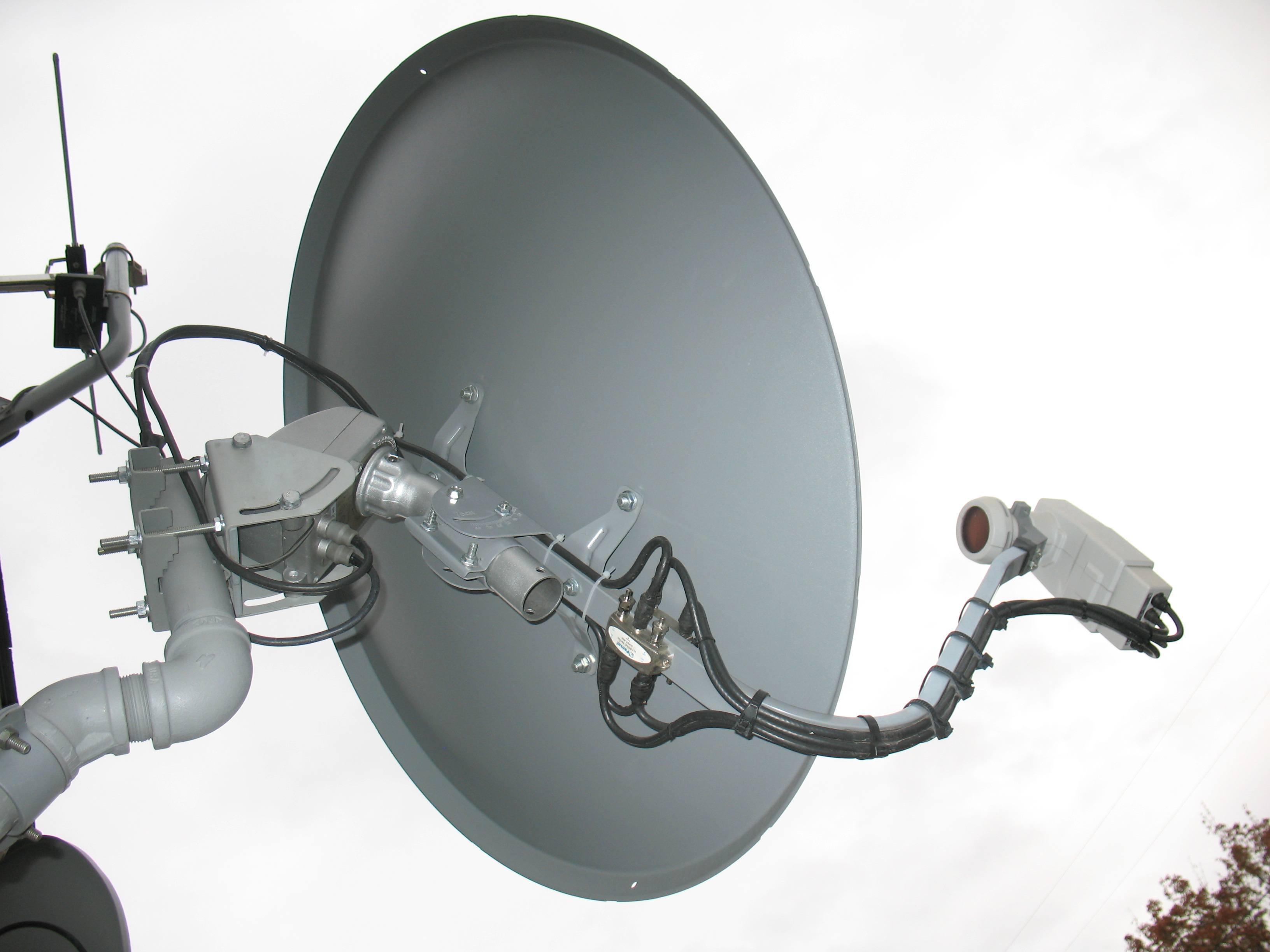

I used one for years with an Invacom QPH-031 LNBF. Worked good for me on 125W.
