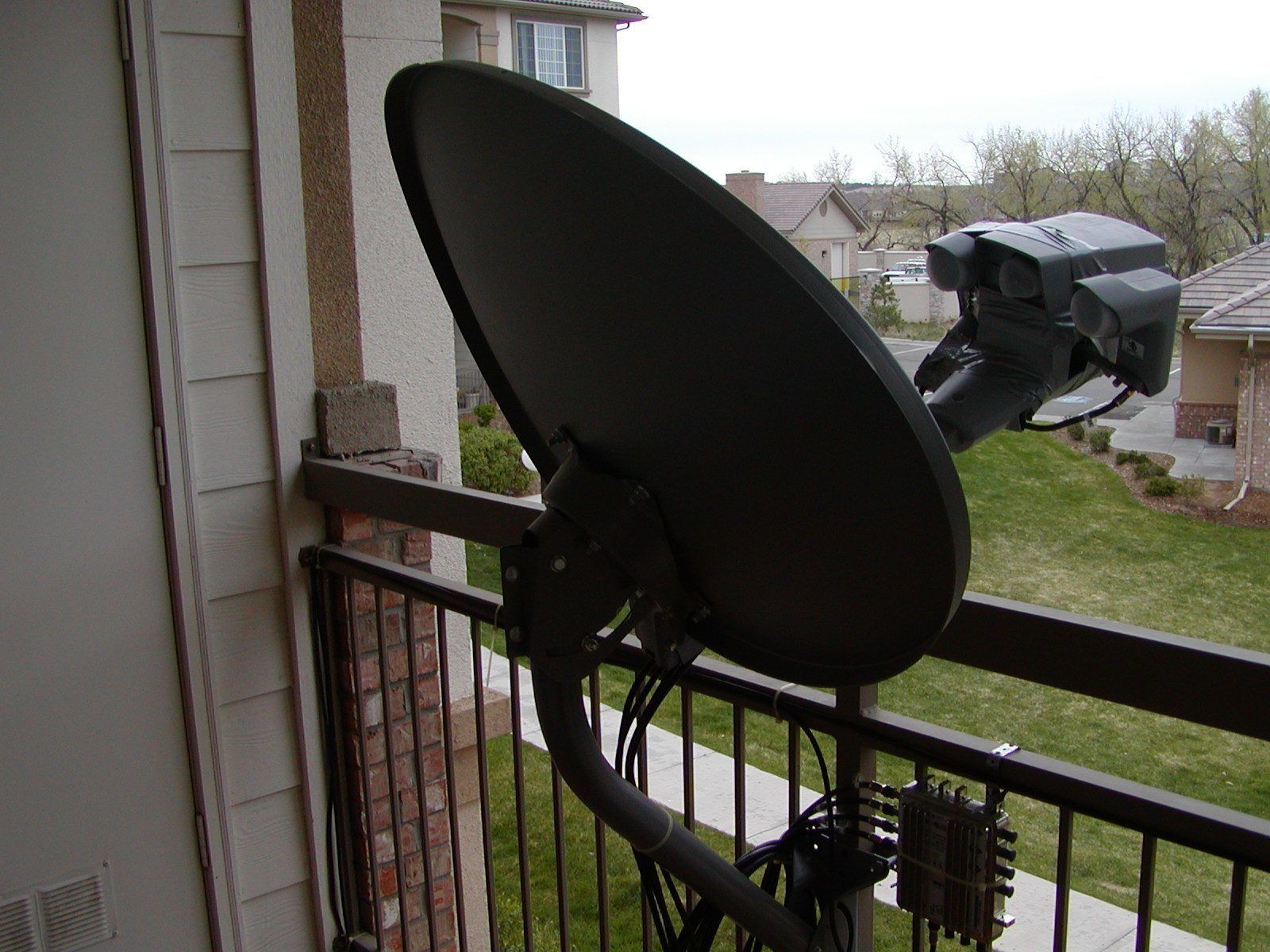

I subscribe to HD-Silver with Denver locals and the Korean package. I have a Superdish 121, a ViP-622, a DPP-44, a DishPro 500, and somewhere in the garage I have a 2000 deluxe package (2000 with UHF remote and a 18" dual LNBF which I think they originally called a deluxe LNBF instead of dual) that I purchased in 1996. Why the 121, I originally purchased it to get locals in a different city - I relocate a lot.
Here in Denver, I do not have a problem getting the 129. I first used the SuperDish 121, and adjusted the skew, elevation, and azimuth on the DP500 to get 129, it worked great once I figured out that the RG-6 center conductor needs to be longer than normal for the DPP44. However....
Back in April I heard that Dish was planning on coming out with a 4 orbital location dish. Also, I figured since the SuperDish 121 was a bigger dish (slightly bigger than the Dish-1000) and since 129 was not far from 121, I should be able to pick up 129 using the SD121.
My calculations were right. Using a DP Single LNBF duct-taped to the shroud on the 121 LNBF side, my Superdish 121 now picks up 110, 119, 121, and 129, and without having to re-adjust 110/119/121. I have no problems with HD or anything else and have not lost any signals, even during the couple of times it rained.
Although down south we've always considered "duct-tape" to be a permanent investment, my plan was to eliminate the duct-tape by making a bracket to go from the I-bracket to the SD121 arm. However, I suspect that the Dish 1000+ upgrade kit with the W-bracket will modify my Superdish 121 to be about as best as can be without a 10' dish pointed at each satellite. So I am holding off until I see what kits are available.
But in the meantime, I am readjusting my DP500 to 61.5 and will connect it to the DPP44 instead of the 121 LNBF, so that my DPP44 will provide 61.5/110/119/129. The reason for this is 121 only has 4 of the 6 Korean channels, while 61.5 has all 6 Korean channels and CBS-HD east.
I am hoping that the new kit on my Superdish 121 will give me a strong signal on 110/118.75/119/129, and that 118.75 has all 6 Korean channels, with or without CBS-HD east.
On a different thread, it was said there was no mention of a kit for the Superdish 105. If I'm not mistaking, the Superdish 121 and 105 are identical except for the LNBF assembly and shroud. Therefore removing the LNBF/shroud assembly on either dish and replacing it with the Dish 1000+ upgrade kit, plus a single/dual DP LNBF should be the same.
In response to the comment from "ralfyguy" about if one TP is peaked then all others are peaked. I agree with that, provided you are talking abot the same satellite. However, if you peak 129 to max, 110 will probably not be peaked to max, but then if you are having problems on 129, then it would be better to peak 129 until you just barely have a 110 signal, or use a 2nd dish between 129 and 110/119.
