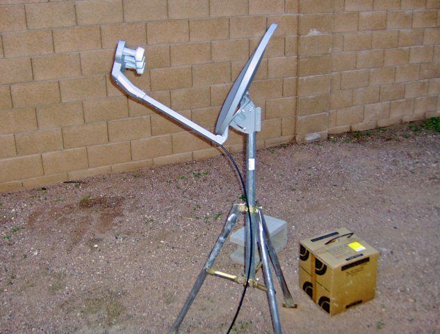

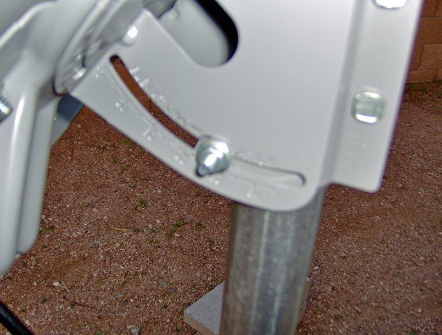

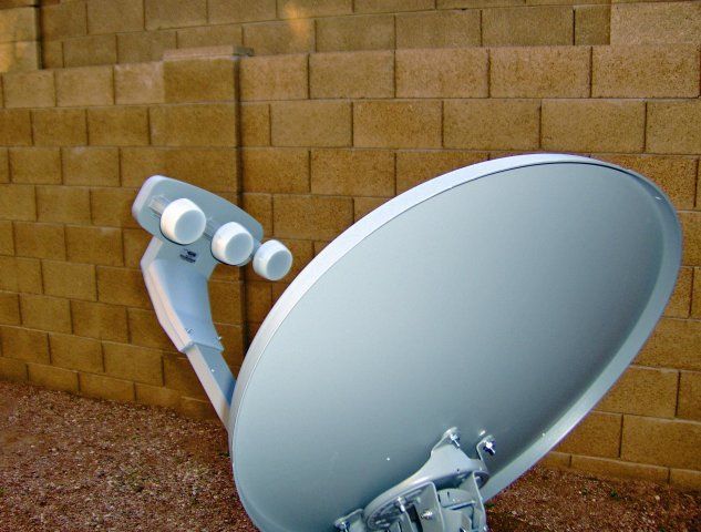

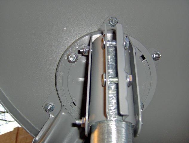

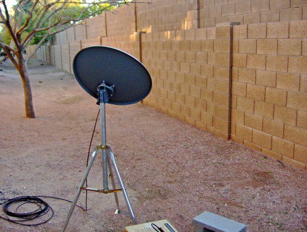

I managed to pull off a great experiment. I used a 1000.2 to pick up the 148 and the 129 concurrently. The significance of this is currently being discussed in the Pub Members' Forum. I had to calculate the settings for the 1000.2 to these satellites with very little outside data. I used some pointing software to determine the direct angles to 129 and 148 from my location of 85374. I estimated the skew to be 124 and the elevation to be 42. The azimuth is around 233. When pointing to 110/119/129, the skew is usually 103 and the elevation is 51. I had all these settings written down, only to lose the paper they were on. I recalled what they were from memory but I was a bit off. I still managed to find the signals right where I originally estimated they would be. That was to be confirmed when I finally found that paper with the settings. ;)

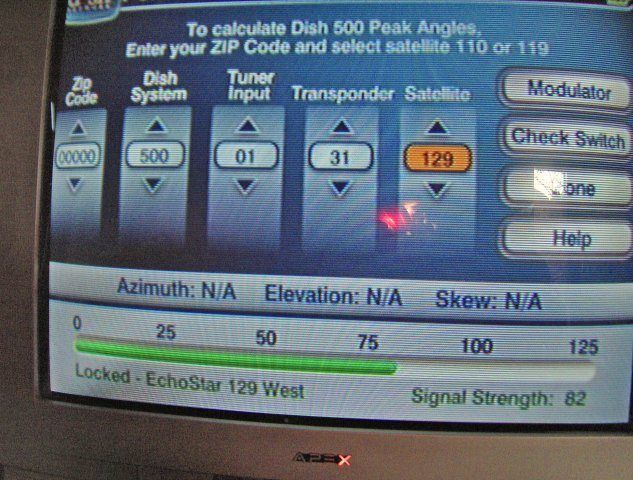

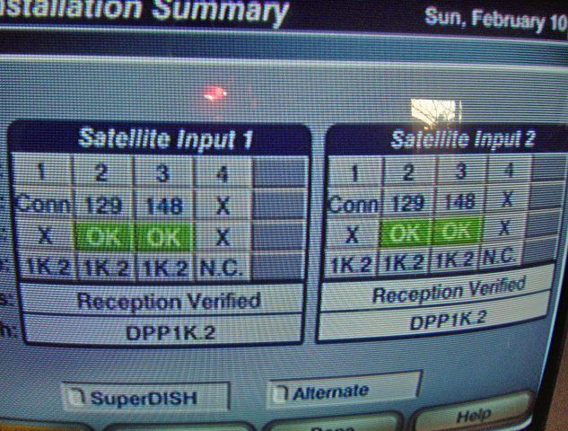

The check switch came out different than I first thought it would but that was due to my own error. I originally figured it would show 129 X 148 X. However, since the LNB originally intended for Port 1 is the 119 (center eye), that puts the 129 on Port 2 (right eye as viewed from behind), which is the original 110 eye. So, my checkswitch was X 129 148 X. You can see from the equipment identified on screen that it is in fact a DPP1k2 picking up the signals and not some external switch sleight-of-hand.

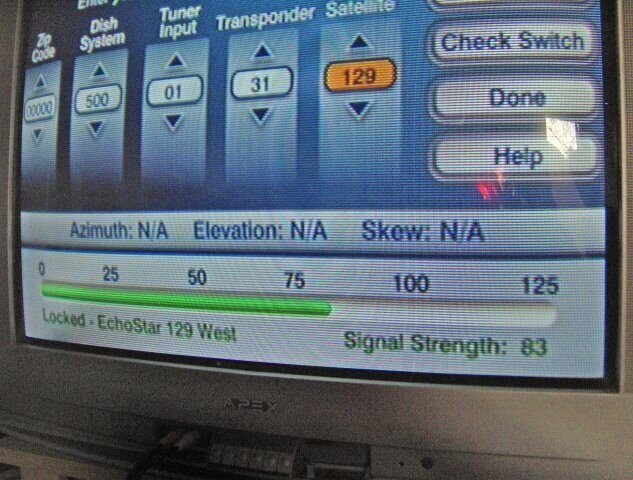

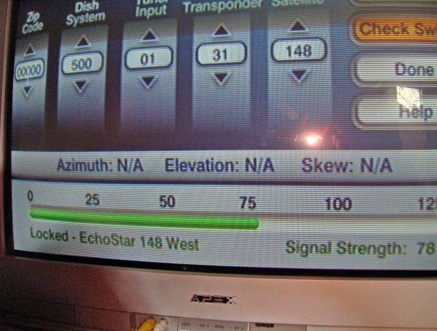

I got a great signal on 129 T31 of 83 (old meter) and an acceptable signal of 78 on 148 T31. I don't know what the typical signal level of that transponder is when obtained through a Dish 300 so I have nothing to compare it with. It is possible that with some skew adjustments and other angle adjustments that a better signal could be had. However, after tweaking the settings, I managed to find a skew and elevation I was content with. I imagine better software would probably come up with slightly better numbers.
Here are some pics for you all to check out.
