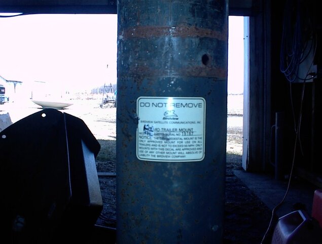

I've seen a few tripod mounts, and have to collect a 10" mesh on one in a week or so. This was my first sighting of an official trailer mount from Birdview.
I'm thinking of welding some bolts to some rebar, and using those cardboard sonotubes, pouring some mini concrete piers to mount and level the tripod on. Any thoughts/warnings about this approach would be appreciated.

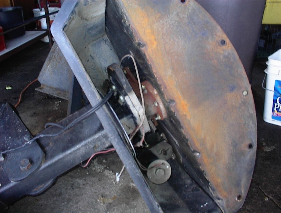

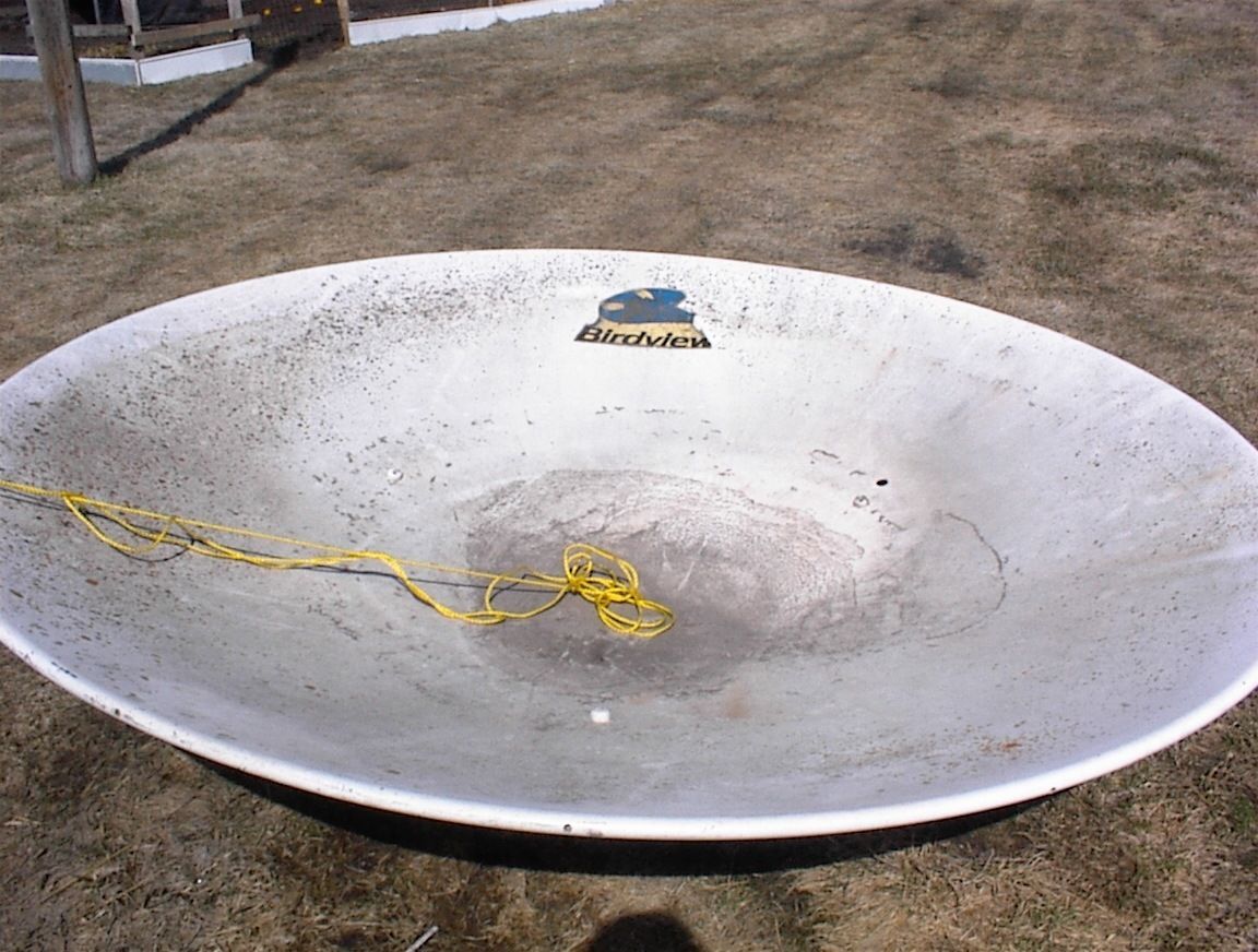

That dish looks nominal. Don't seen any damage.
It'll clean up fine - no painting required.
It's got some sort of baked-on or powder-coated finish that's tough as hell.
The aluminum under it must've been well prepped, 'cause that paint doesn't lift nor peel! - :cool:
The mount looks a little rusty, like many I've seen here on the forum.
Mine shows less rust, and I'm still contemplating what (if anything) to do to the black-oxide covered metal.
Original thought was to give it a scrub, two coats of rust-converting primer, then some Hammerite black.
Might test-paint the inside and where it goes up against the dish, and decide later.
Use serious care with the scalar support arms.
Made of aluminum, I believe.
I've seen fellows damage them.
When you assemble to the dish and to the scalar, use some anti-seize compound that's good for aluminum!
I am afraid of those joints, and will probably leave mine as they have been for the last 25 years. :cool:

Anole, we have almost 6 months every year mostly above freezing ....I'm thinking rustoleum rattle can metal primer followed by brush on enamel. Seen that combo used on outdoor equipment that still looks good 20 years later.
And plenty of assembly lube.

Your mount is VERY clean....they don't have spiders in Canada? Must be too cold! LOL
