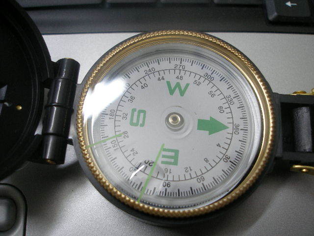

Also if they are the same, which Azimuth I use, the (true) or (magn) and I guess I have to use the out side scale at the attached compass picture or using another type of compass ??:confused:

97°W used to be Galaxy 25 and is now Galaxy 19. So just pick 97°W on dishpointer. In the receiver you should be able to edit the satellite name, but it doesn't really matter, the 97°W and the transponder information is the important part.
But... you should start out finding your True South satellite or a close one. Probably 121 or 123 for you. This will have almost no skew and should be easier to find.
You should use magnetic and the outer (360°) scale on your compass. That will get you pretty close. Set your elevation as calculated, but bear in mind that dish scales can be off by several degrees so you might need to adjust up or down.
Make sure you're using an active transponder, preferably a strong one, when trying to point the dish. You may need to configure the satellite information and then go to a "manual search" screen to select the known active transponder. It depends on whether the setup / install screen lets you select a transponder.
You will not get any Quality on the meter if the receiver is not listening for an active transponder. If the skew is wrong, you won't get any Quality either.
Thank you in advance
Yes use the outside scale and the Magnetic Azimuth.
