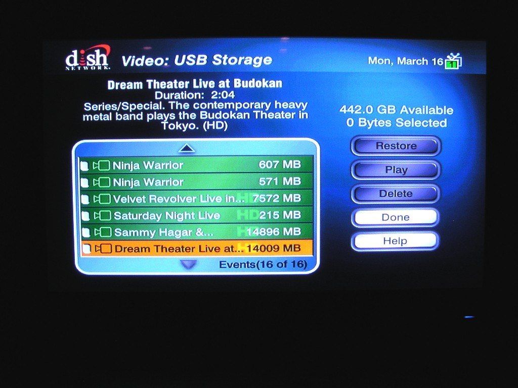

I just installed an Acomdata 1TB harddrive on my 622 (L618).
Model PDHD1000USE-72
Interface USB 2.0 / eSATA
Capacity 1TB
Cache 16MB
Average Seek Time 8.5ms
I used the DVR to format the hard drive and when I went to "Manage" it (MENU+4+2+1) it showed only 499.9 GB available. I transferred several shows to it flawlessly thinking it might recalculate the storage but only see less space available (see attached picture).
Any ideas? Should I reformat w/NTFS on my desktop?
Much Thanks.

Current VIP receivers do not support HD's larger than 750 gbs.
Dish Network says they don't support drives larger than 750GB, but there are a lot of people that are using 1TB and larger with 622s - me for one.
The OP needs to format the drive on a PC or MAC to see the results.
I connected a 640GB drive on my 622 and saw that it created two partitions, one of 500GB and one of 140GB. The amount of free space shown by the receiver shows that it utilizes (or will utilize) both partitions, but I found it interesting that it didn't create one big partition for all the recordings.
Yeah I would do that as well format from your PC see what it does then. Then you might run the format again from the receiver. What would help on this is folks that have a HD that the Dish receiver reorganize it has a 1 TB. You should post the make and model of your HD so folks can compare so forth.

The only think I can recommend as was mentioned prior is to reformat and see what happens.

After my wife gets done watching American Idol, I'll bring the drive to my PC for diagnostics. I'll post results tonight.

I reformatted the drive to NTFS (no partitions) on my PC, hooked it up to the DVR, had to format it again on the DVR, and now there's 1TB available.:up
BTW, the drive inside the acomdata enclosure is a samsung in case anyone was interested.
