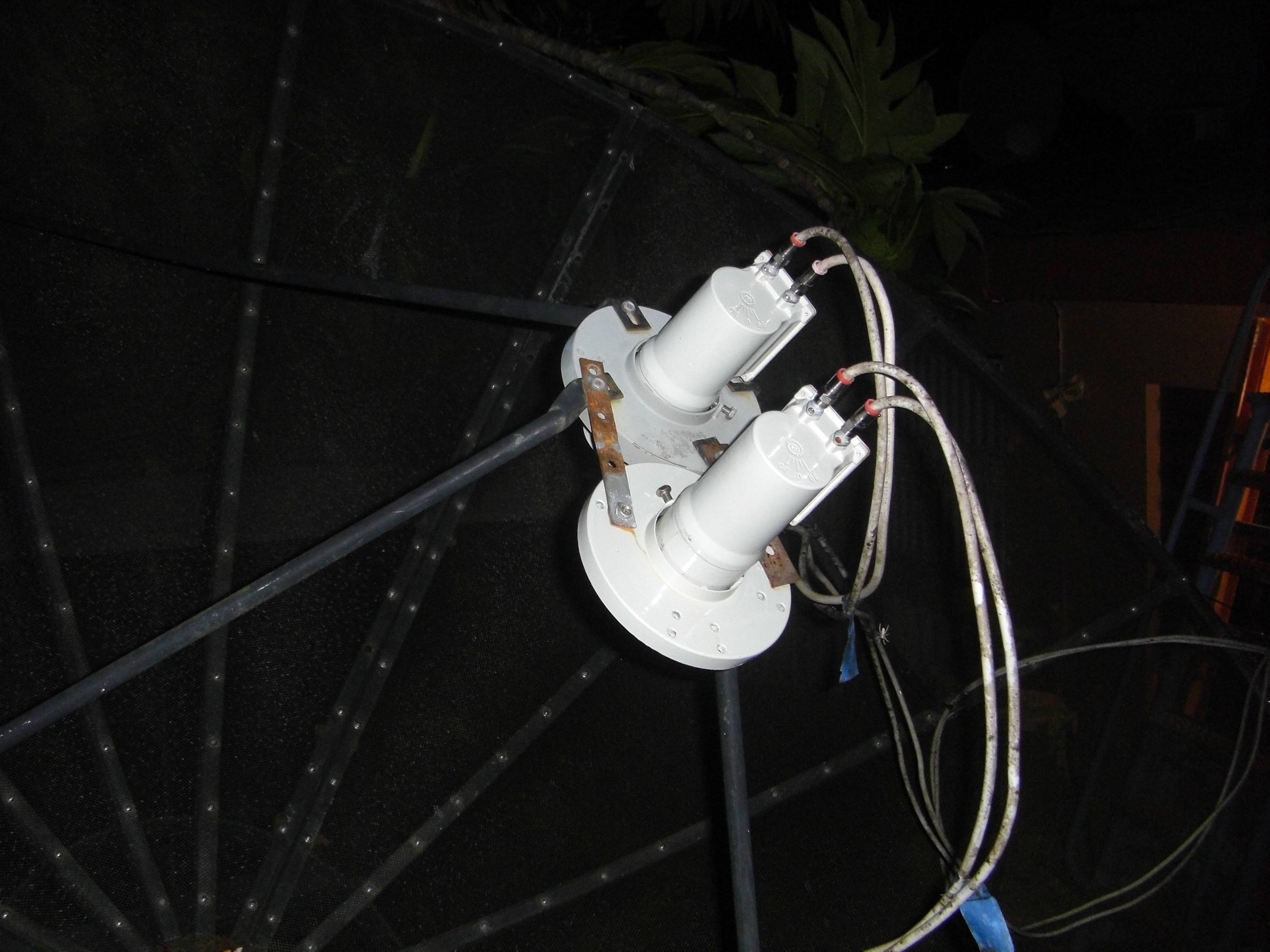

Were the 2 LNBs taped side by side close enough? or you just placed the scalar plates together side y side?? The scalars need to be modify when taping both LNBs together. I have one LNB in the oposite way with the scalar plates side by side and it give me 97W (using 103W as main), so that will be 6 degrees. So I'm assuming that modifying 2 plates so 2 LNBs can be taped together side by side will give me close to the 2 degrees I need to get 105W.
here is a photo of my 103W main with 97W (plates side by side)

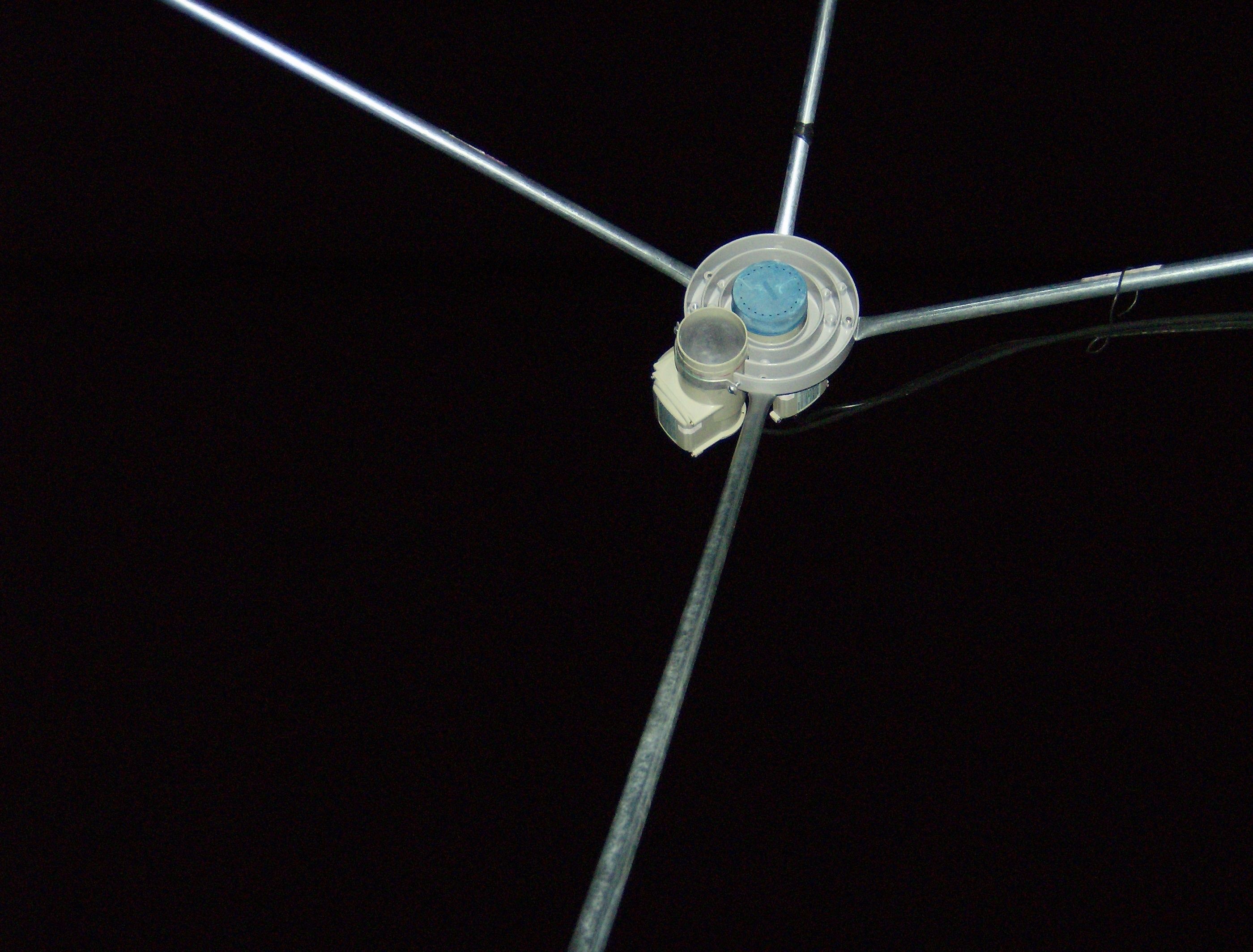

i machined the slot to go just to the other lnb.
I think ice made a mod that actually had the lnbs touching.
here is a pic of the unimesh with it. this LNb came with nice beefy scalars that could take a beating.
Nothing glamorous, just bolted it in and tried it. all attempts to add a scalar to the outer lnb, failed.
you are showing a greater distance then i have with my 97 /103 /107 combo. maybe cause you have a 10'er?
