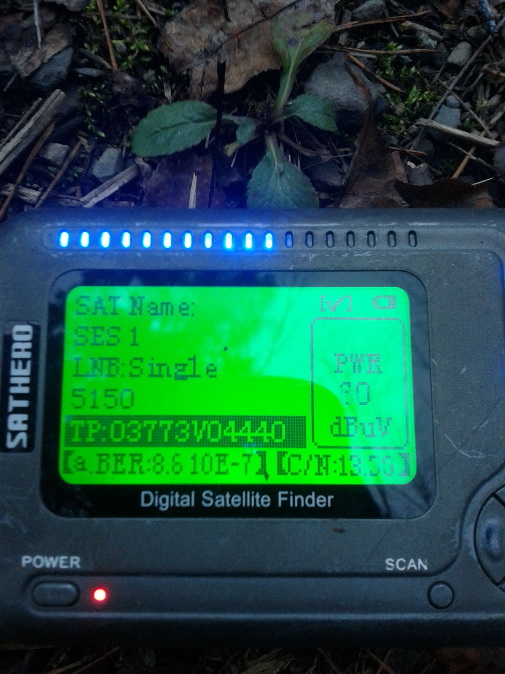

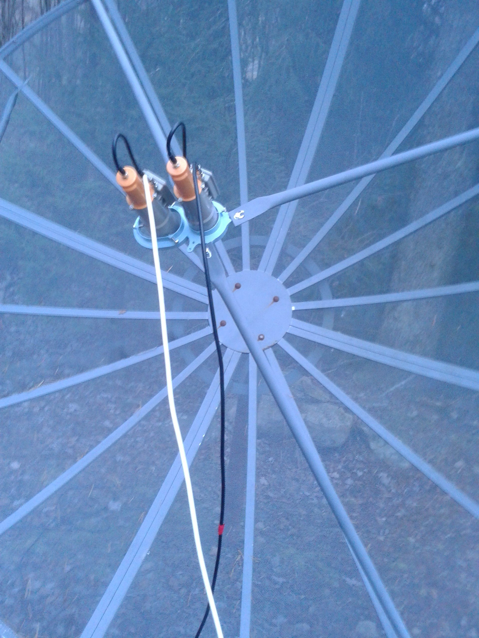

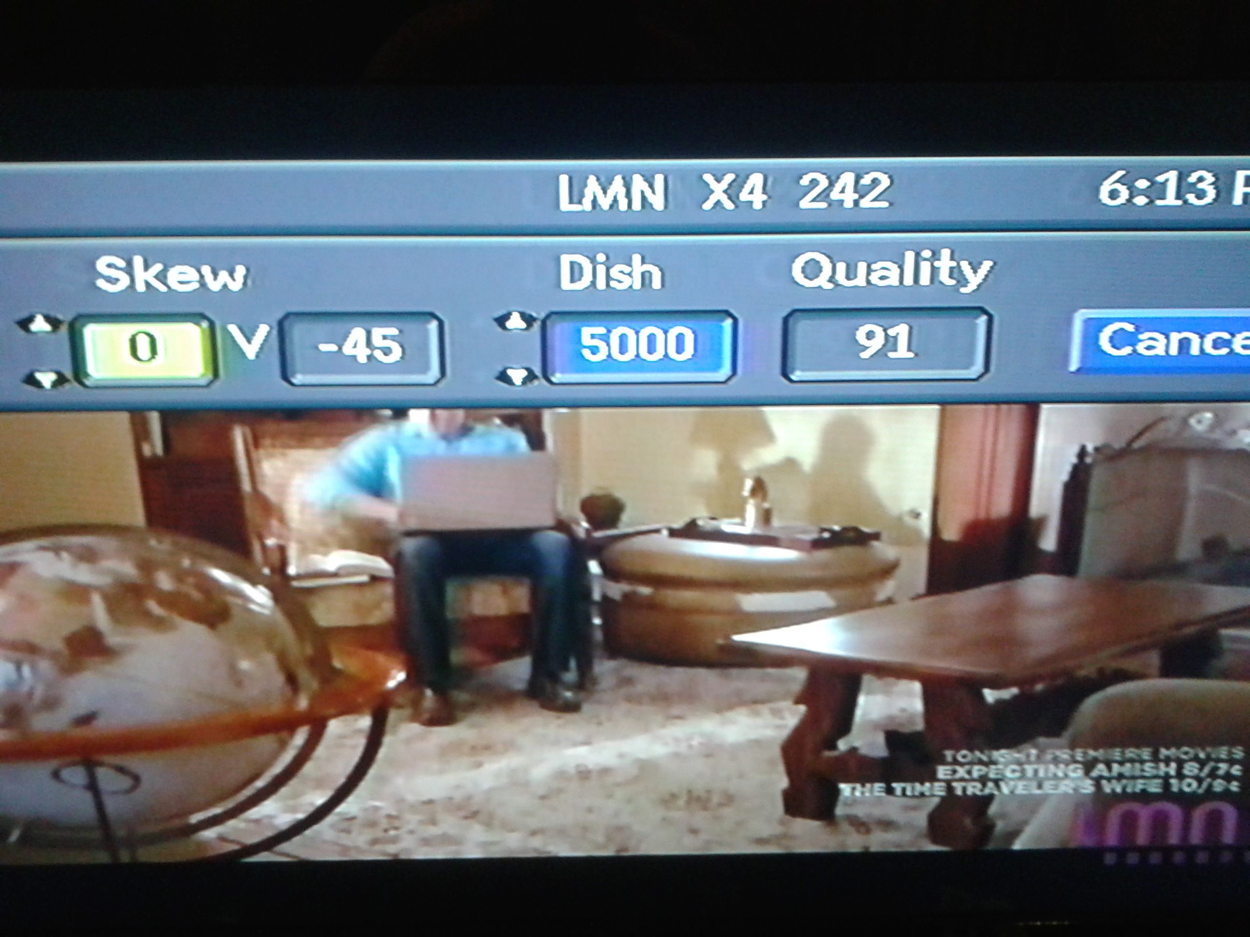

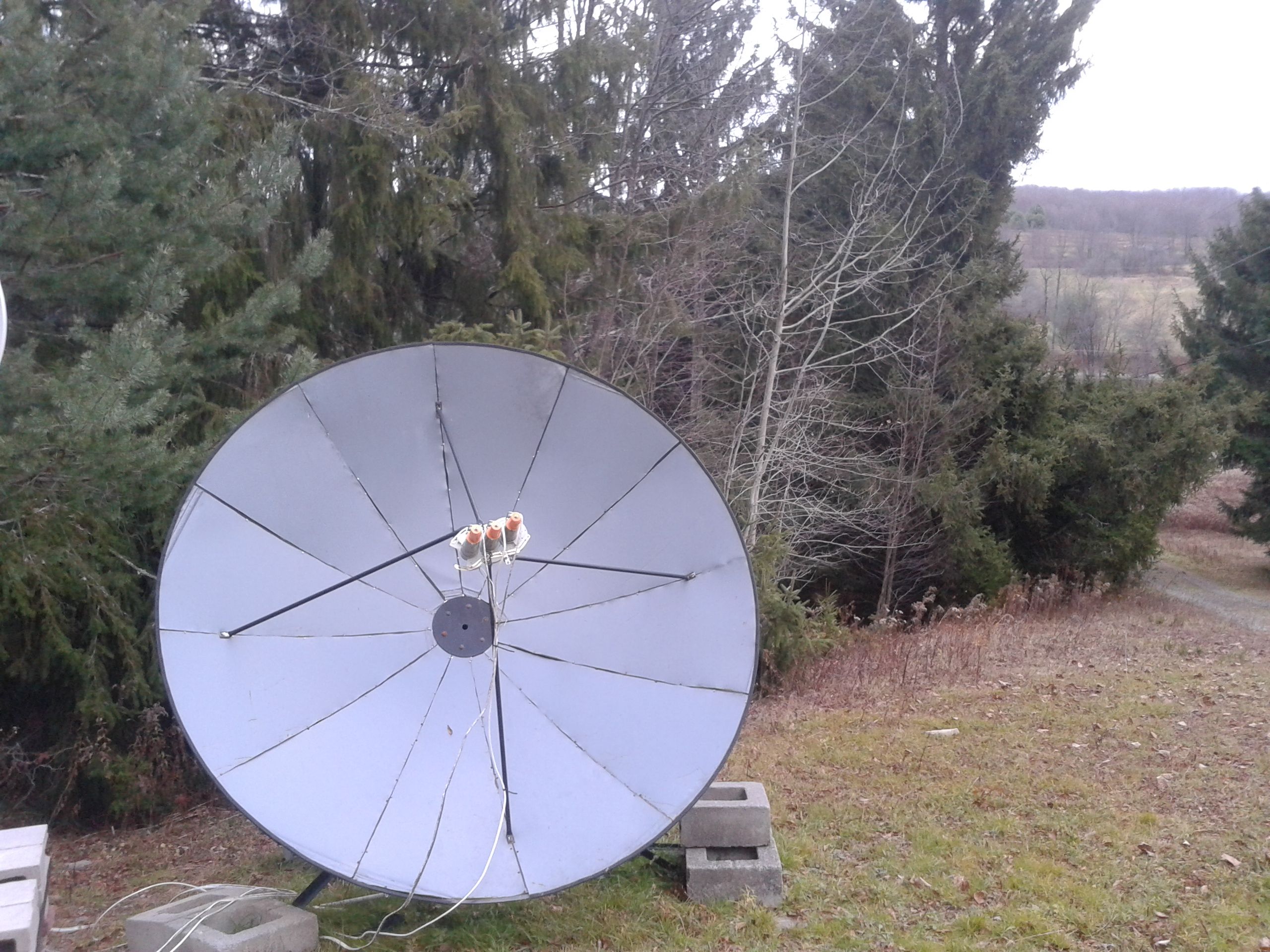

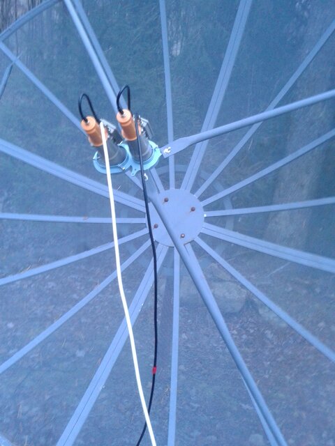

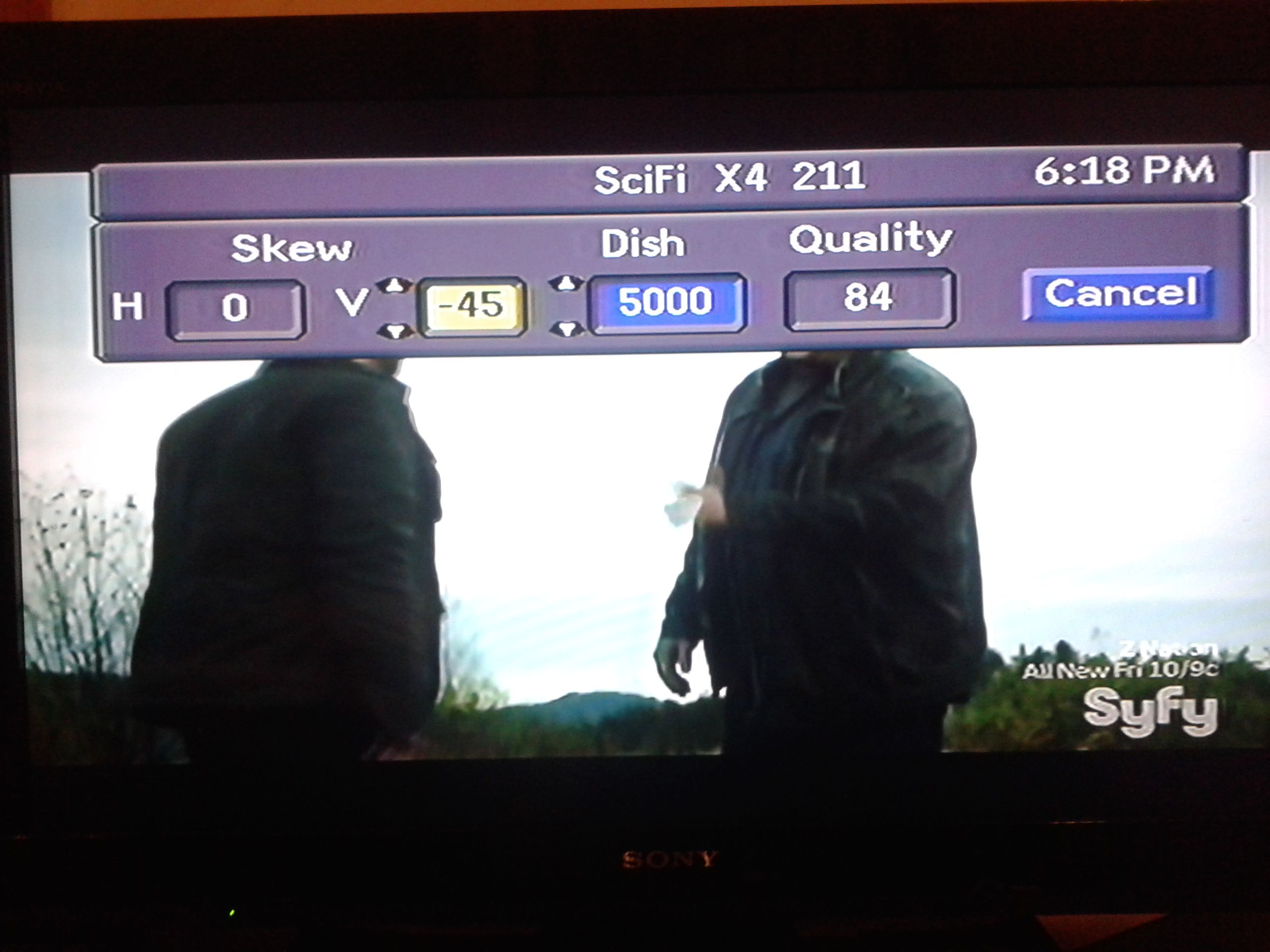

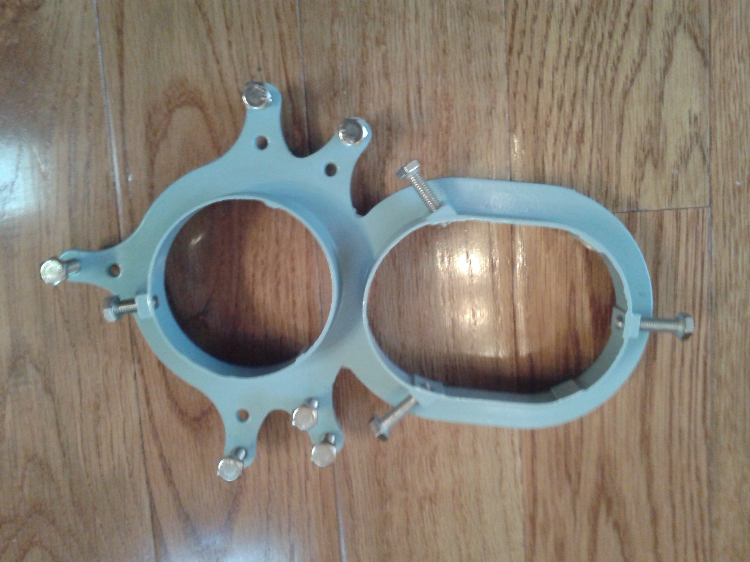

Hello i got a 2 C band holder i bought to try out. I put it on 105 w for dsr 922 and 101 w it works ok its on my 7 1/2 dish.It is cheap made, i paid around $23 for it.I also cut some scalar rings for my old Orbitron dish 8 1/2 mesh panels got damaged a long time ago ,thats why it looks bad lol but it works ok on c band.the one with 3 lnbs are at 99,103,107 with 103 centered.On my scalar support legs i have 4 legs i had to move them in different positions or remove the support leg.Hope this helps.

I guess it's an interesting idea for experimenting. It says for three or four lnb support dishes. I can't see how it would mount on a four lnb support dish. The fourth lnb support leg would come in right where the extra lnb goes. Am I missing something?
Hey fta4pa on a 4 support leg you remove one leg it works better on a 3 support leg and a button hook type.if you do a close up on my picture you will see only 3 legs.hope this helps.
P.s. the leg support position will be awkward.

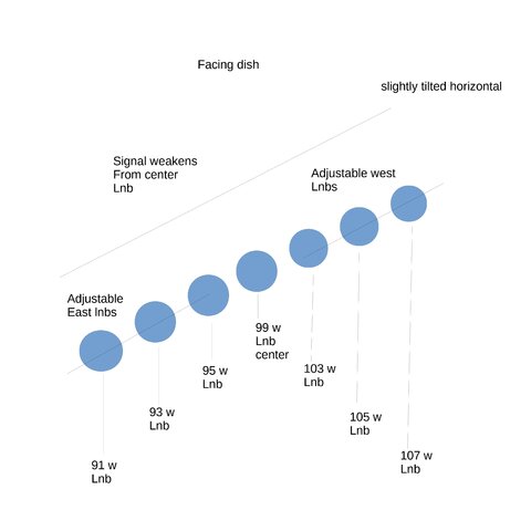

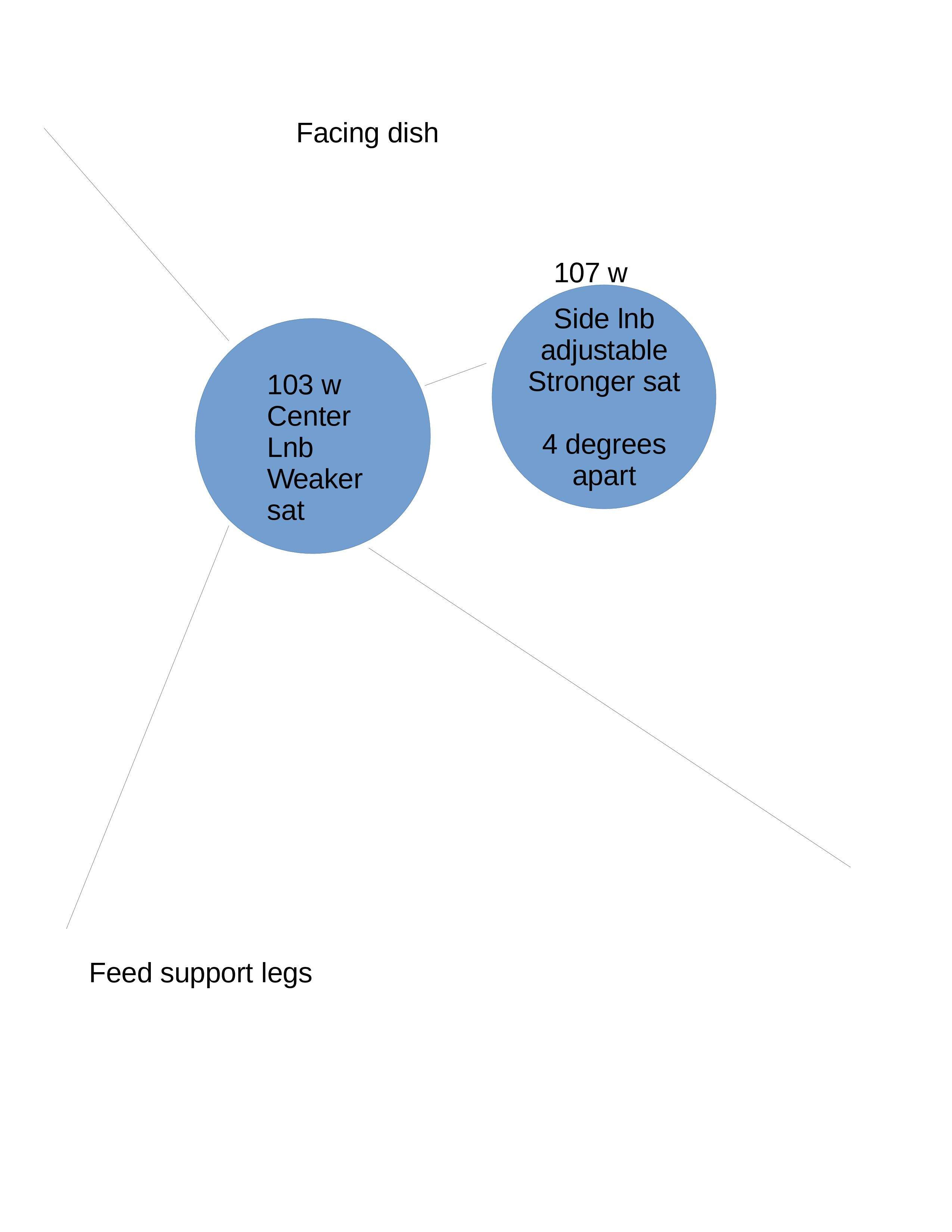

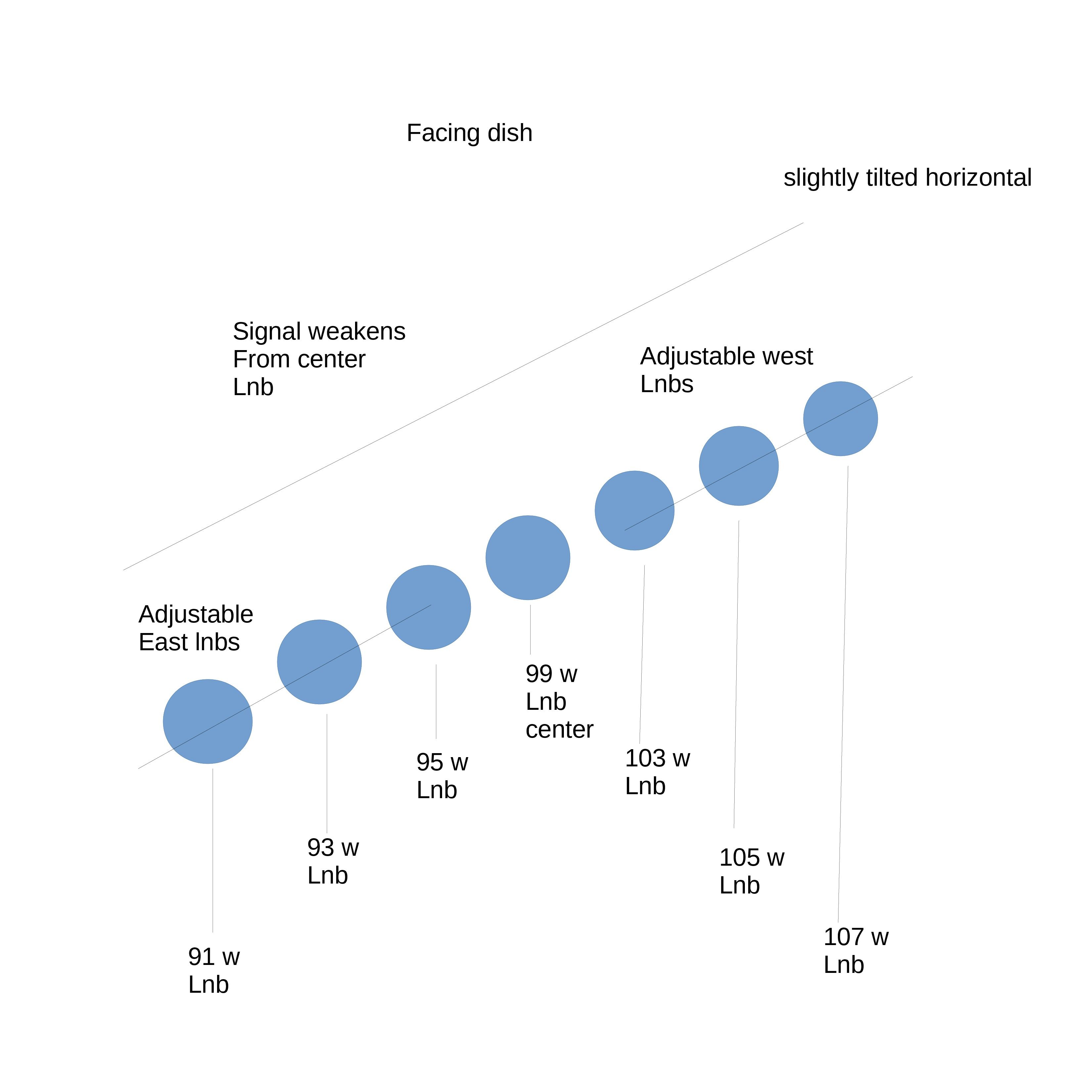

You're welcome just a tip what i do is use a weaker sat as the center and stronger sat at the side.example 103 W centered and 107 W side.I also only go 4 degrees apart which puts the lnbs closer together the further apart from center the weaker the signal gets.good luck and stay warm.lol sorry about drawings
was trying to explain.
