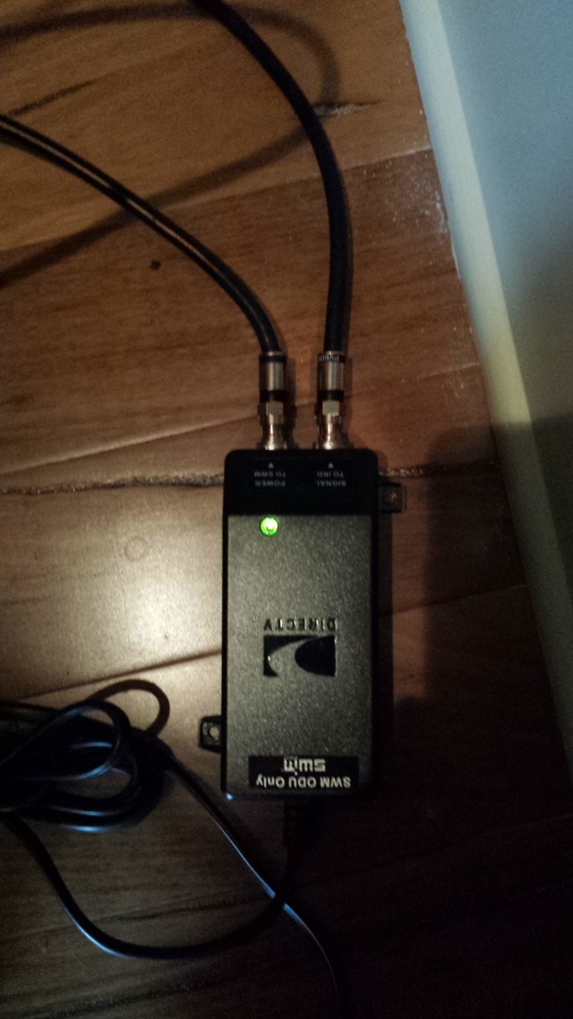

I would like to connect to HD receivers to one line. I currently have a HD34 I would like to connect to a H21 So I can watch 2 football games on 2 TV in the same room..
Here is the connection I have from the wall.
Please let me know if there is something I can do
thank you
Directv SWS splitter.
You need to get a Directv SWS type splitter. That is an SWS2, SWS4, or SWS8 depending on how many future receivers you may want to have.
So I can purchase a SWS type splitter and connect it to the output of this this then connect 2 recievers to this.
got it thank you I will purchase it. Wonder if I can get something at radio shack to work
It is not any ole splitter you can buy anywhere. It is designed specifically for the Directv SWM ( Single Wire Model ) system. This is what you have as evidenced by the picture of the power inserter in your first post. Try Solid Signal, Sadoun, Amazon or Ebay .
