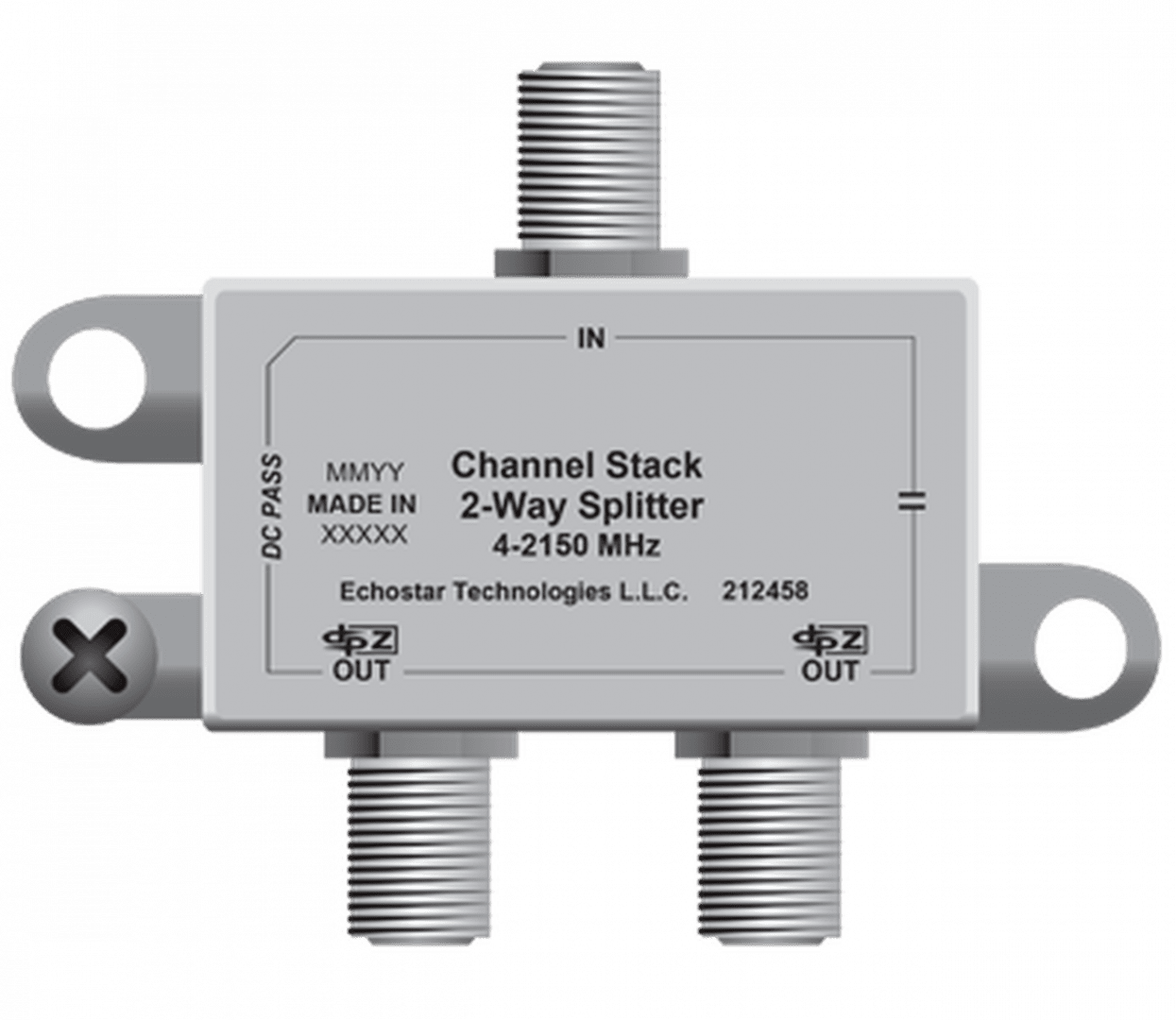

I'm installing 3 Wallies in an RV (no hopper on the system). One home run is going to one jack feeding one Wally, the other 2 receivers will have to be run on one home run due to restrictions inside the RV. Is it possible to use a switch or splitter to feed both Wallys or does each one need to have its own dedicated line back to the 1000.2 LNBF?

For multiple Wally's on one wire you could use a hybrid LNB and Dish channel stack splitters.

Yes. You can have up to 8 Wally's on each leg of a DPH42 or theoretically a hybrid LNB. We've never done more than four Wally's on the LNB only.

Yes but make sure you have a Dish channel stack splitter.

If the channel stack splitter is a DISH separator, I have bunches of them and can mail to you if you wish.
