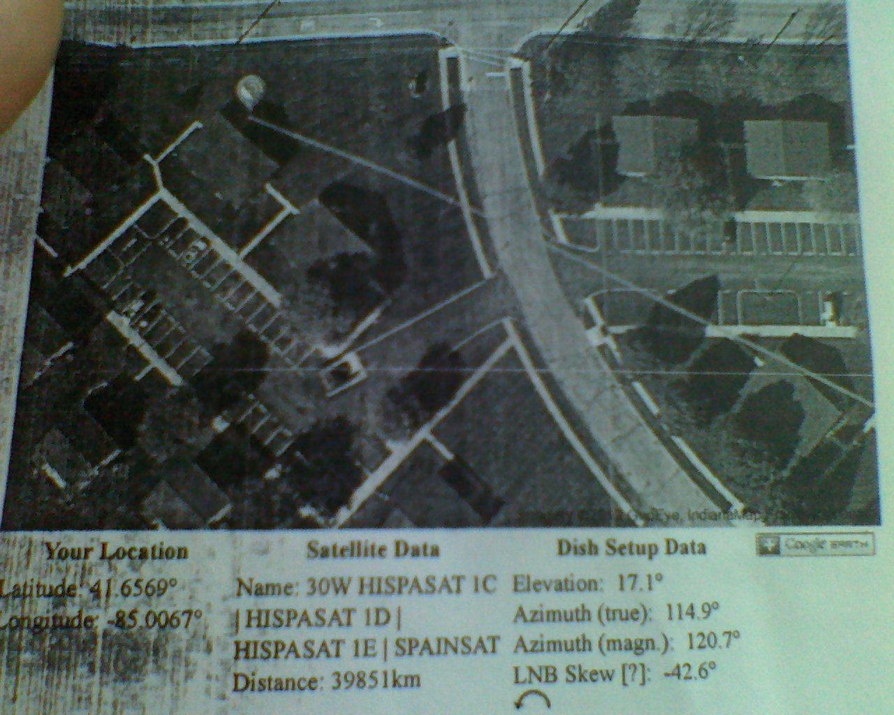

30w
Its cool Borisov I was just using the specs from dishpointer. 30w was a tough one to get had a lot of trouble getting it in but once I got it nailed down to a science marking the placement on the ground.

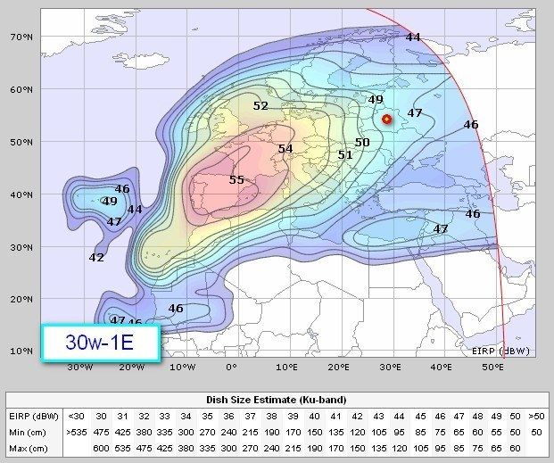

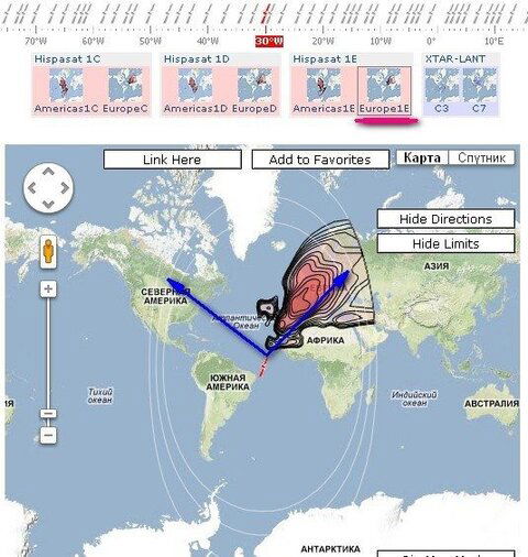

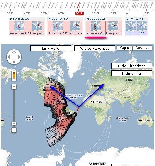

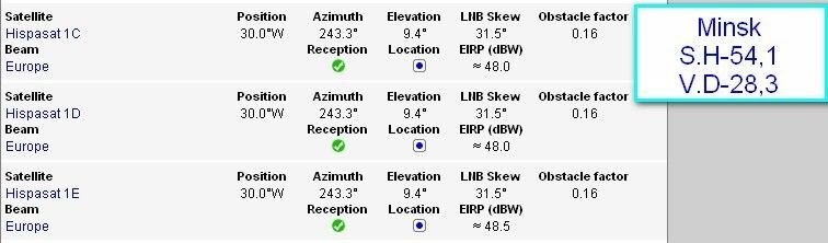

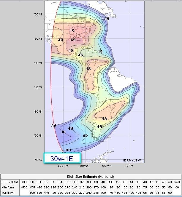

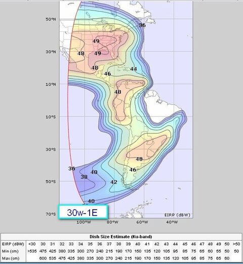

hello.
Please attention.Sputnik Hispasat 1C/1D/1E - 30° W in centre America-Europe.U me such
signal = quality = What signal in North America ???
1.1 meter antenna, receiver Openbox-X-820CI
Hispasat 1C
-11731 V 27500-88%
-11771 H 27500-75%
-12092 V 27500-84%
Hispasat -1D
-11510 V 10000-38%
-11577-11650--50-60%
-12149 V-12591--60-32%
-12705 V 2222-16%
Hispasat -1E
-10730 H 27500-60%
-10890 - 10924--78-82%
-11771 - 11851--84%
-12322 -H-12360-65%

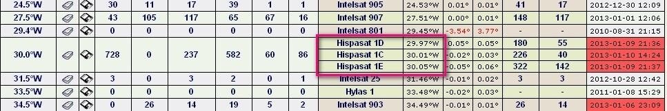

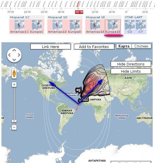

Radar,
Are those all on different satellite/spacecraft or are they just using a different antenna (beam pattern) on the same satellite? I don't have keps for Hispasat 1E. 1A and 1B are very old but for some reason I have keps for them, suppose they are still up there/active?
Just checked 1A and it appears to be slightly elliptical orbit varying in height by about 2000km.. might be difficult to track without Az/El gear...
-C.
These satellites: Hispasat 1C (2000), 1D (2002) and 1E (2010) are each individual satellites in the fleet.
The fleet also includes Amazonas 1 (2004) and 2 (2009), Xtar-Eur (2005) and Spainsat (2006).
Upcoming satellites will include Amazonas 3 (2013) , Hispasat AG1 (2013) and Hispasat 1F (2014)
Hispasat 1A (1992) and 1B (1993) are not listed as being active. End of life reached in 2003.
More information here: http://www.hispasat.com/default.aspx?sectionsId=1&lang=en
