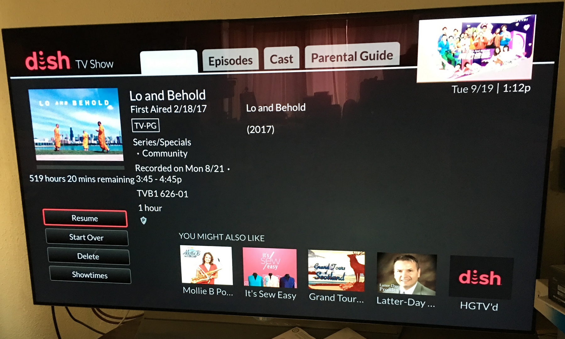

Everything is fine with H362 with the exception of 2 recordings, so I'll describe the issue with visuals... All times are Pacific Daylight Savings Time (GMT -700) and I have already did a power cord reset with the same exact results.
This one #1 was recorded on H358 but did not watch it until H362, before watching it, the info screen did show 1 hour and 30 minutes remaining but this is after watching it, the actual recording is 1 hour and 30 minutes as shown on the right hand side but the left side sure shows a incorrect remaining time:

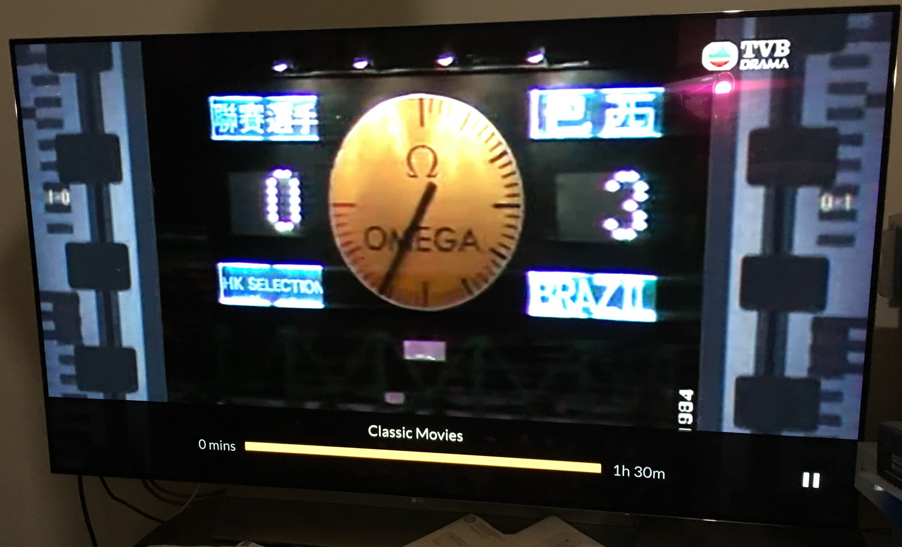

This one #2 was recorded on H362 before watching it, the info screen did show 1 hour and 30 minutes remaining but this is after watching it, the actual recording is 1 hour and 30 minutes as shown on the right hand side but the left side sure shows a incorrect remaining time:
So anyways, the problem is the playback which appears to be okay if I just watched, the replay seems to work but if I try skipping and I had only tried the first 20 minutes, what would happen is it will skip forward but at some point, it will actually go back to somewhere a few minutes before I started the original skip/forward. So for example, I can be at 5 minutes and it will show 7 minutes fine but then it skips back to the 2 minute mark and forward from there.
When I pause the playback, it doesn't show the current position either like it normally does as both recordings show something similar to this:
If I selected Star Over in any of the recordings and immediately pause it as fast as I can do it, it will say 620 hours remaining.

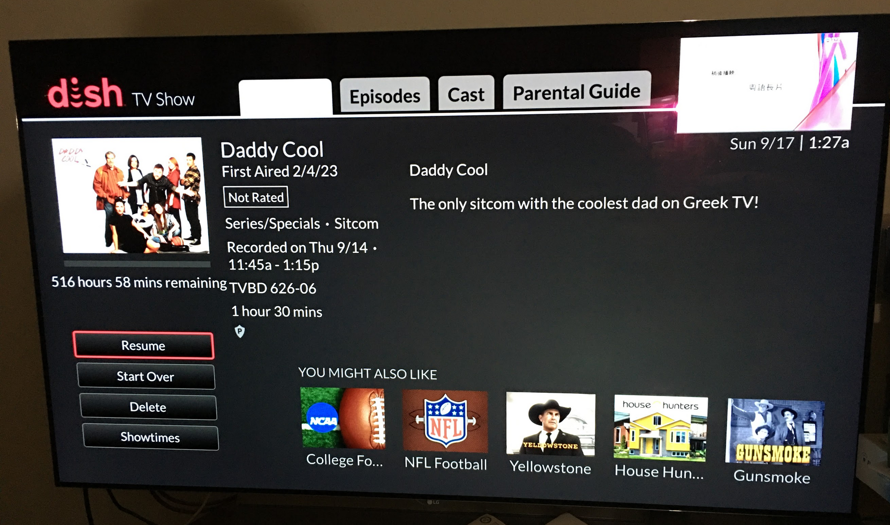

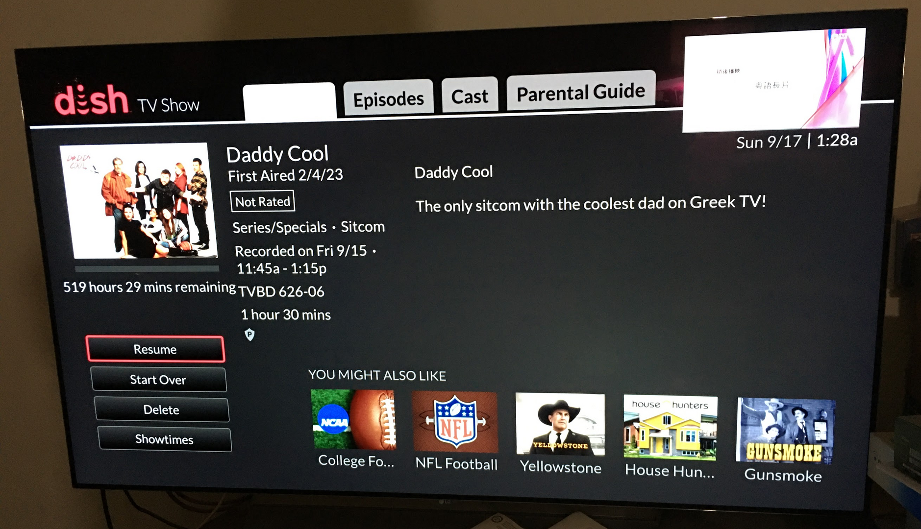

Josh.M - I discovered another one (I am behind in viewing recordings so only will see them when I view the recordings) from August 21, 2023 Pacific Daylight Savings Time which was recorded under 358 that had the same symptoms as above when playing back on 362, this one is on a different channel, different title and the recording is 1 hour instead of 1 hour and 30 minutes but the Hopper 3 will still think the recording is actually 519+ hours and the skip does not work and the current view progress shows 1hr at the end but won't show the current position because somewhere else, it is seeing the recording with the 519+ hours in length. So the same issue might have existed if the playback was done in 358. Not sure what is causing the Hopper 3 to only see some recordings on different channels with lengths that are magnitudes more than the actual recording itself. If you need the receiver number, I can provide it as I will leave the mentioned recordings on the Hopper 3 in case it is needed to help with the diagnosis.
Thanks - I was able to duplicate it in our lab and we're opening it up as a new defect today. Appreciate your report!
Thanks for reporting it as well. One thing that is uncertain is I don't know if that issue existed before 358 or not but I'll stick to the not. There is another issue I have noticed with all software versions, basically the internal HDD of the Hopper 3 is
