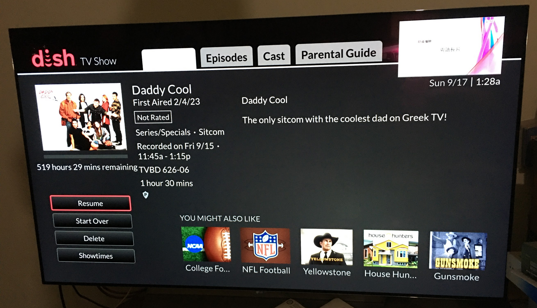

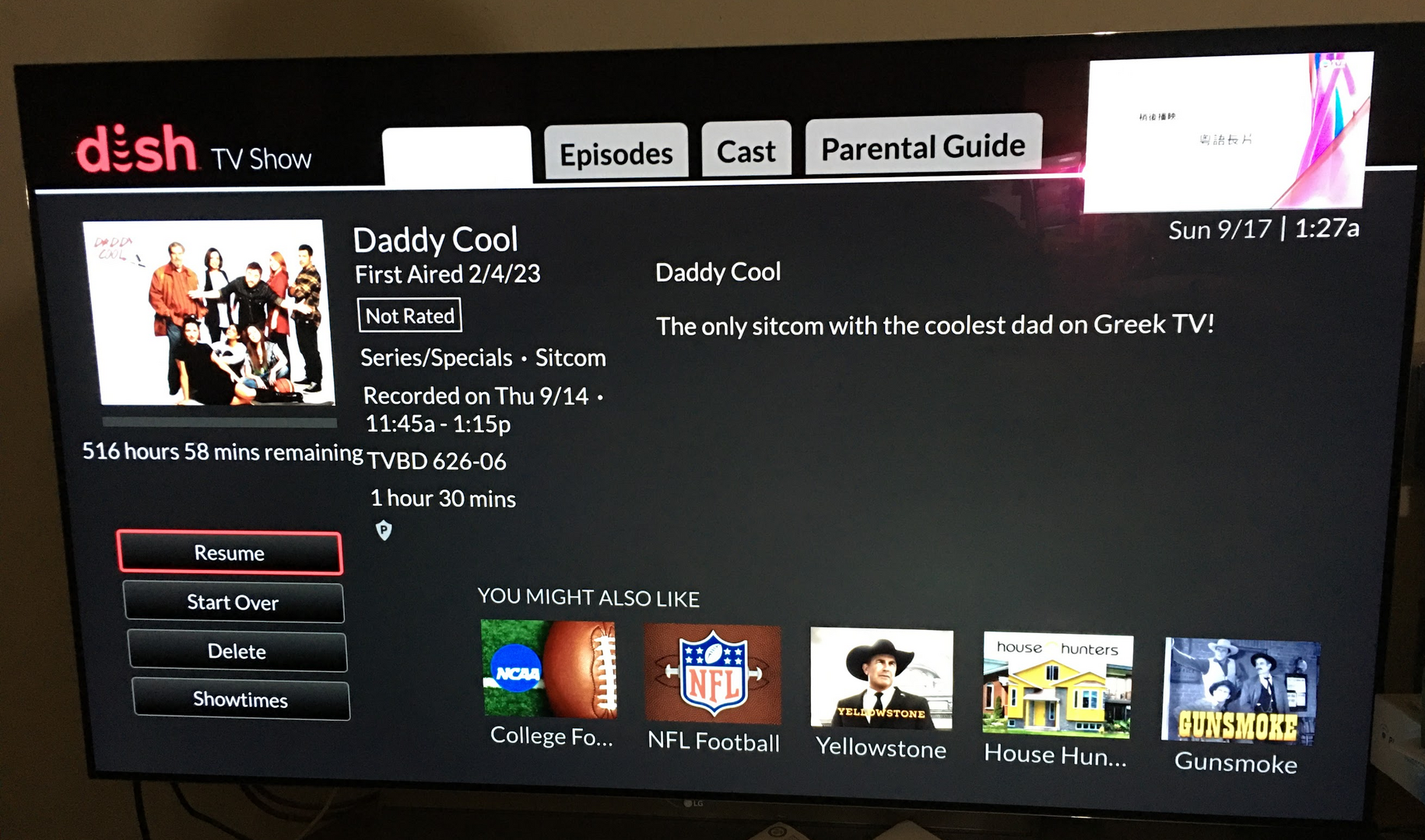

Everything is fine with H362 with the exception of 2 recordings, so I'll describe the issue with visuals... All times are Pacific Daylight Savings Time (GMT -700) and I have already did a power cord reset with the same exact results.
This one #1 was recorded on H358 but did not watch it until H362, before watching it, the info screen did show 1 hour and 30 minutes remaining but this is after watching it, the actual recording is 1 hour and 30 minutes as shown on the right hand side but the left side sure shows a incorrect remaining time:
This one #2 was recorded on H362 before watching it, the info screen did show 1 hour and 30 minutes remaining but this is after watching it, the actual recording is 1 hour and 30 minutes as shown on the right hand side but the left side sure shows a incorrect remaining time:

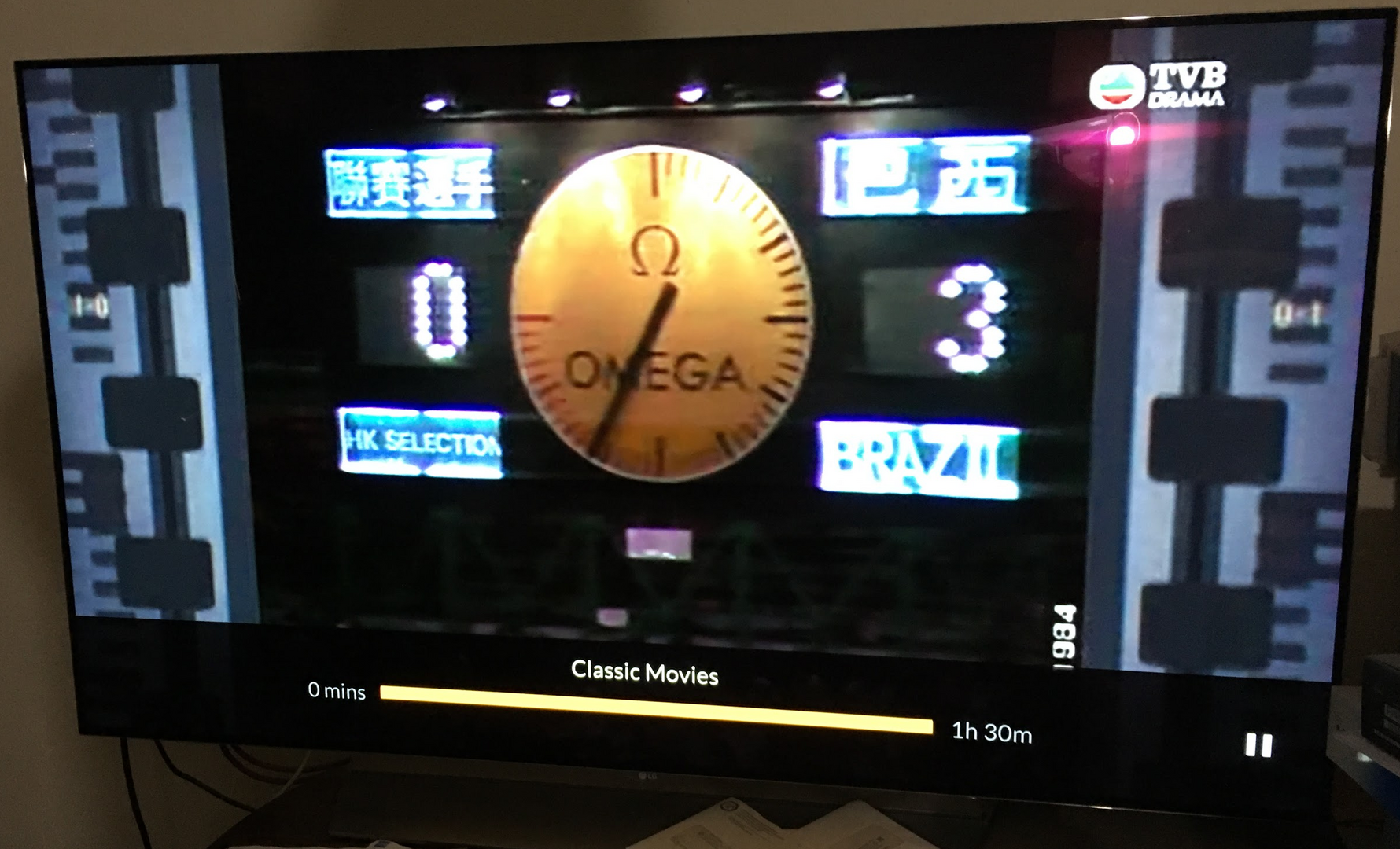

So anyways, the problem is the playback which appears to be okay if I just watched, the replay seems to work but if I try skipping and I had only tried the first 20 minutes, what would happen is it will skip forward but at some point, it will actually go back to somewhere a few minutes before I started the original skip/forward. So for example, I can be at 5 minutes and it will show 7 minutes fine but then it skips back to the 2 minute mark and forward from there.
When I pause the playback, it doesn't show the current position either like it normally does as both recordings show something similar to this:
If I selected Star Over in any of the recordings and immediately pause it as fast as I can do it, it will say 620 hours remaining.
Thank you for the pictures this helps a ton I will add them to the list of defects.

I should note that I record alot as even the same episodes of that show are shown multiple times a day is recorded and the other recorded episodes do not have the problem, seems to be only that specific time on both dates and that same program even though it's not the same episode. Other recordings also d not have the problem. Thanks for the explanation on the Host and Client thing even though Bobby already explained it, but thanks to the both of you.
