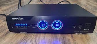

I have my H3 in the battery-backup side of a UPS and it's running 358 as of 8/17/23 when it self updated. I also keep a 4" A/V fan running on it continuously, and a RF temp monitor on top of it to keep track of it's external running temp.
The UPS protects from power blinks (moderate to frequent out here, depending on winds and time of year), and the A/V fan keeps it about 4 degrees cooler than without the fan.
