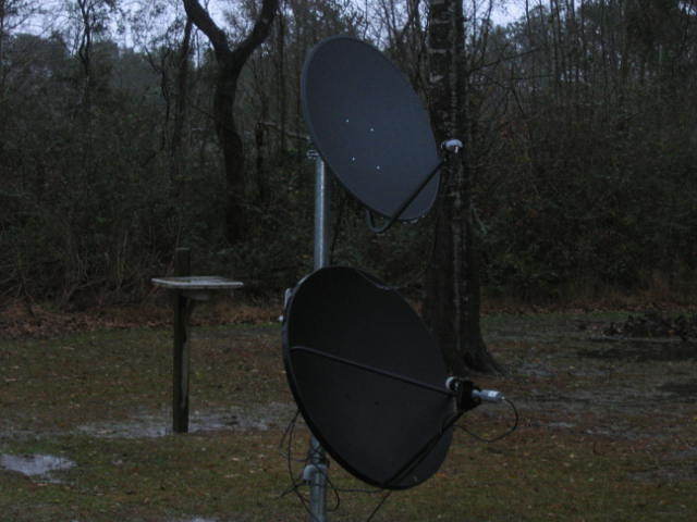

I just put mine up and I cannot get jack for signal quality. Its just above threshold on two different receivers, my coolsat 5000 and My (new) Mercury II. the dish seems to have a HUGE sweet spot elevation wise....it has signal 5 degrees either way up or down....side to side its pretty tight, bandwidth wise. I am using the little SatAv Bullet LNB, but I did check with my BSC-321 Ku LNB that I have and it was no better for quality. No matter the satellite, the best I could do was 70 percent, other than one TP on G10 that was 90. The 1m dish right below it consistantly is in the 90's on every TP that the 90cm is in the 60's on.
I'm stumped. Ideas? Sorry for the pic darkness we had a storm today here....the 90cm is on the top, 1m on the bottom.

Focal distance?? All other specs the same, I think I'd check if the f/d is adjustable or if it can be made so.
If it 'haint that' I would suspect the dish accuracy.
I tried moving the LNB in or out....I could make it worse..but no better. I didn't think to check the flatness, it wasn't damaged when I took it out of the box...:)

without a direct front shot i can't tell but looking at this photo the lnb on the 3ABN dish looks like its off slightly.Don't know if its the arm or lnb bracket. I'm sure you checked to see if the arm was straight. is there any adjustment for the arm without moving the dish??
stogie
check the arm on the dish. I had the same issue. Make sure you are tuned onto a satellite and then try and move the arm itself but leave the dish where it is. I've seen that happen on my GeoSat dish aimed at G10. Best I could get was 50 on the Pansat. Pushed the arm a little bit and BAM 80 :)
Basically move the arm for azimuth but not the dish :)
George, this is my first "store bought" dish so I not sure what "straight" would be! I am so used to the P* dishes this is all new to me. It doesn't look like there is any adjustment, its LNB arm is attached with two bolts pretty rigidly. The sun is supposed to be back tomorrow so I'll have plenty of pics , I promise.
I'll try that tomorrow, but I think I am going to have to disassemble the dish to get to the bolts to loosen them enough to MOVE the arm.

If you did not check the dish for surface accuracy before installing, the description of you signal problems would indicate that the dish was clam-shelled in transit. It is almost impossible to "SEE", but the performance would be exactly as described. We suggest to GEOSATpro 90cm customers that prior to assembly, lay the reflector face down on a perfectly flat surface (I.E. glass table) and verify that all edges lay perfectly flat. See GEOSATpro Dish Warp

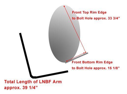

I agree, in the photo, the arm appears to to not be positioned correctly. Take a measurement on the arm and LNBF placement as shown in attachment and also side to side, but don't bend the arm unless it is not in the correct spot. We understood that the 3ABN dish had two side support arms for the LNBF arm, but your dish does not appear to have them.
Two reasons that we added the side support arms on the GEOSATpro 90cm dish was to support heavier LNBFs (QPH-031 or Monoblocks) and to provide correct placement of the LNBF.

Brian this is a GeosatPro dish. In fact the whole package is from y'all. I bought it from a guy here on Satelliteguys, its the standard motorized Mercury II/motorized 90cm package, still sealed up. There are no side arms so it must be before y'all changed to them. I will de-mount the package tomorrow and check the dish as you suggested. Thanks for the info. :up

Does the LNBF arm have a horizontal hole near the LNBF mount? If so, arms should have been included.
If no hole exists and you wish to add the arms, we can supply either the side arms or include a new LNBF arm as well. $12 plus shipping for the upgrade parts.

That is that same dish (from SatelliteAV) that I installed in Brooklyn last year. The one my friend ordered was clamshelled (although the box was in perfect condition), but it was easy to "pop" it back into proper position. After that, there were no problems acquiring a good signal :)
Its fixed. It was clamshelled. I took it off and laid it on my back porch...it rocked like a rocking chair. :eek:
Did the little pop out procedure....got rewarded with a nice POP, and a flat dish. :D

The Azimuth opened up some. The elevation is still about the same, I found that because the Mercury II's signal meter is so spastic I was having a hard time zeroing it in. Once I hooked my Coolsat 5000 to it, it was real easy to zero in just so. So far I am happy with it. :up
