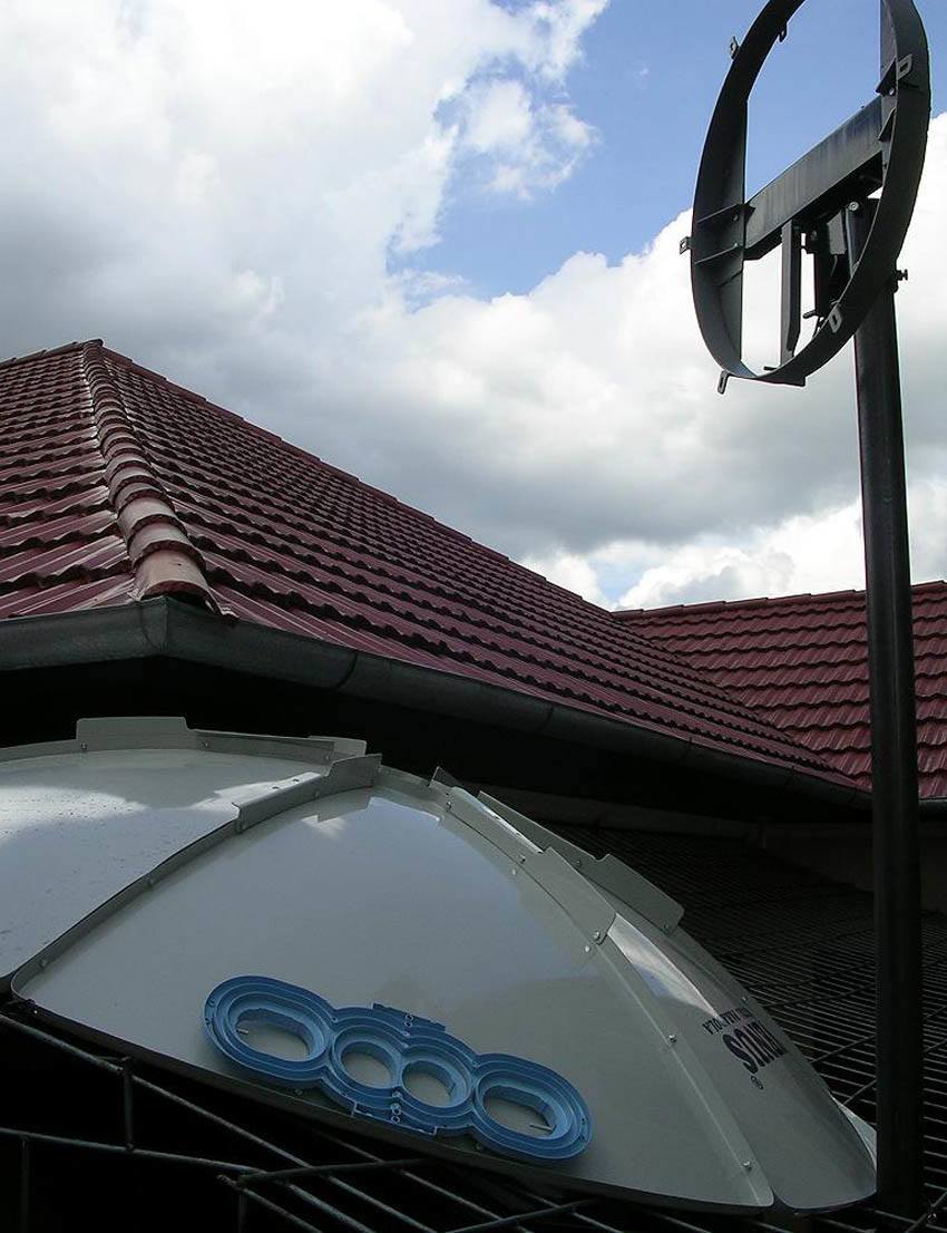

can you post a picture of the way its setup now and receiving both sats.
there are brackets out there already made but they have to be setup for the satellites you want to tune so its not much better than the way i think you have it now. but with a picture we would have a better guess.
i currently can only locate a photo of one of the brackets , i haven't located a seller , these brackets seem to be popular in africa. but i would like one.
this one is for a prime focus dish
the second bracket is one you can use with an offset dish but don't know if the holder will support 65mm looks like it supports 40mm
