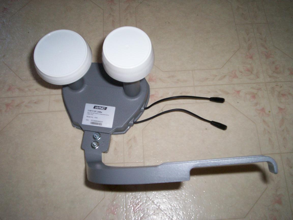

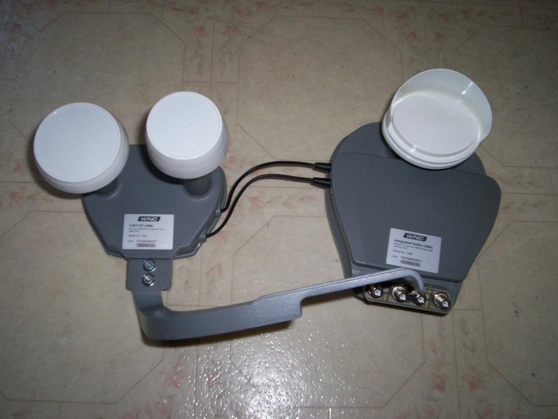

4?
Both LNBs united via 2 mini coax cables, like the ones i have attrached here. What most people don't know is that you don't need an external multi switch like alot of dealers try to sell along with the AT9. They say that is needed to have more then one receiver. Only if you plan to have more then 4 receivers, then you would need the 6x8 switch. Other than that, These 5-LNB dish has 4 outputs.
