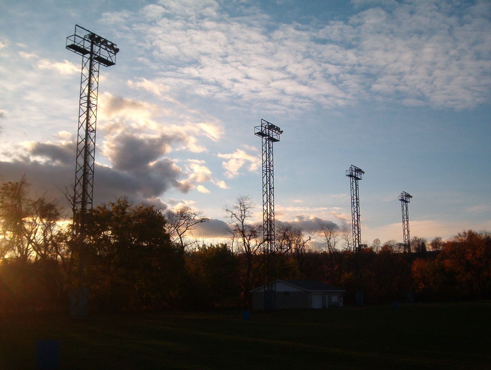

for the naysayers out there, im president of our midget football program for 2006-07 and we are re lighting our field, 40 foot 4 inch poles with 5 hubbell sportslighters per pole, these things weigh 42 lbs each and are 22 inches across, guess how far the concrete base goes down.................................... 6.5 feet!!!!! and only 12 inches around, and that was certified by an electrical architect. we are also getting "pro style goal posts", the pro style is cantilevered forward, and they only have to be in the ground 7 feet and 24 inches around
so you all are worried that a 4 foot pole mounted 2 feet in the earth standing 4 to 6 feet tall is going to move??
IF the pic took these are our south towers, 75 feet tall , 6 feet square the bases are 10 feet square, 15 feet deep. the birds nests on these are 20 feet wide and 6 feet deep.
by the way guys this is donora pa's historic LEGION FIELD. never heard of it?? bet you have. this is joe montanas home high school field, ken griffey sr, stan muscial, arnold galliffa (all american) , bimbo cecconi (all american) also played here.
