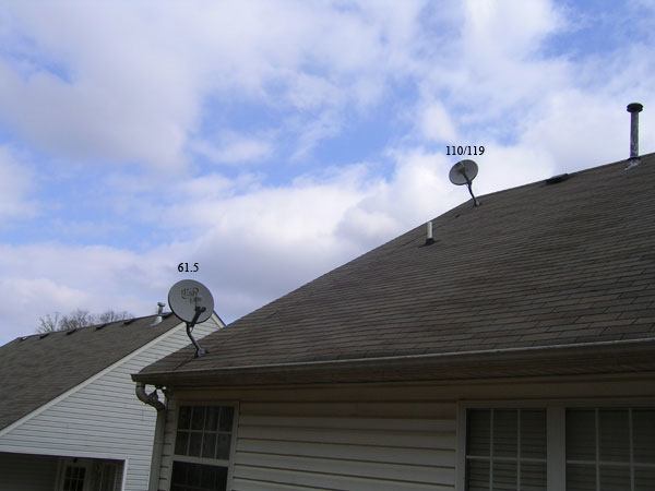

I turned my 61.5 dish in an attempt to receive 129. There was enough signal on the meter to locate and peak the dish but it was too weak for any of my receivers to lock on. Trees are the problem for me and will be for many others in this area. I sent the following email to ceo@echostar.com and I would urge those of you in the Atlanta area with 129 issues to do the same. I hope it will enlighten them of the tree issues we have in this area. Due to it's size I did not include the photo in this message that accompanied the email.

I took some dead or dying pines down (darn pine beetles!) this past couple of weeks. While checking out my work, I noticed that my Dish 1000 is actually pointing right at the only really tall trees on my property. I would estimate them being about 70-80 feet high, and being sweet gums and oaks, they can reach up to 120 feet high. Right now with the leaves off, I'm not having too much of an issue with reception of 129, but in a few weeks when those trees start leafing out completely I fear I will have problems.
I guess we shall see many more problems in our area by the end of April due to the leaves breaking out. I've got my fingers crossed... :(
