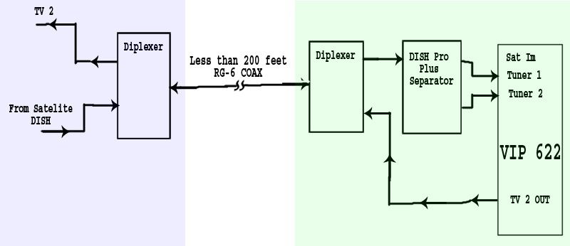

Right now I have five different rooms all homerun with coax to where the dish is outside. If I'm getting this correctly my setup will be:
One coax from outside at the dish to the VIP 622 in the basement. This one coax will contain both Dish tuners (and not the OTA tuner) where they will hit a seperator? right before entering the receiver to split both tuners. And then from the "Home Distribution" output of the 622 there will be another small coax going back into the seperator? so the SD signal from the second tuner can be backfed onto the original coax back to the dish.
Now back at the dish where the other four coaxs (from the other rooms in the house) meet up will I be able to use a splitter to feed one or two other tvs with the TV2 SD tuner of the 622? I understand that I won't be able to get HD or OTA HD on the tv(s) but will still be able to watch 480I or recorded material (HD will be downcoverted) on the tv. But how will this connection work outside at the dish to tie in these tvs with the original backfed coax going to the basement. I hope I'm not confusing anyone too much.
If this is correct so then I don't need to run another Coax from the dish outside to the VIP622 in the basement? (unless I want to use one for an OTA antenna outside which right now I'll just use a set of bunny ears inside)
Thanks again for all of the help!
The installer would use a pair of Diplexer's and run tv2 back up the incomng coax that feeds the vip 622.

Wow, that's nice. Thanks too. I have my install this weekend and that would work for me too.
