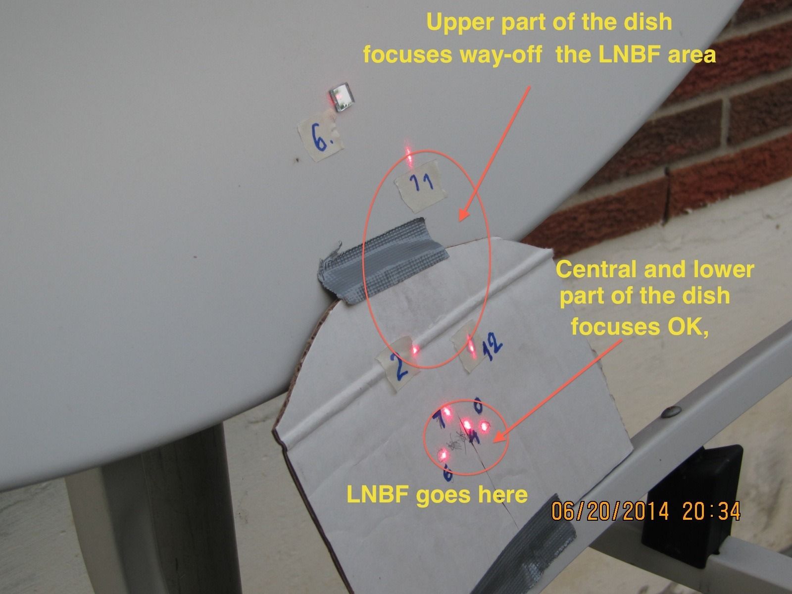

I bought the Wavefrontier 90 quite a long time ago, really cheap, as it was offered without LNBF holders and it had its top badly bent. I straightened the top, but the dish did not perform well, as the Q was below expectations. The string test was OK, so, more "digging" was needed to find, why?

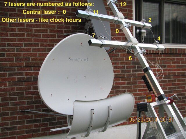

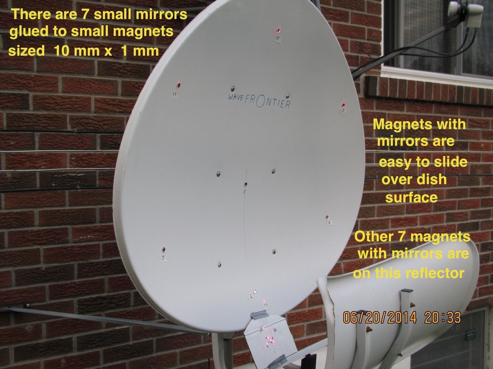

As the small mirrors test is dependent on Sun's presence, and the Sun moves constantly, testing a dish with double reflector is not easy.

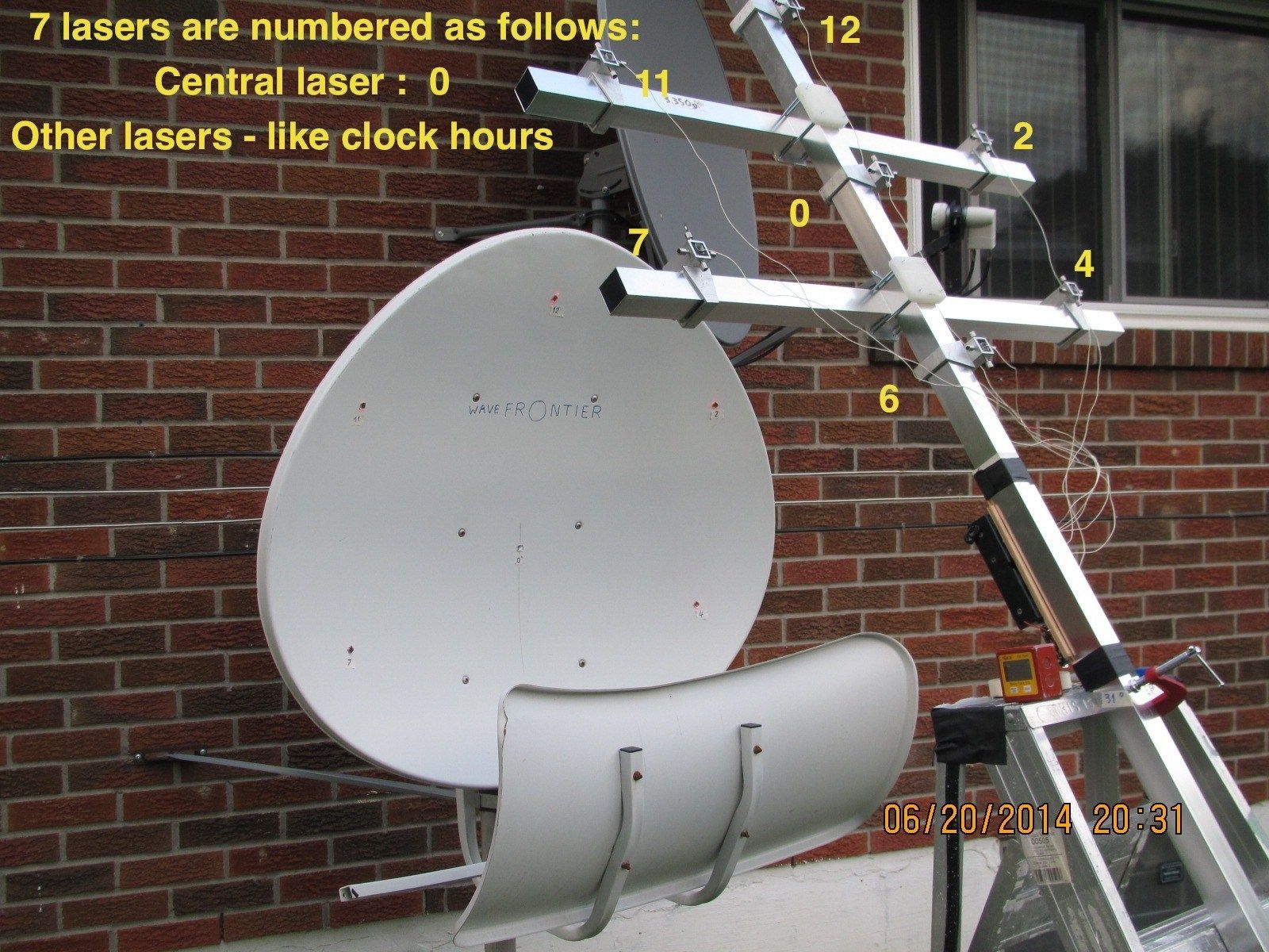

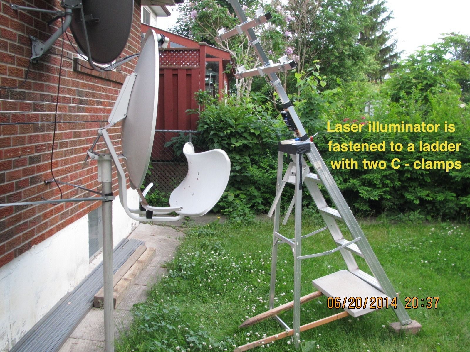

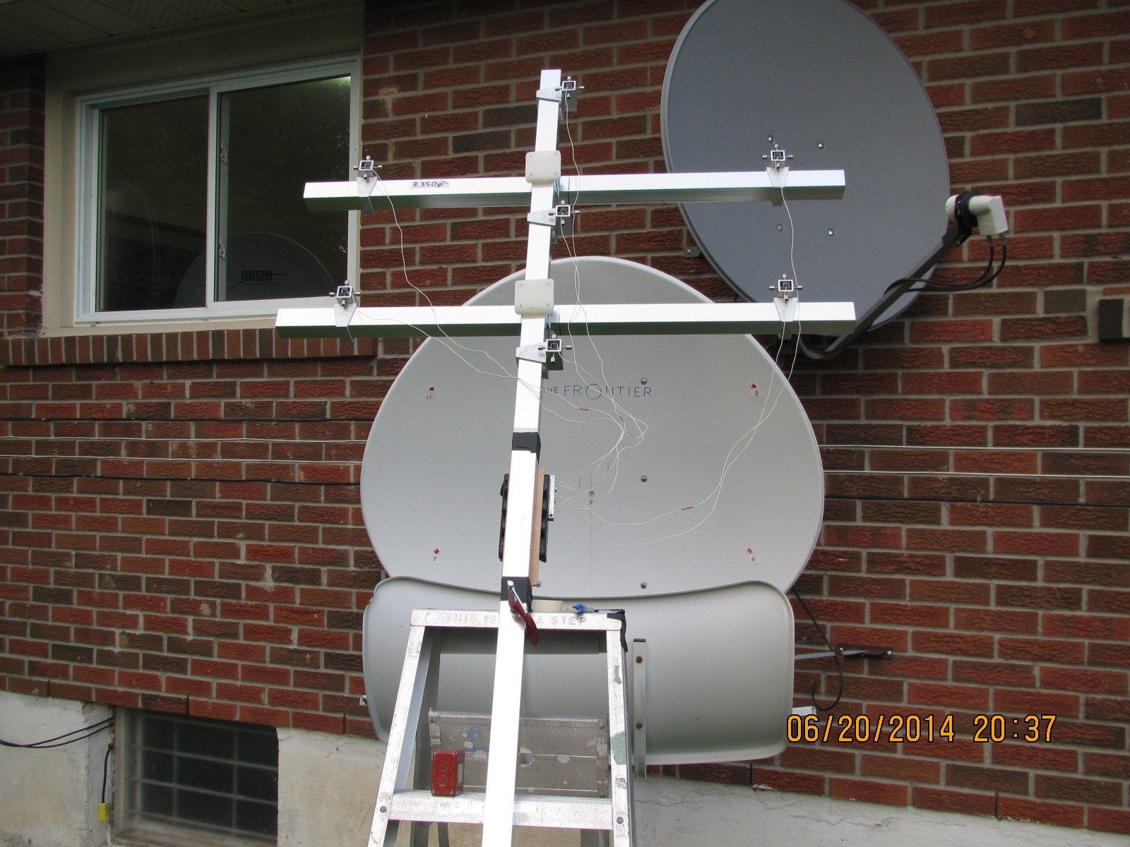

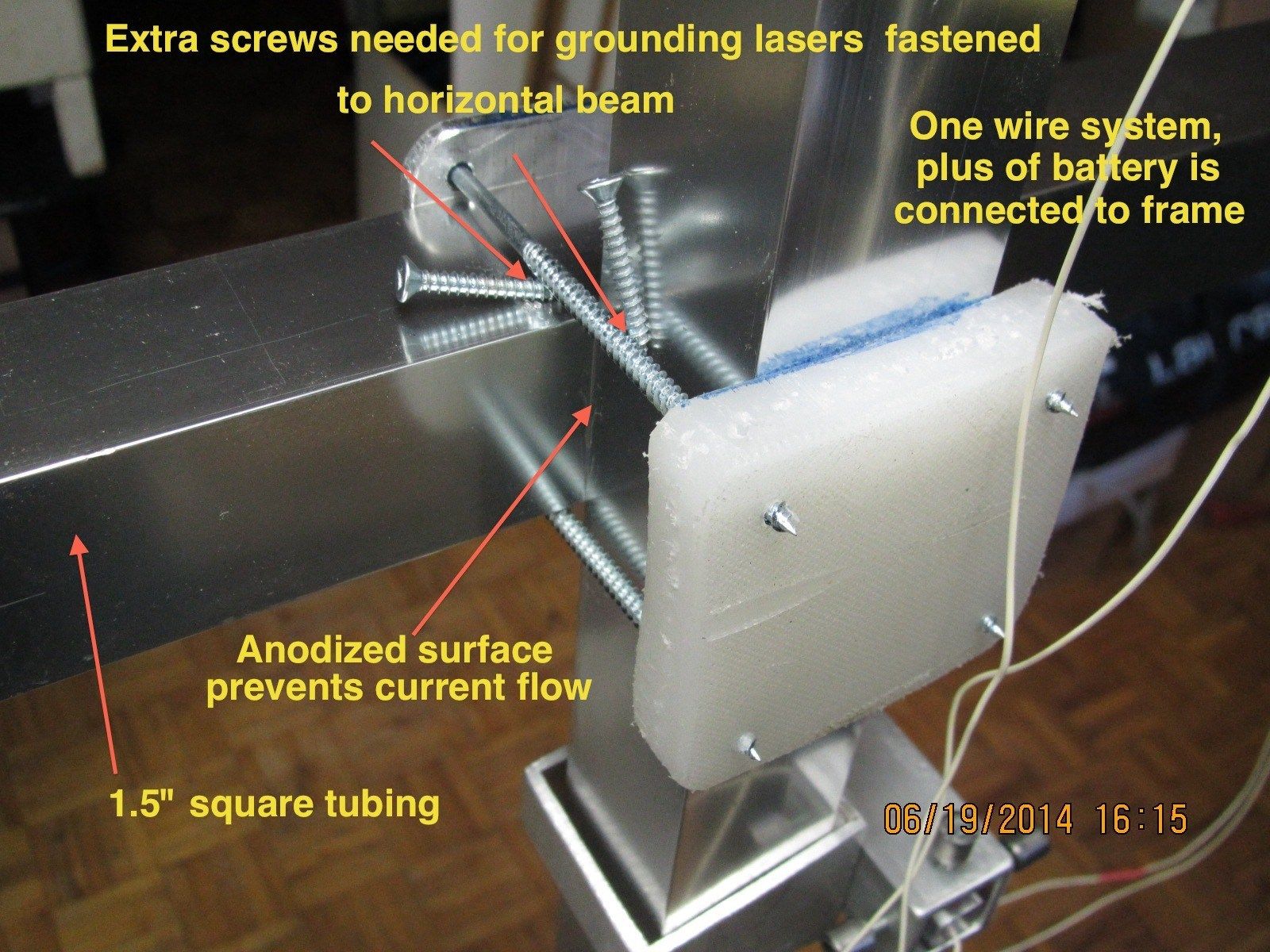

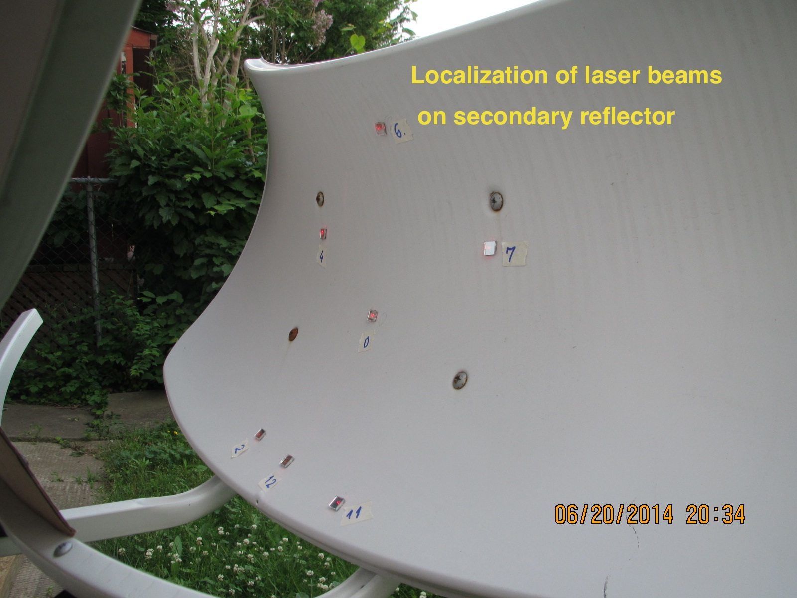

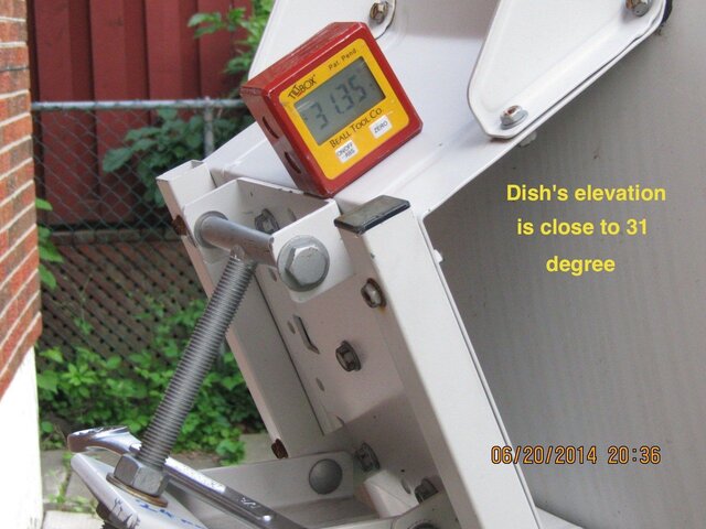

Therefore I got this idea to build a laser illuminator. And, after test, it is clear that not only the top, but also all upper part of the dish is distorted.
Annotated pictures follow.

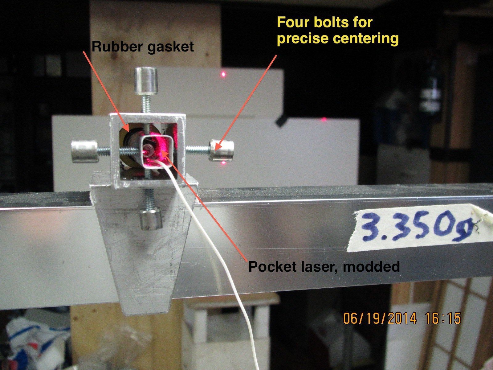

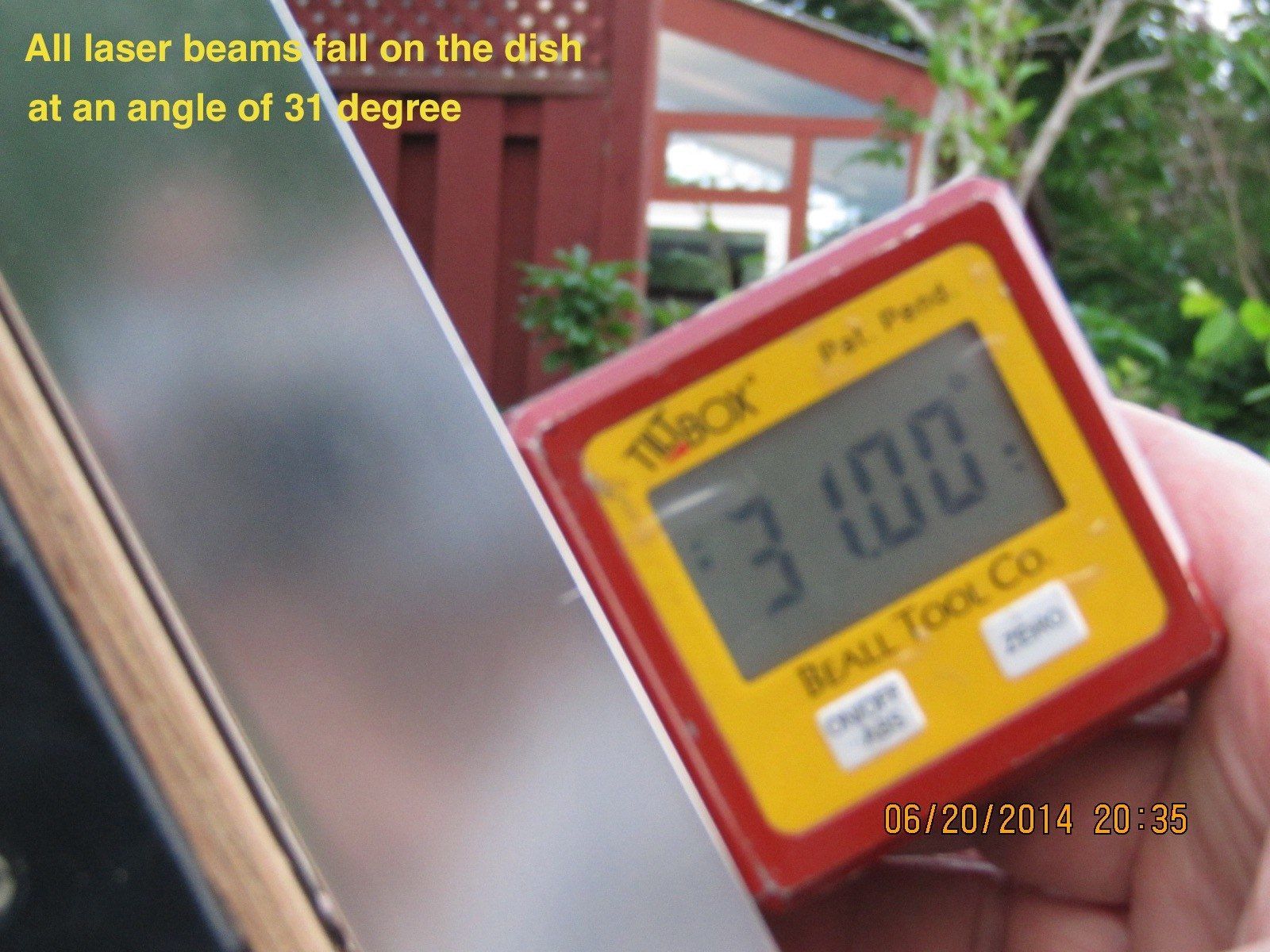

The beams are parallel; I used sort of a "mask" (two pieces of cardboard, joined with duct tape) placed close to the lasers, and marked the laser spots. Next, moved the "mask" 170 cm away, and, using 4 screws on each laser, brought the beams to shine on the marked spots.
With such a distance, one degree spans 3 cm, and I was able to point the beams with better than 0.3 cm accuracy, therefore the beams are parallel with error of 0.1 degree,
I like to cut corners and simplify, but parallel beams was crucial for this project.
More error was introduced by these tiny rare-earth magnets, (I bought them from e-bay, one hundred cost me about 12 bucks),
as some of them are not exactly parallel - or, maybe the double - sided tape attaching mirrors to them, was not evenly thick?

Sorry for delay in reply. Yes, I would like to modify the dish so it could be returned to service. However, more tests are needed. Of my seven lasers, five have been damaged by rain, only 2 work. I am not sure, how to "pop" the top of the dish.
Another thing which confuses me, is the fact, that this dish passed very well the 2 - string test - the strings barely touched each other. Months ago, there was a post by other member, Rima from Latvia, where he reported the same dish tested with 2 strings - the strings were 2 cm apart (!) - yet he was able to receive many satellites. The edges of primary reflector of this dish seem to belong to a plane, not to a curved surface, what is the case with internet Blueberry dish.
