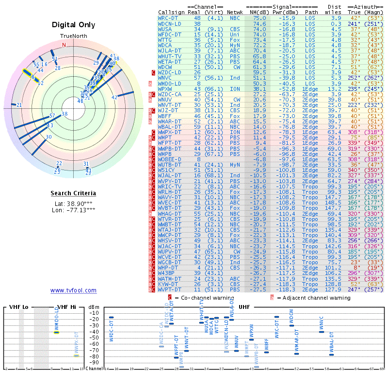

The antennas should spaced about 4 feet apart to avoid interfering with each other. I recommend the Channel Master 7777 pre-amp to combine the 2 antennas and amplify your weak signals. This should provide enough signal to split around 4 times. If you are only running 1 TV and less than 100 feet of cable, you may get by without a pre-amp. A low cost UVSJ (3.99 plus shipping) can be used to combine the 2 antennas onto 1 downlead cable.
I cannot use an amp with my setup because of all the strong local channels. Even without an amp, just about everything within 70 miles is receivable. Everything down to WUTB-DT, except for 1 channel is reliable 24/7.
