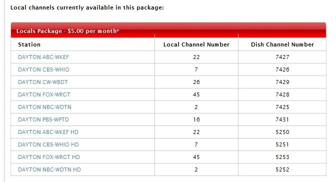

Go here, https://customersupport.dishnetwork.com/customernetqual/prepAddress.do, and input your full address information. If your locals are available from Dish in digital/HD, it will look similar to this:

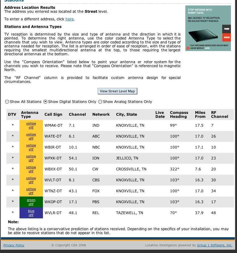

If i did want to get all the local DT channels, according to the antennaweb recommendation it states I should get a "Yellow" antenna ?? (see screen shot below).
I don't know what a "yellow" antenna means anymore, i.e. small, medium, large, etc, but being only 17 miles away, it shouldn't be too difficult to pick them up. I'd be tempted to try a simple indoor antenna first (at 17 miles, you should not need an amplified one). Go to Wal-Mart or someplace convenient and keep your receipt so you can return it if necessary.
Click on the button for "Street level map" and it will show you which way to point the antenna (unless you know what direction 100' is).
Your local NBC is on VHF though, so you'll need a UHF/VHF antenna. So is WMAK, in case you want to pick it up...
I would stay away from RCA and Terk. Both are pretty crappy brands of antenna. Also, I had purchased a MetroStar, but cannot tell you if it worked well, as the F connector broke on it when I first connected the cable!
Your big problem is that you have 2 stations broadcasting in VHF, albeit "hi" VHF, 7 and 10. A UHF bowtie like the Antenna Direct DB2/DB4 or Channel Master 4220/4221 have a good chance of picking up channel 10 from only 17 miles away. But, 7 may be a problem.
I recommend buying one of the models I listed above. Buy it locally or from Amazon with its liberal return policy, so it's easy to return if it doesn't work. Just make sure it is aimed at 100deg magnetic using a compass, as that is where most of your stations are. (WBXX is in a different direction. But, it is so close you should be able to pick it up with a gum wrapper.)
