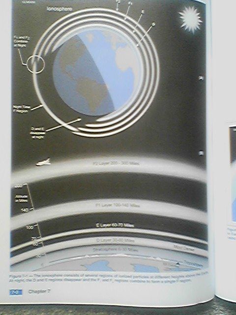

Their are two low ionospheric layers that are very dense that disappear at night.
