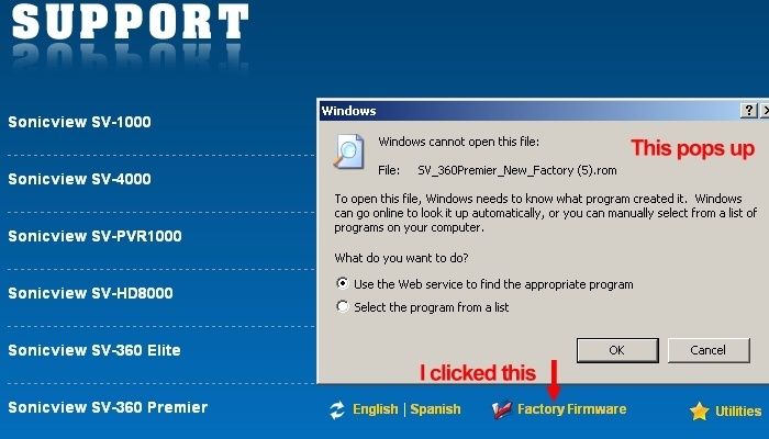

Thanks Iceberg, Yea I am trying to load the factory firmware but when I click the "Factory Firmware" it sais windows can not open the file.
Don't know what to do, I do not want to go looking for it on some unknown website and screw something up.
BTW, I tested the other files just to see if they open and they open just fine. Everyone except the 360 premier one. Go figure.
DirectDishNet,
Don't try to OPEN the file. If it needs to be unzipped or un-"rar"d do that, but don't open the file, just load it to the receiver.

Oh,...Sorry I said it wrong....I men't when I clicked the link it won't even load. It won't give me a rar or zip file.
DirectDish, I got the file and the downloader, if you need them. PM me with your email address and I can email them. The site worked with firefox.

That's alright, sorry if I my assumption was unfounded, didn't mean to make it appear that you were naive. I should have known better my friend. My mistake and my apologies as well.

I got the factory firmware to load just fine. Blind scanned my 97W and 101W.... Played with it most of the evening and could not find any bugs. The 360 works really good and the picture quality is very nice. The channels change pretty quick and seamless. The only thing wrong with this receiver is that the battery cover on the remote is broke.

Thanks everyone... I got it now. I guess my Google Chrome still is having issues. I went ahead and used Firefox and it went smooth.
