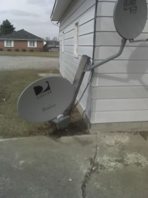

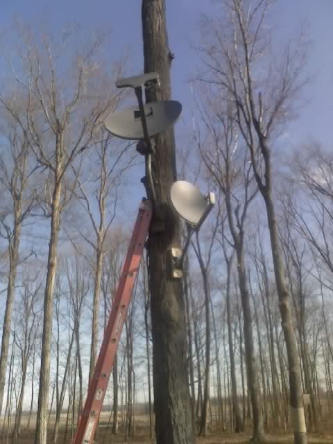

A double stacked lo-pro, with EL/AZ broke off for the middle tie-together, on an under eave mount with studs hit on one side only, no corner braces, and pointed right at trees during a winter install, service out at beginning of spring.
the other one is a LO,LO pro

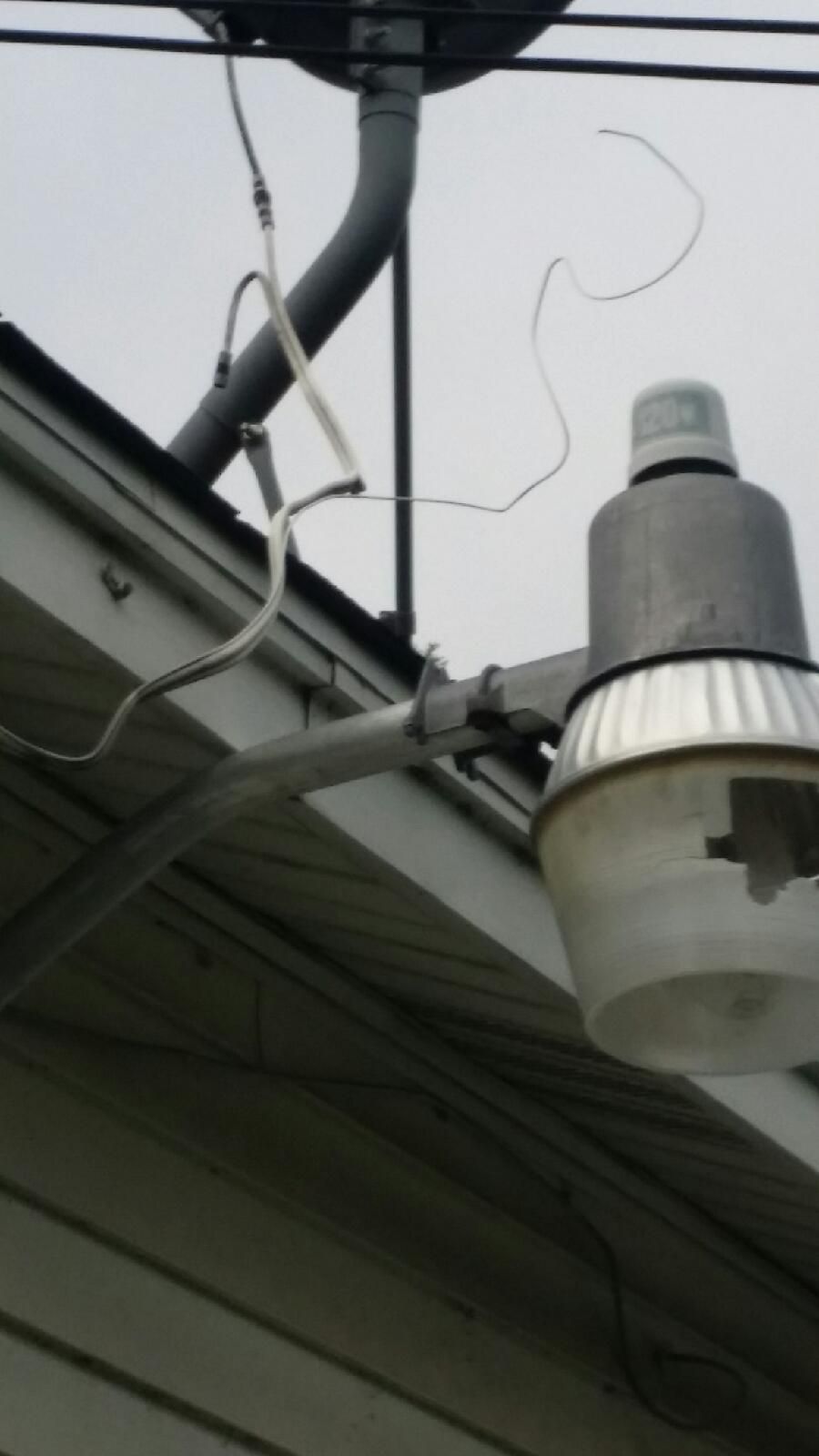

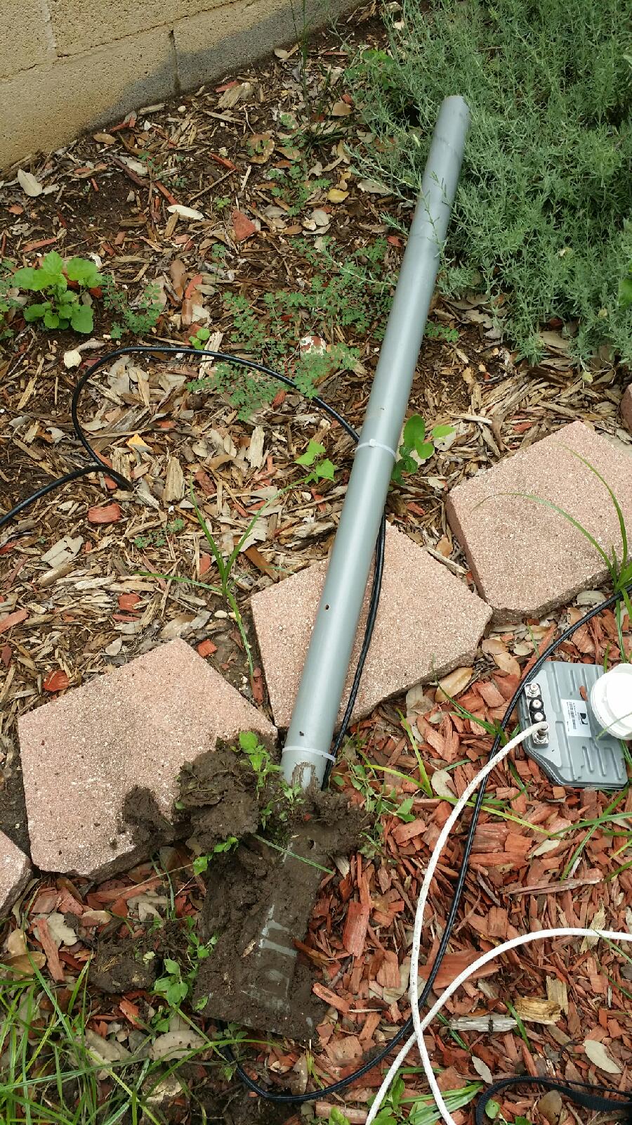

You mean like these?
Reactions: Tylorert
The "anchored" pole
the country pole

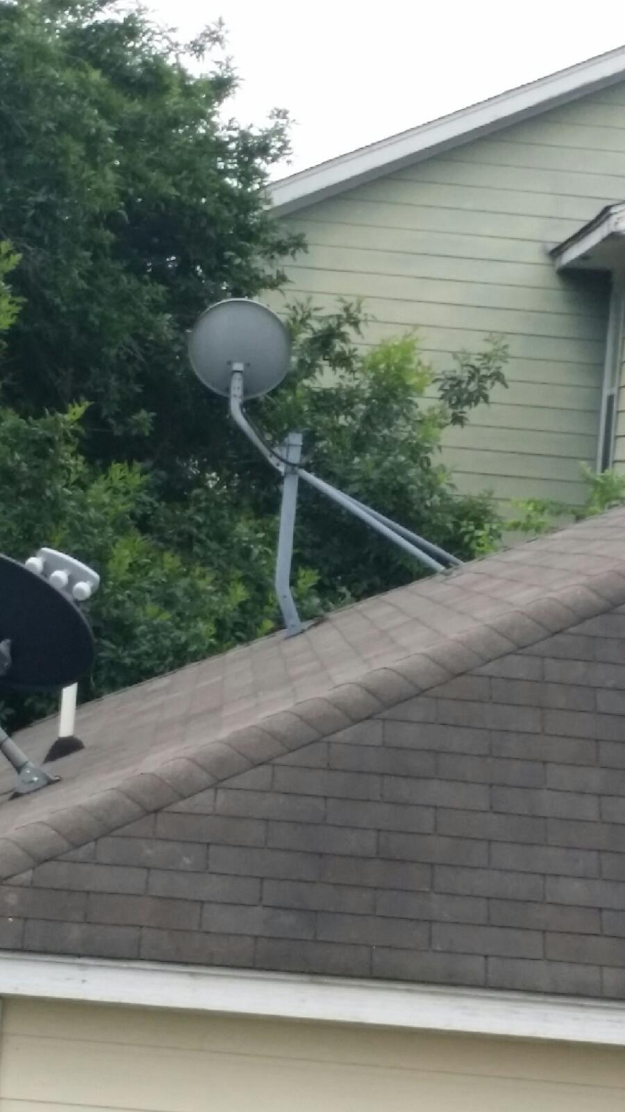

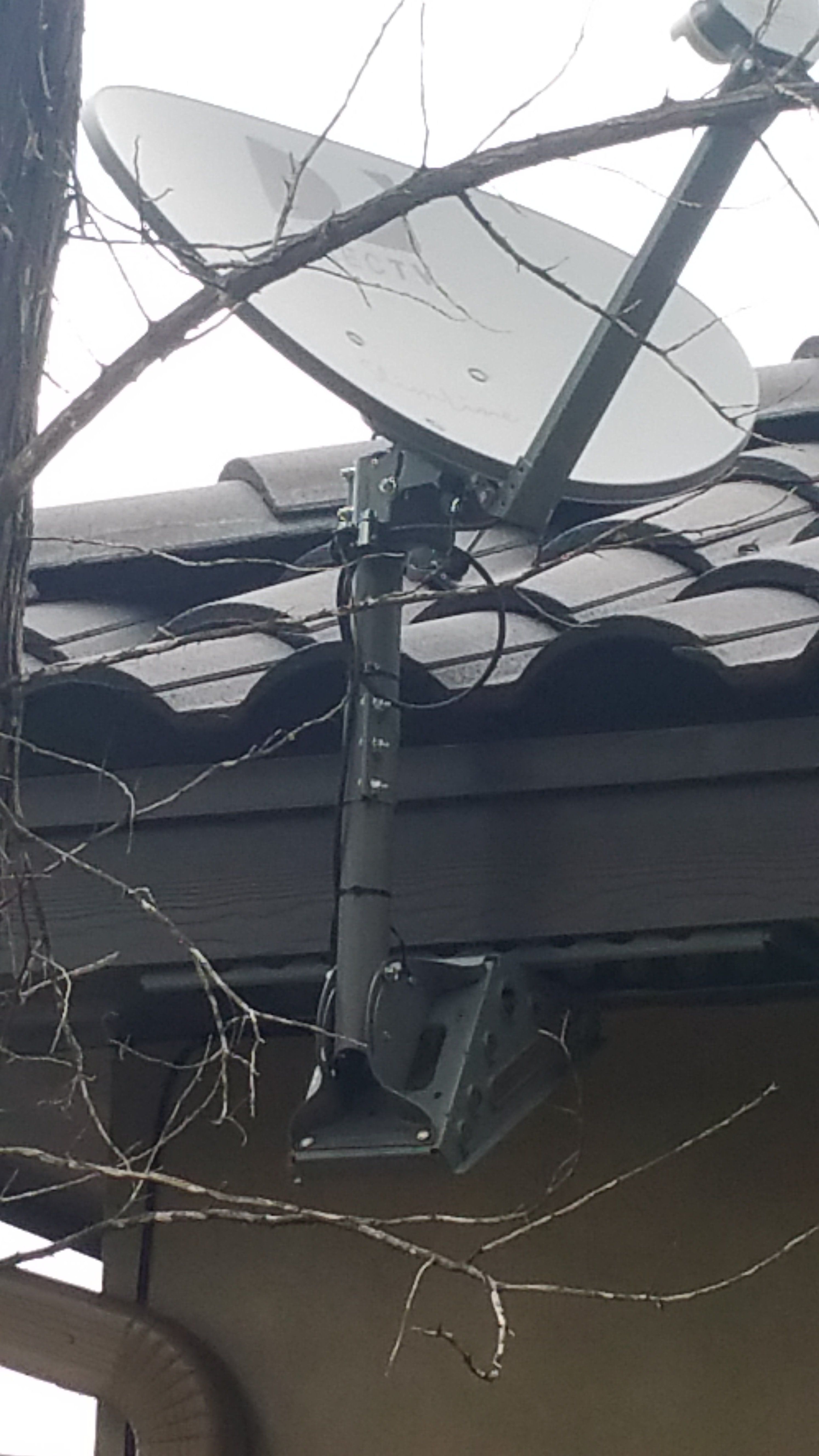

the line of sight boost
Lo,Lopro on a rail
one block non-pen
I could do this all day
