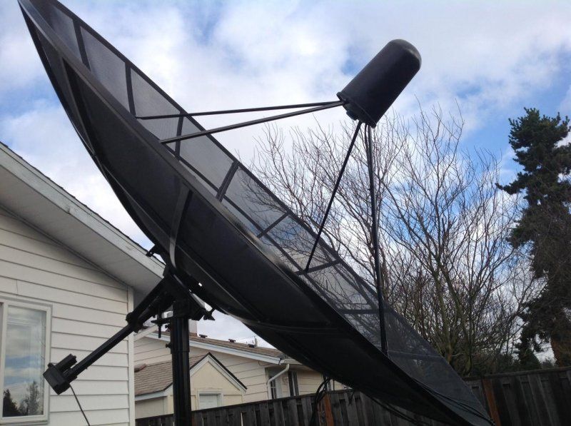

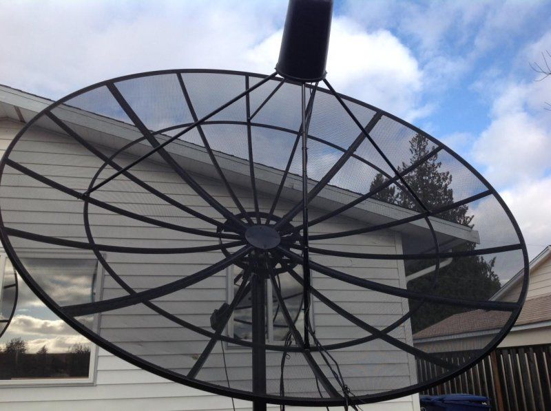

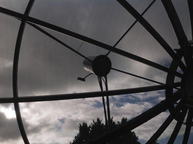

Hey WVman,
This is Eugene, again.
I thought of sending you my pictures of my BUD 1.
To show you the 4 legs I have.
Can you draw a line of "Quad" to imagine where it
would be???:(
I sent you 3 photos, each has different angle of the 4 legs.:)
By the way, you're also looking at TODAY'S weather, here in Seattle.
It's cloudy, but rained over night, and earlier this morning.
So, things are WET, now.
I don't trust the Meteorologist who said it's going to be sunny and part cloudy. :(
What do you think??? Hope that you and EVERYONE can see the photos.
Eugene
P.S. By the way, the photos you're looking at, the BUD 1
is facing at GO satellite. :) I mean, G18 C-band satellite, in
the photos. :)
Hey WVman,
would be???:(
Eugene
the photos. :)
View attachment 136508 View attachment 136509 View attachment 136510 View attachment 136508 View attachment 136509 View attachment 136510
