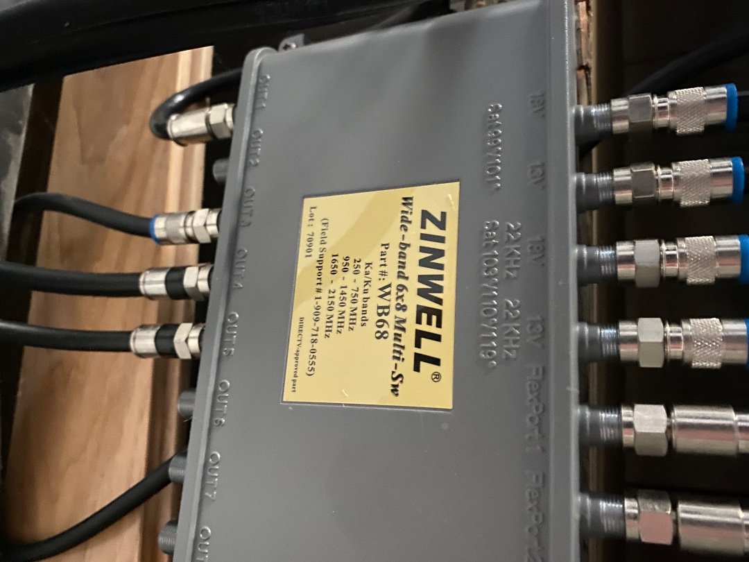

Is this compatible with the HR24?
That is a standard multiswitch for a DirecTV legacy LNB. You need two coaxes from that to your HR24, and apparently need to use B-Band convertors. I use that WB-68 multiswitch and a legacy LNB with my data monitoring system. I have been using SWM LNBs for DirecTV reception since I got my first HR-24 in 2010 to replace my old D10 SD receiver.. SWM is a much simpler system, but all your receivers must be SWM capable.
This is the WB68 that I spoke of above. It works just fine with the HR24. It provided outputs for eight tuners when attached to a LNB assembly that offered only four.
