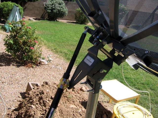

Standing behind the dish the actuator arm attaches to the left side of the dish. The 4DTV calls this linear East.
This is my old dish, but the new one is the same way:
Typically East of the Mississippi the actuator gets attached on the West side, and west of the Mississippi gets attached on the east.
